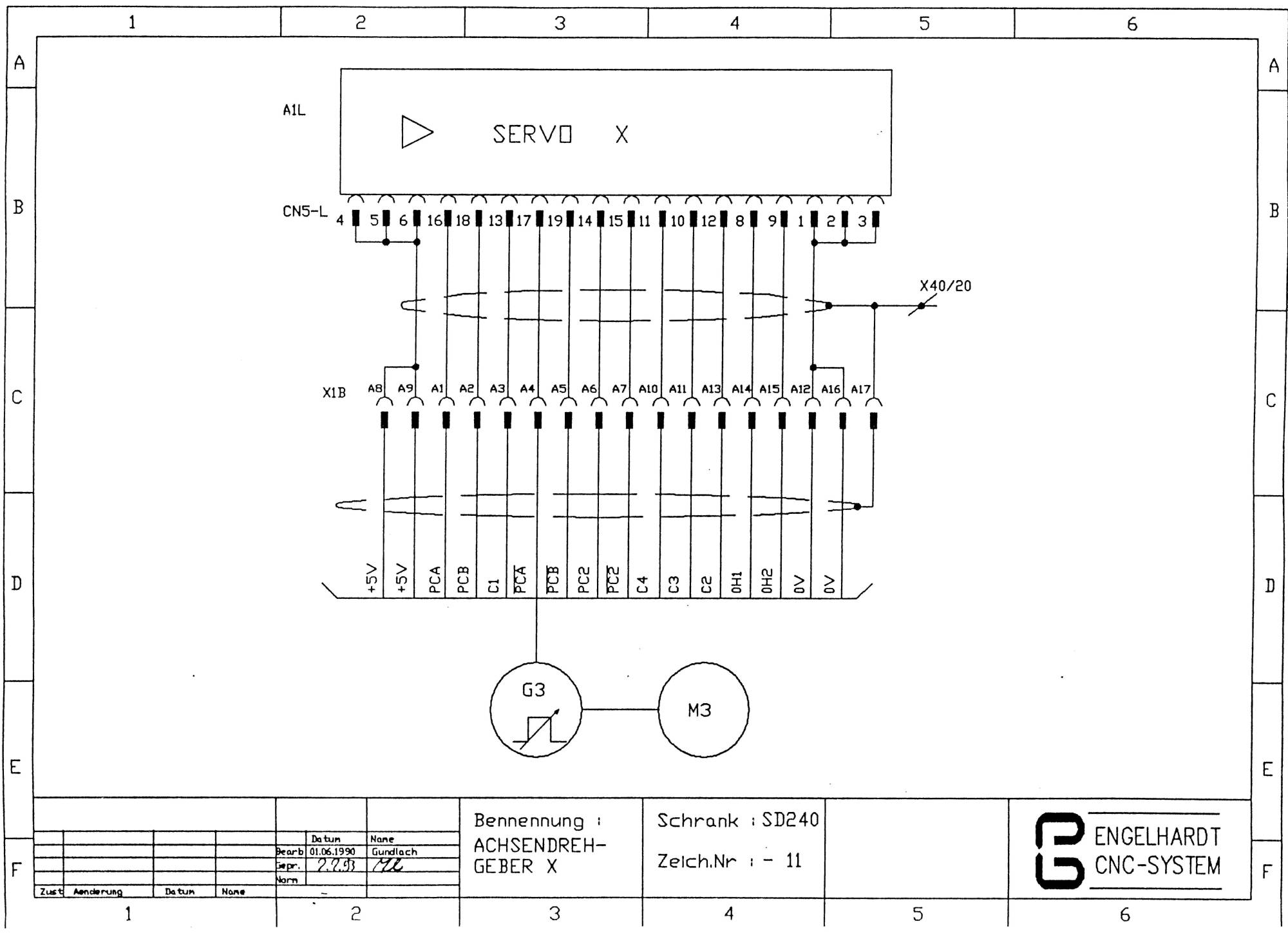

I´m using a Mesa 7i33 for the encoders and pwms. The encoders are Fanuc, so there is very little info to get on the specs of the encoders. All I know is they are TTL and 2000i/rev
All I have additionally is the schematics of the control where the encoder connection can be seen:
As it shows inverted channels I think they are differential types
And yes, the 7i33 is jumperd to TTL (Jumpers DOWN)

That brings up a couple questions?
1. if the encoders have differential outputs, why in the 7I33 jumpered for single-ended (TTL) inputs
2. Leaving the TTL option enabled, can you check that grounding the INDEX+ input (encoder disconnected)
changes the state of the hal index pin (hm2_7i80.0.encoder.00.input-index for X)
Answer: because I was told so - I am really not ecperienced in these things and asked how to get the motors working and showed the schematics to experienced guys- and I was told how to wire the encoders and how to jumper the 7i33.2. Leaving the TTL option enabled, can you check that grounding the INDEX+ input (encoder disconnected)
...ok, I will check this with disconnected encoder and report.
No it does not change in HAL-Show, it stays high (yellow) even if I short ENCX0 with GND (PIN on the 7i33)
And Sorry, I mixed it up- the jumpers W1-W4 are set to UP position so TTL/RS-422 sorry!

OK that indicates either a problem with the 7I33, the connecting cable, the FPGA card
or the firmware.
Note that this test will only work if the 7I33 is jumpered for TTL encoder mode.
or the firmware.

Ok, hope I understood correctly- I disconnected the X-encoder, set the jumper W4 DOWN to TTL and shorted the pins ENCX0 and GND of the X-encoder.
The status in HAL-Show for the hm2_7i80.0.encoder.00.input-index for X did not change, stayed high (yellow).
(I have set the jumper W4 back to UP before reconnecting the X-encoder)
