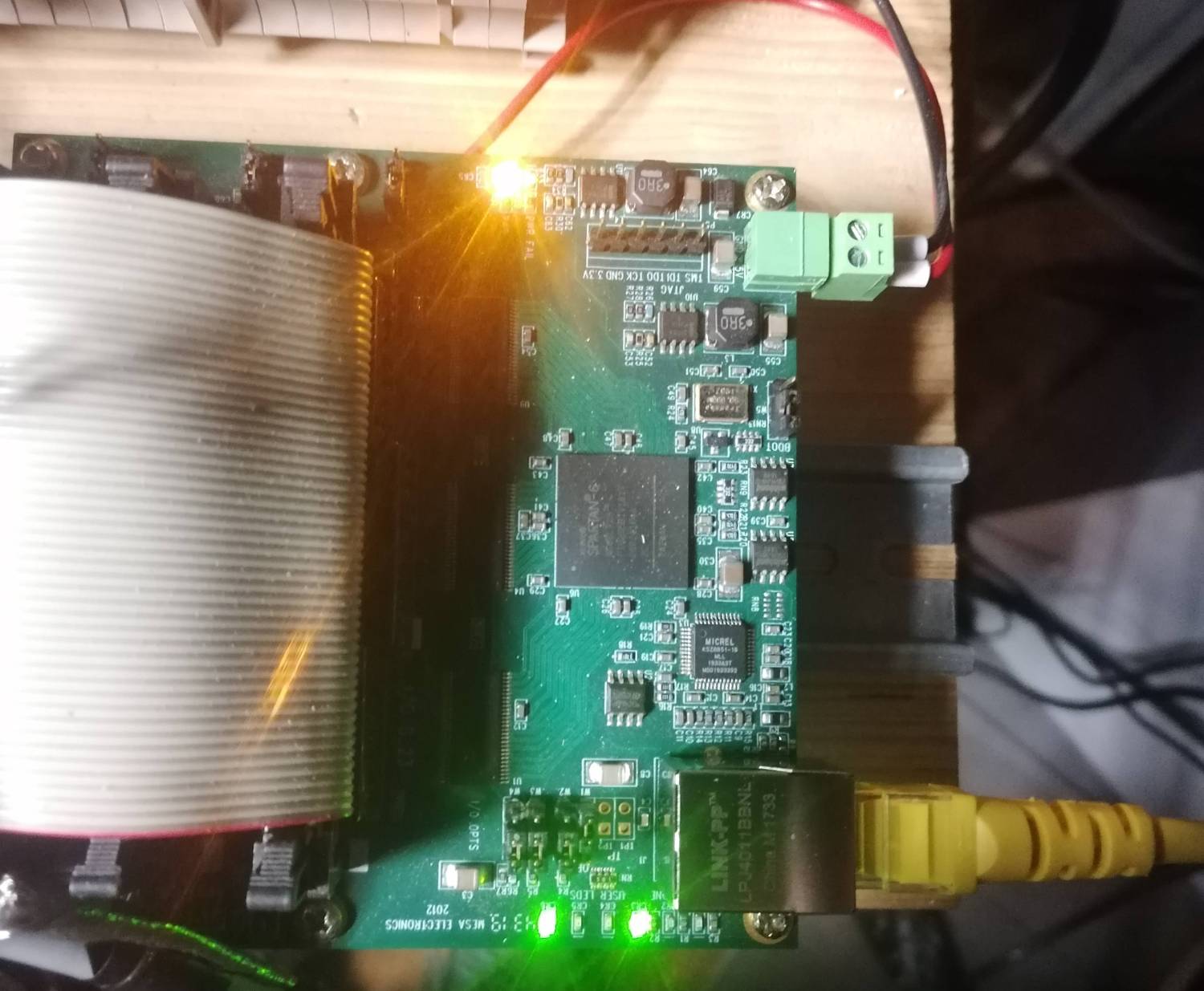

The card is a 7i80HD-25 with the 7i80hd_25_sv12.bit on it, addr 10.10.10.10
I am sorry if my answers don´t get in in time, but the forum cuts out frequently so I do not always have access.

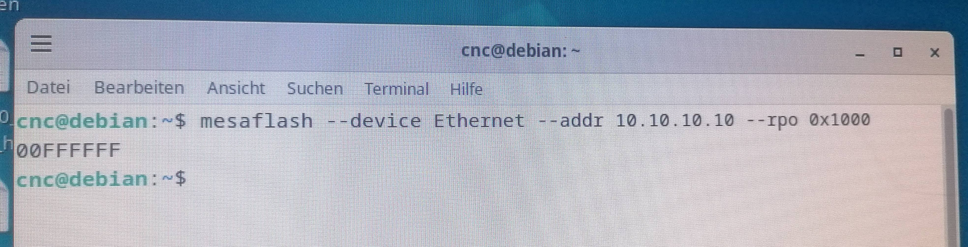

OK next is to test the FPGA interface
Can you power down the system, unplug the flat cable from the 7I33
power up and without launching LinuxCNC, a report the results of this
command:
mesaflash --device Ethernet --addr [your_cards_IP_address] --rpo 0x1000
[your_cards_IP_address] is likely 10.10.10.10 or 192.168.1.121
command:

08 Sep 2025 20:41 #334652
Replied by PCW on topic Troubles to get started with SD240 Retrofit
OK So it looks like the FPGA card is OK.
This leaves the 7I33 and the cable
Do the other index inputs work?

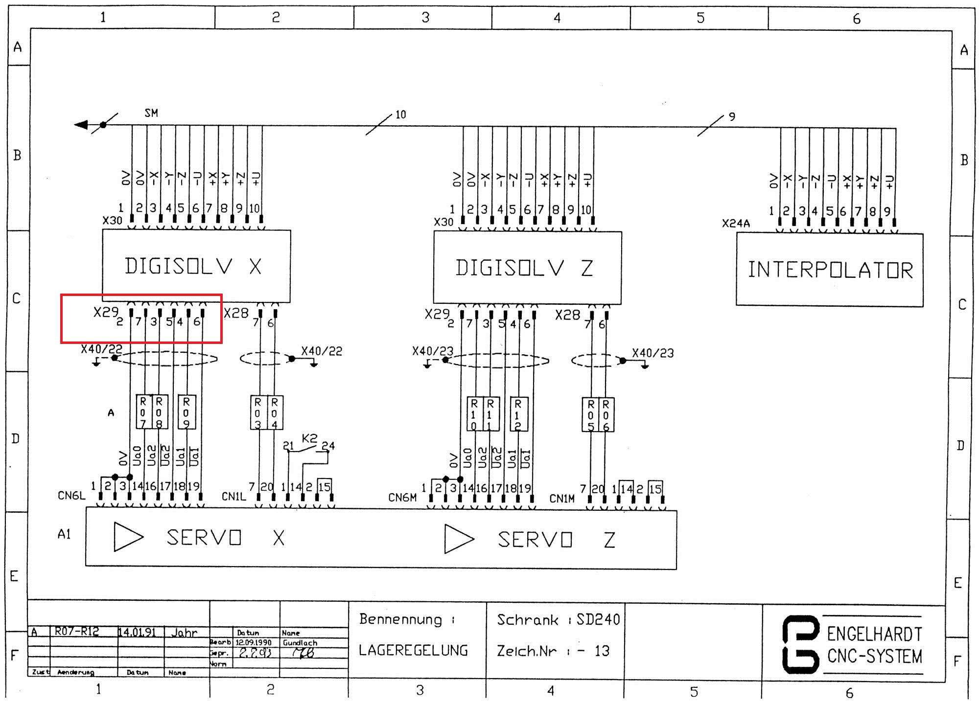

Replied by ziggi on topic Troubles to get started with SD240 Retrofit
No, I also watched the Z- Index and spindle index (not as brief as X) but watched the pins in HAL-Show and they do not change either.
Thats why I thought I made a mistake in the HAL.
The 7i33: otherwise the motors rum smooth as the spindle does and are perfectly controllable (motor and spindle)
The encoder cable- most likely- I will check this asap.
Interesting is that the encoders have Ua1 and Ua2 both also inverted, but the Index Ua0 not (also spindle encoder)

08 Sep 2025 22:38 #334657
Ahh, looks like the index is single ended, maybe that's the issue.
Unfortunately the 7I33, each encoder input is all differential or all single ended
So one thing to try would be to select single ended instead of differential
encoder mode one the 7I33. This is not ideal as it less resistant to noise
but may be OK.
If setting the 7I33 to single ended encode mode works, there is also
the possibility of using custom firmware that puts all the index inputs
on one 7I33 encoder connector so you could have differential for A,B
but TTL mode for the Index signals.
Another possibility is to add a TTL to differential converter for the index signals
Mesa has such a thing, but its really just 1 chip on a board
(26ls31 or one of the many equivalents)

09 Sep 2025 20:42 - 09 Sep 2025 20:49 #334731
by ziggi
So I set the jumpers on the 7i33 for X- and Z-axis to TTL (DOWN) and entered the USE INDEX- YES in the INI. Both axes behave normal and I think they home with using the index now.
Sequence:
Homing movement
Home switch trips- "home sw. X" gets yellow, "enable index" lights up yellow and the axis moves forward a bit further.Then the "hm2_7i80.0.encoder.00.input-index" flashes yellow very short, the axis frees the home switch and moves on to home-pos, stops and "x-axis homed" lights up yellow and the DRO says 0/0.
Z homes the same way.
I think thats exactly what I wanted to achieve- correct?
The spindle I guess can be indexed also, otherwise threading would be impossible...but the spindle likely just needs the index, A/B will not be necessary on a lathe- or am I wrong?
Well lets see how the next step can be solved.
The important hint was that the 7i33 just can process ALL inputs as TTL or ALL inputs as differential!
Thank you all so much
Sigi
