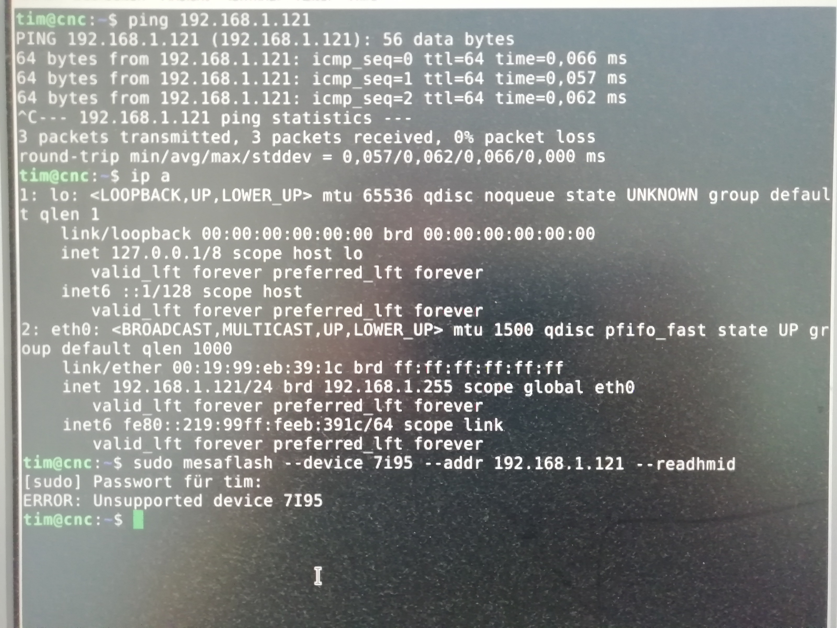

09 Oct 2021 13:21 #222637

- Posts: 18105
- Thank you received: 5328
09 Oct 2021 13:35 - 09 Oct 2021 13:37 #222638
Replied by PCW on topic Mesa 7i95
You have your PC's IP address set to the 7I95s address so the ping
response is coming from your PC. The host PC IP address
has to be different but in the same subnet, say 192.168.1.100.
Also you don't need sudo for Ethernet cards.
Last edit: 09 Oct 2021 13:37 by PCW.
- mittim
- Posts: 92
09 Oct 2021 14:02 - 09 Oct 2021 14:15 #222640
by mittim
Replied by mittim on topic Mesa 7i95
My card is also not being recognized in the top right corner. Maybe my network manager is the problem? I am missing a wired connection 1.
Last edit: 09 Oct 2021 14:15 by mittim.
