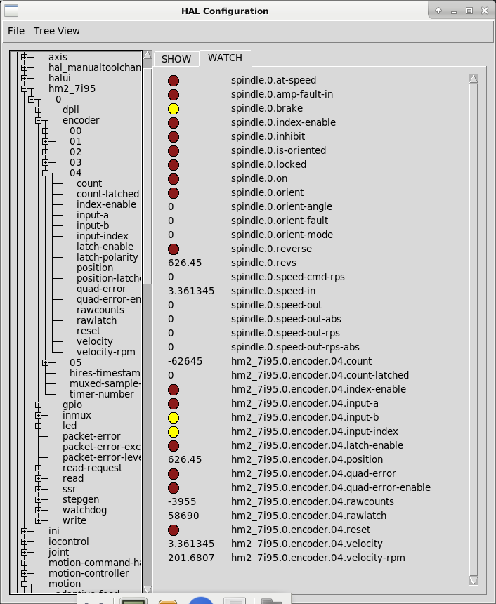

06 Nov 2020 20:11 #188537
by Gnevko
Replied by Gnevko on topic Mesa 7i95
Hi!
I think I will need again your help
I'm trying to following this description (linuxcnc.org/docs/devel/html/examples/spindle.html) and configure my spindle encoder for the lathe cnc. But without big success. Es you can see, the spindle component receives the the signals, but in the GUI nothing (probe basic lathe) happens and the spindle speed is still 0. The spindle itself is not connected to Linuxcnc (no possibility) and should be turn on manually.
Configuration In the hal file:
Full config folder:
Thank you in advance!
# --- spindle encoder ---
setp hm2_7i95.0.encoder.04.scale -100
setp hm2_7i95.0.encoder.04.counter-mode true
net spindle-position hm2_7i95.0.encoder.04.position => spindle.0.revs
net spindle-velocity hm2_7i95.0.encoder.04.velocity => spindle.0.speed-in
net spindle-index-enable hm2_7i95.0.encoder.04.index-enable <=> spindle.0.index-enable
loadrt near
addf near.0 servo-thread
net spindle-cmd => near.0.in1
net spindle-velocity => near.0.in2
net spindle-at-speed spindle.0.at-speed <= near.0.out
setp near.0.scale 1.01Full config folder:
- Gnevko
- Posts: 59
- Thank you received: 10

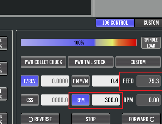

07 Nov 2020 19:05 #188605
by Gnevko
Hm ... what is interesting, it seams to work, but it's something wrong with the display of current spindle speed.
The commands
works correctly, the lathe syncs Z axis speed with real spindle speed (S300 or S1 - it in this case doesn't matter at all)
The RPM Speed in GUI is still 0.0
But I think it's the problem of Probe Basic Lathe itself....
The commands
G95
S300
G01 F0.4 Z50works correctly, the lathe syncs Z axis speed with real spindle speed (S300 or S1 - it in this case doesn't matter at all)

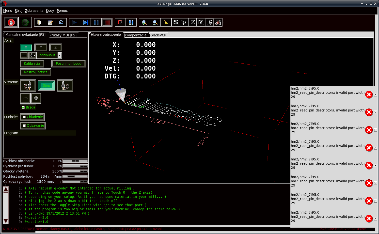

09 Nov 2020 11:49 #188733
by jurod
Replied by jurod on topic Mesa 7i95
Hi, please help.
I have 7i95 card. Using PNCCONF I created a 7i96 configuration. In .ini i transcribed "CARD0=hm2_7i95.0"
At startup i have this: (foto) and card no works.
From Terminal:
My flash:
My Linuxcnc is 2.8.0 on Buster .
Card 7i76E is working normally.
Please help.

hm2/hm2_7i95.0: hm2_read_pin_descriptors: invalid port width 29
task: main loop took 5.017579 seconds
task: main loop took 5.009405 seconds
task: main loop took 5.344838 seconds
task: main loop took 5.015675 seconds
TCL error in asynchronous code:
unknown option "-state"
while executing
"$w configure -state disabled "
(procedure "disable_group" line 1)
invoked from within
"disable_group $::manualgroup"
(procedure "update_state" line 52)
invoked from within
"update_state"
("after" script)
task: main loop took 5.010379 seconds
task: main loop took 5.010883 seconds
task: main loop took 5.019939 seconds
while executing
invoked from within
invoked from within
"update_state"
("after" script)
while executing
invoked from within
invoked from within
"update_state"
("after" script)
while executing
invoked from within
invoked from within
"update_state"
("after" script)
task: main loop took 0.346344 seconds
while executing
invoked from within
invoked from within
"update_state"
("after" script)
^Ctask: 13528 cycles, min=0.000049, max=5.344838, avg=0.012690, 8 latency excursions (> 10x expected cycle time of 0.010000s)
File "/usr/bin/axis", line 4320, in <module>
o.mainloop()
File "/usr/lib/python2.7/lib-tk/Tkinter.py", line 1138, in mainloop
self.tk.mainloop(n)
File "/usr/lib/python2.7/lib-tk/Tkinter.py", line 1545, in __call__
def __call__(self, *args):My flash:
hcnc@9010MT:~$ mesaflash --device 7i95 --write /home/hcnc/hostmot2/7i95_7i76iod.bit
(from this forum)My Linuxcnc is 2.8.0 on Buster .
Please help.
- Posts: 21985
- Thank you received: 7485
09 Nov 2020 12:08 #188734
Replied by tommylight on topic Mesa 7i95
Not sure but i think you need the master version of LinuxCNC for 7i95
- jurod
- Posts: 68
- Thank you received: 6
09 Nov 2020 12:16 #188735
by jurod
master version? What is it?
- bevins
- Posts: 1947
- Thank you received: 338
09 Nov 2020 12:26 #188736
by bevins
2.9 development version
Replied by bevins on topic Mesa 7i95
- Gnevko
- Posts: 59
09 Nov 2020 13:08 #188741
by Gnevko
Hi, you need (as me too) , 2.9 version of LinuxCnc
- Posts: 21985
09 Nov 2020 14:08 #188748
- jurod
- Posts: 68
09 Nov 2020 15:15 #188756
by jurod
OK. I installing already on the 2.9.0
