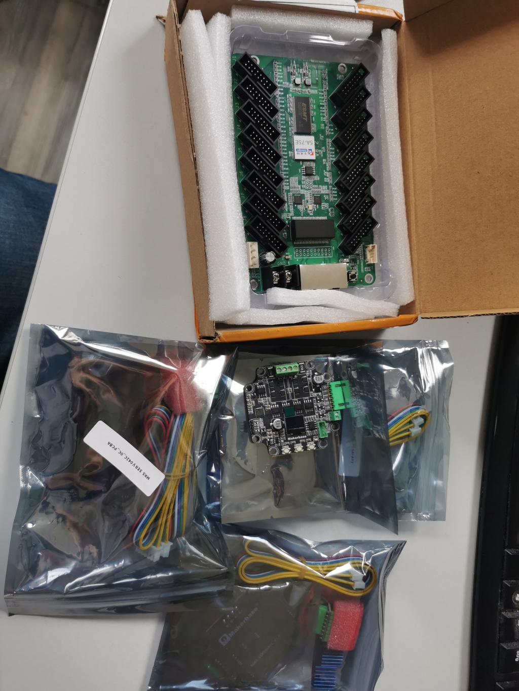

I really like this project.
Today the second 5A-75B-V8.0 will arrive. Can´t wait to flash it with LiteX.
And when I get the workflow for the modules finally, things will become even more exciting
