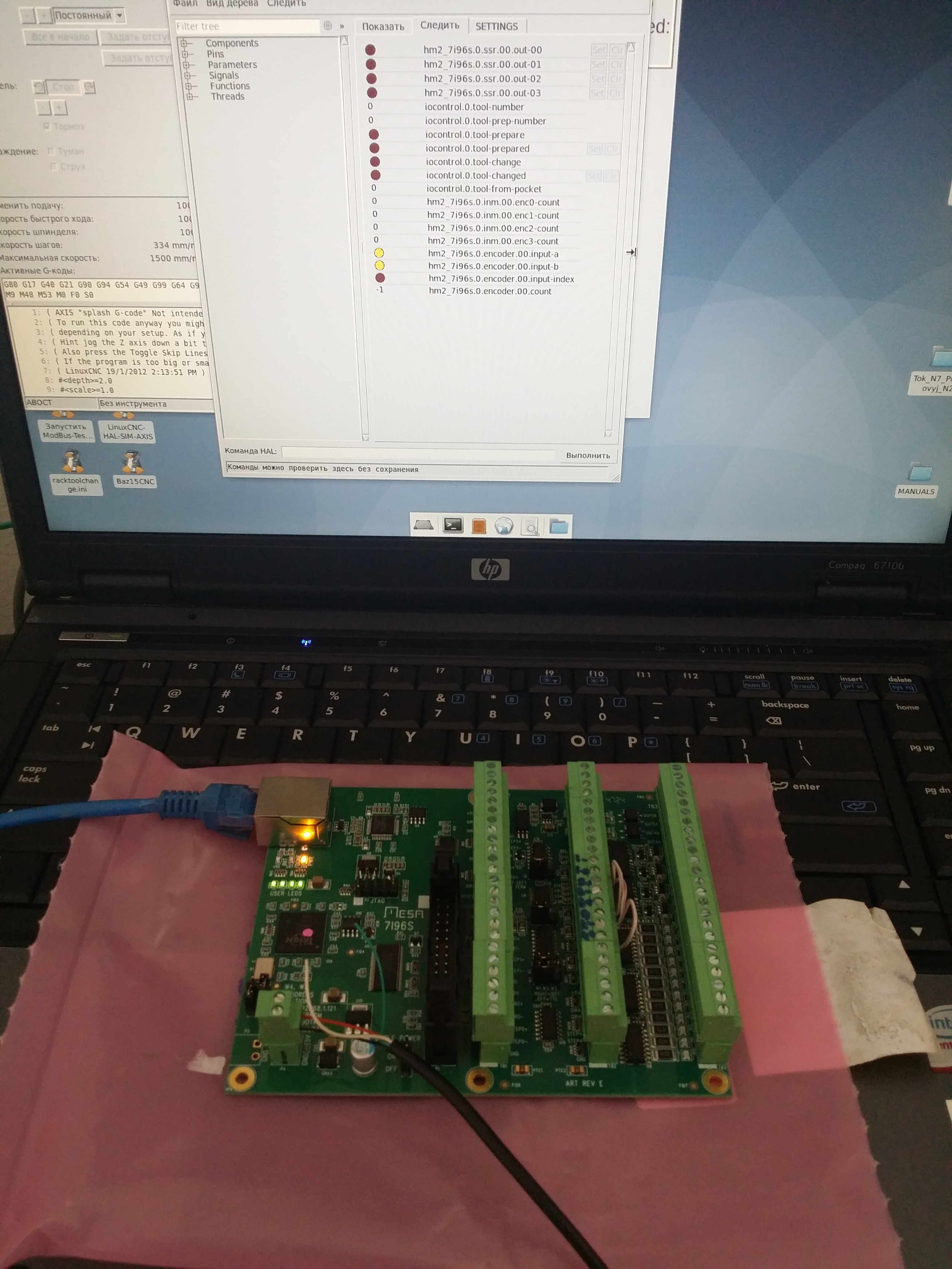

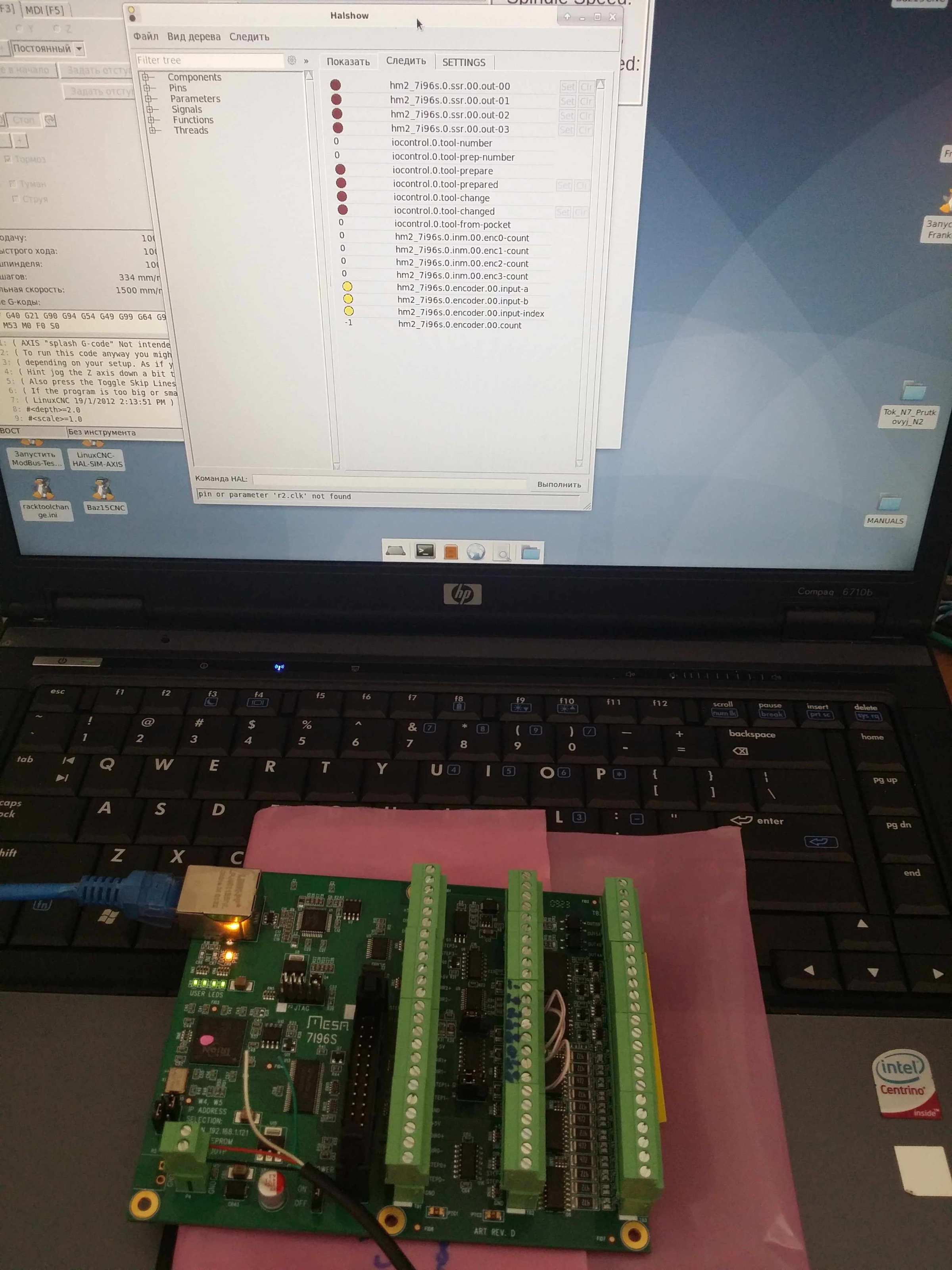

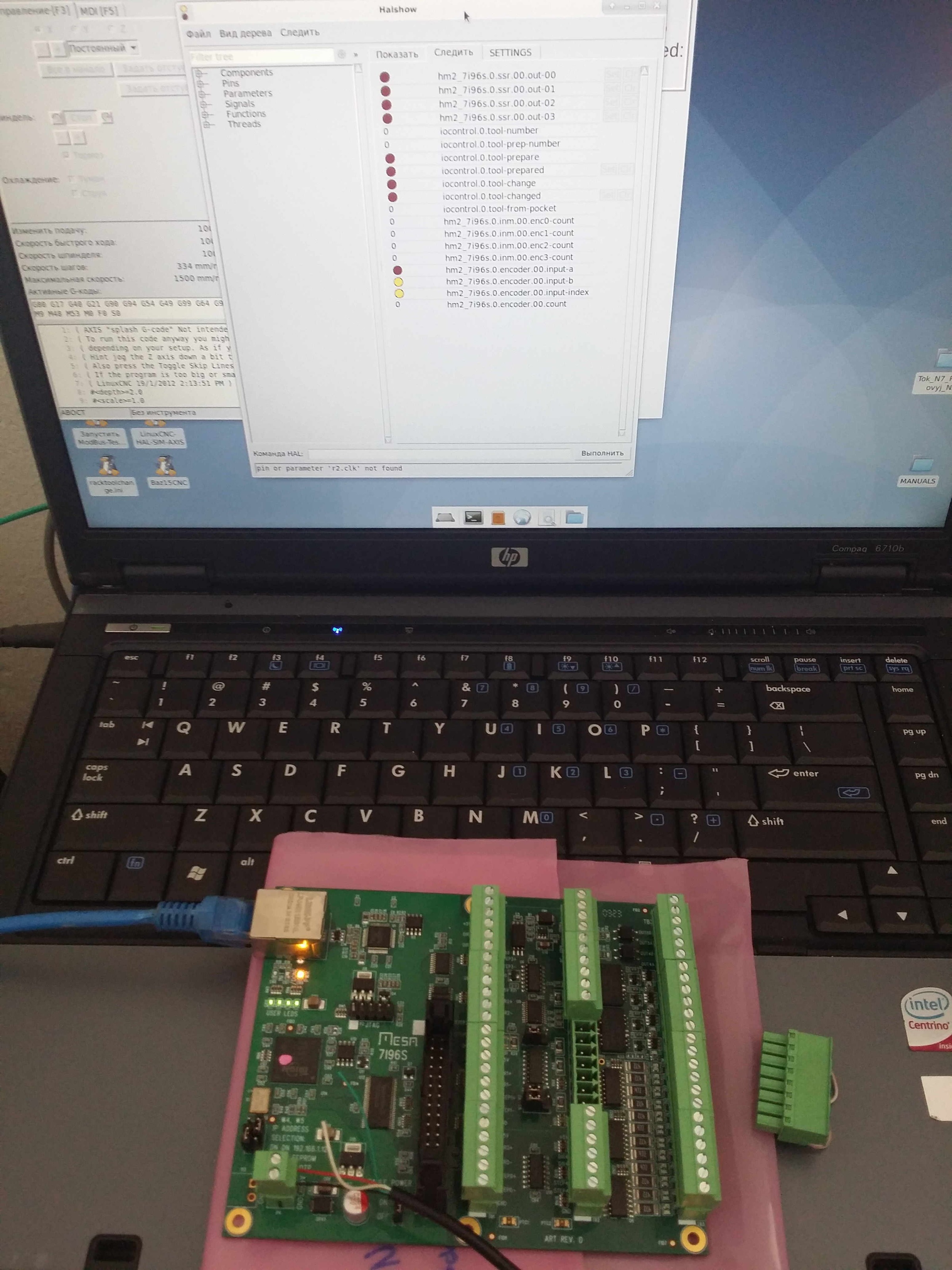

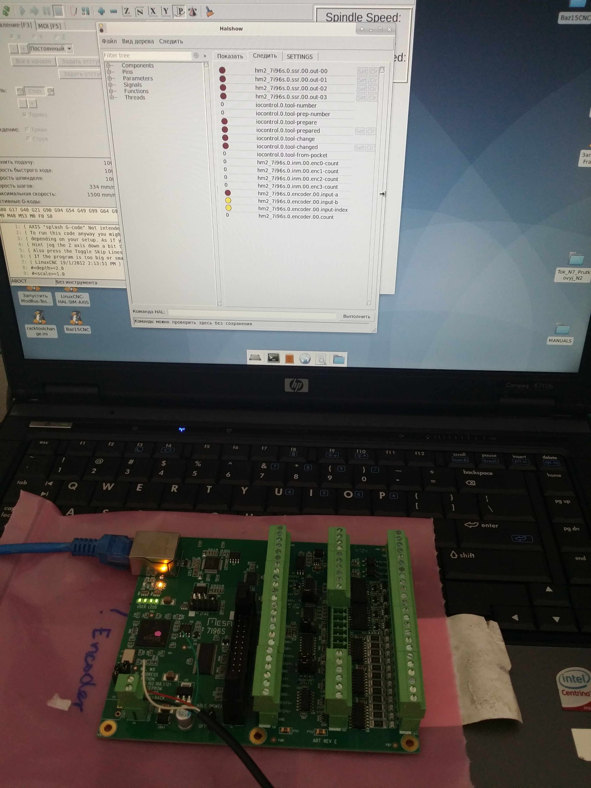

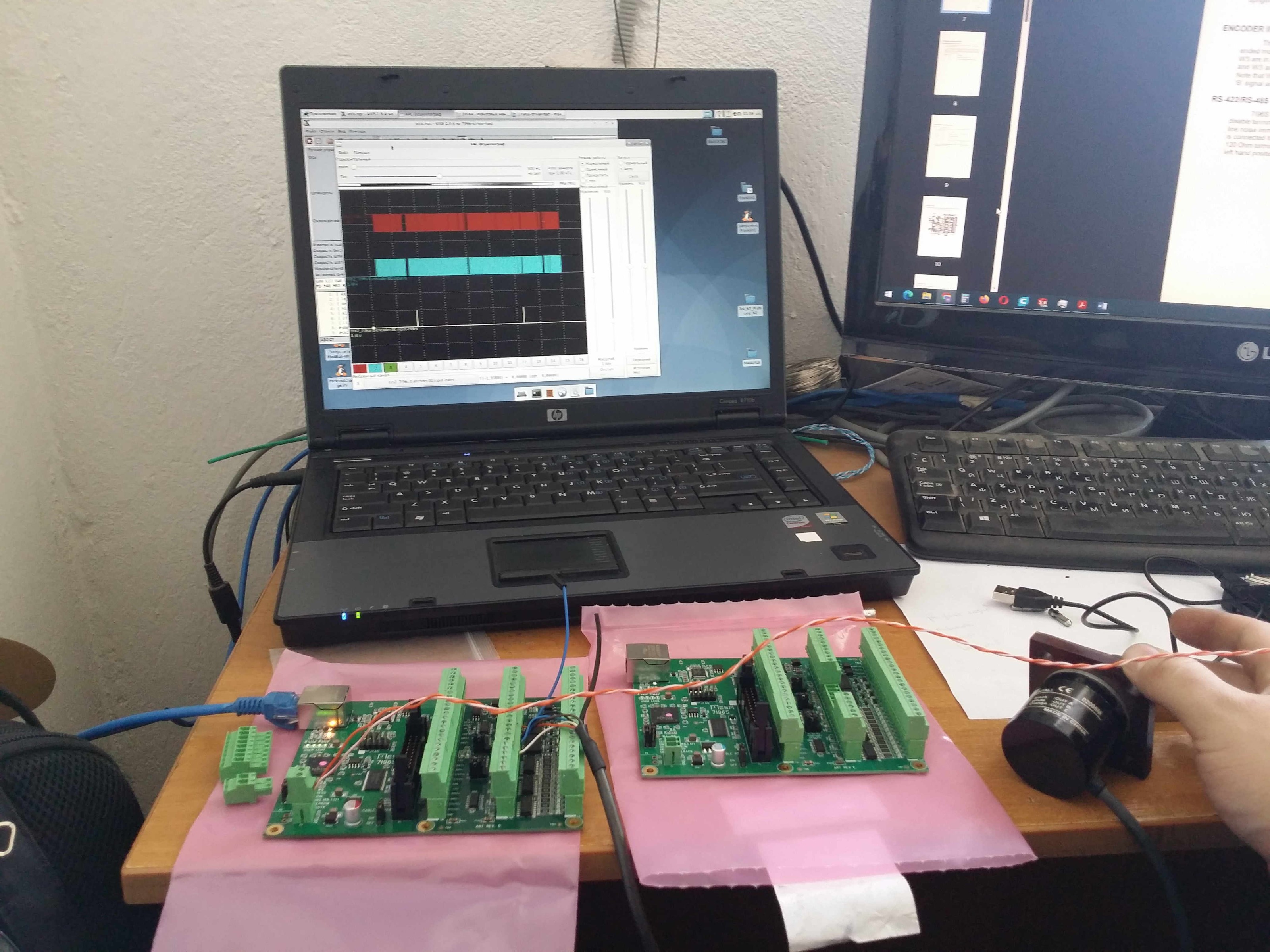

27 Apr 2026 12:14 #345981
by xenon-alien
Replied by xenon-alien on topic 7i96S card arrived what setup is recomended
Hello.

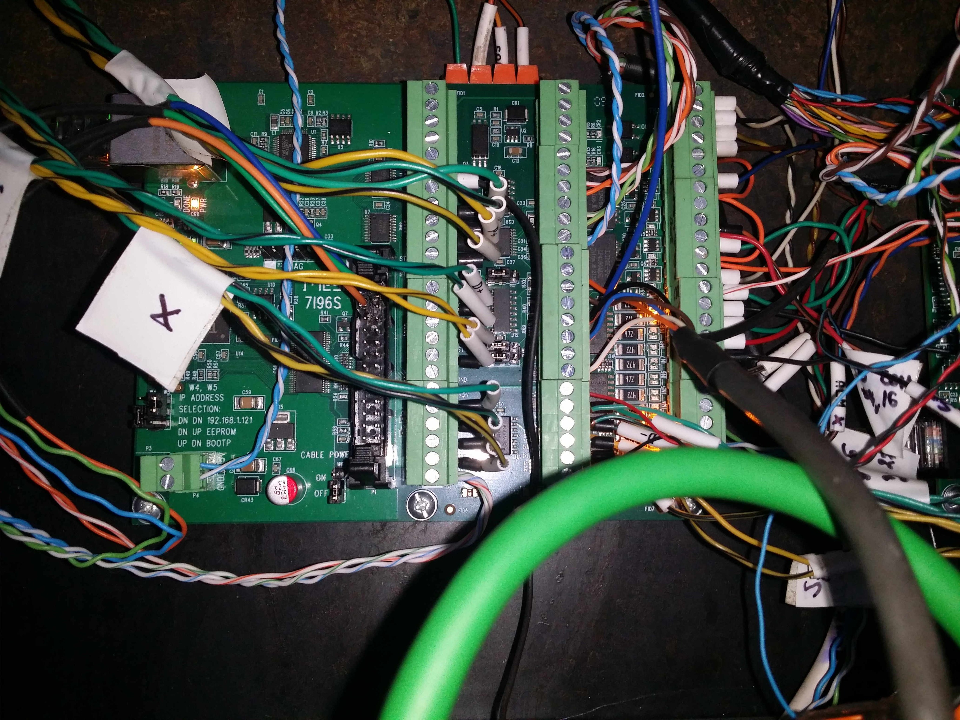

One 7i96s card on a lathe lost the encoder signal (it cames from a spindle driver on a differential line - as on 4th page ).

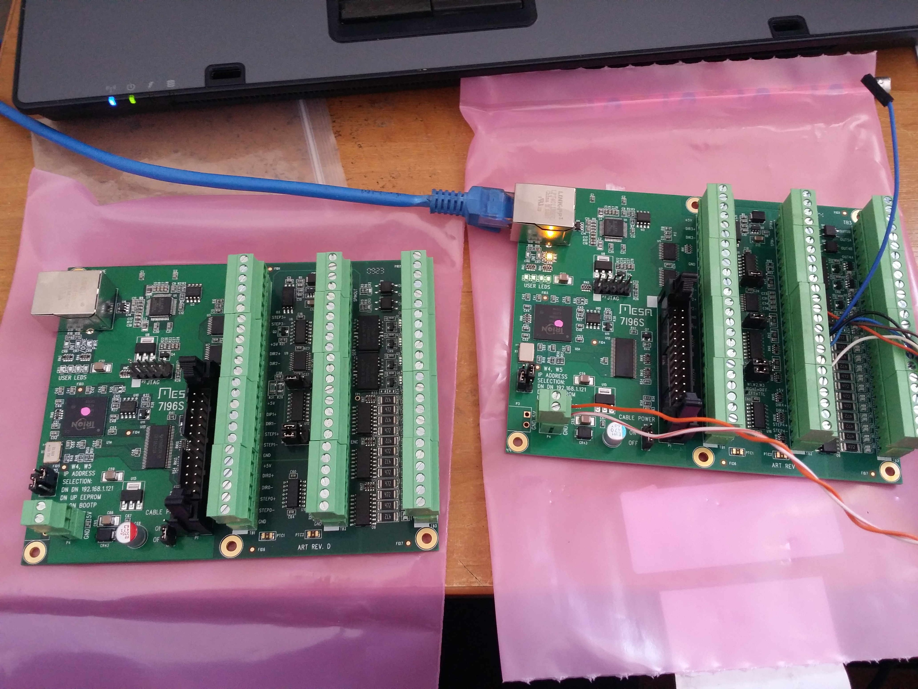

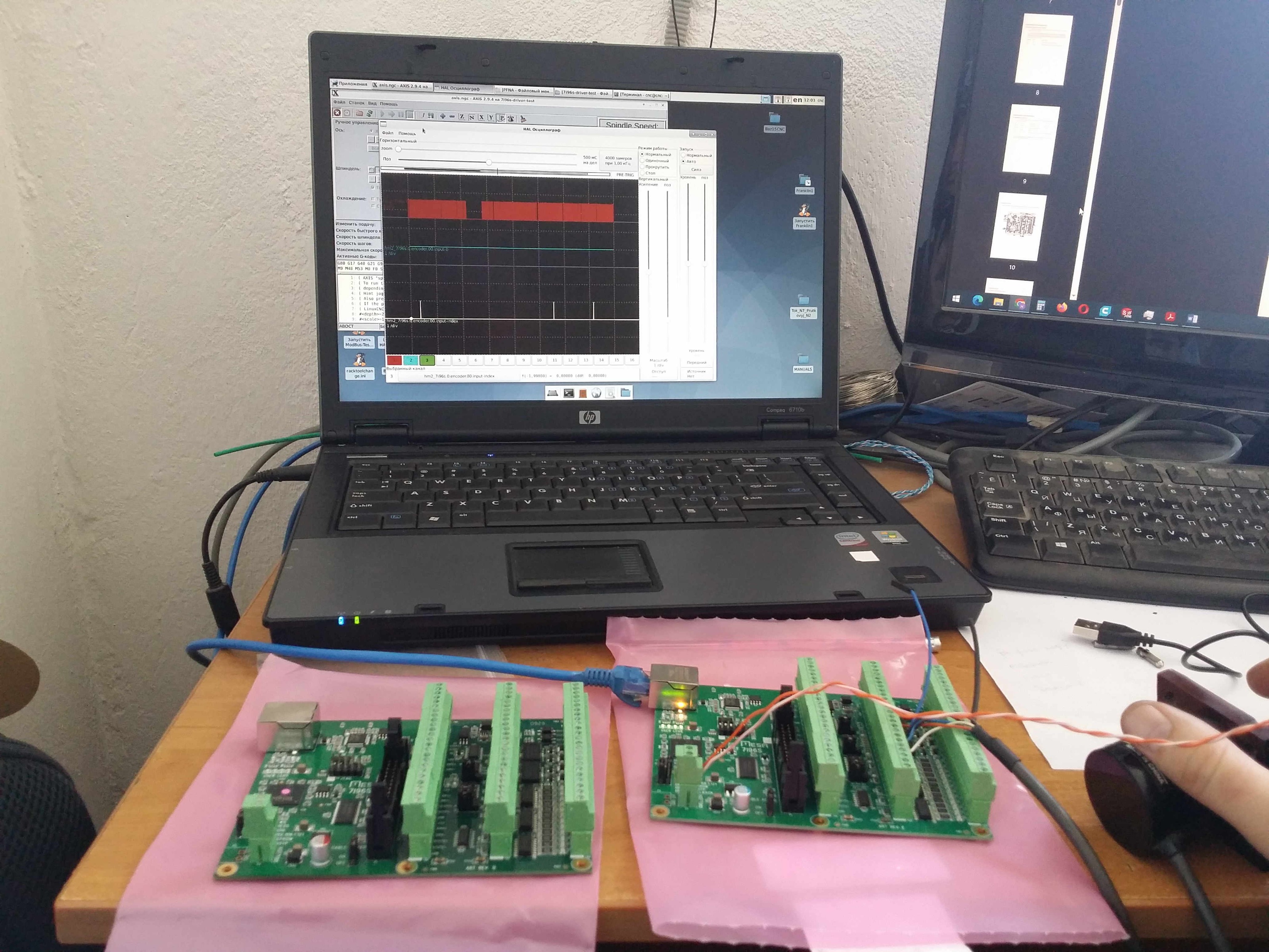

An other 7i96s card ("from the box") has the same issue with the encoder and has the new W7 jumper for RS-485 - not used yet, just powered on)
I have connected a TTL encoder for test - that is why the jumpers on left hand.
On the table one card works, so i replaced it. But now i have a used (± a year) card, and a new one with no encoder input. We using them for lathe, so we need the encoder input for threading.
Can it be solved somehow? Re-soldering a component?

27 Apr 2026 13:40 - 27 Apr 2026 13:41 #345986
Replied by PCW on topic 7i96S card arrived what setup is recomended
I would first, disconnect the encoder, jumper the encoder inputs for TTL mode
and then test the A,B and Index inputs by grounding the A+, B+ and INDEX+ pins
and watching the hal pins for these in halshow. They should change polarity when
grounded vs open.
The 7I96/7I96S encoder inputs are normally fairly rugged but can be damaged by EMI spikes
of greater than 25V. This can happen in a test setup where VFDs or spindle motors couple
the 400V or so square wave drive power into the encoder signals because of insufficient
grounding/shielding.
The Encoder input chip on a 7I96S is a 26LS32 (U12)
grounded vs open.
Last edit: 27 Apr 2026 13:41 by PCW. Reason: clarify
The following user(s) said Thank You: tommylight, xenon-alien

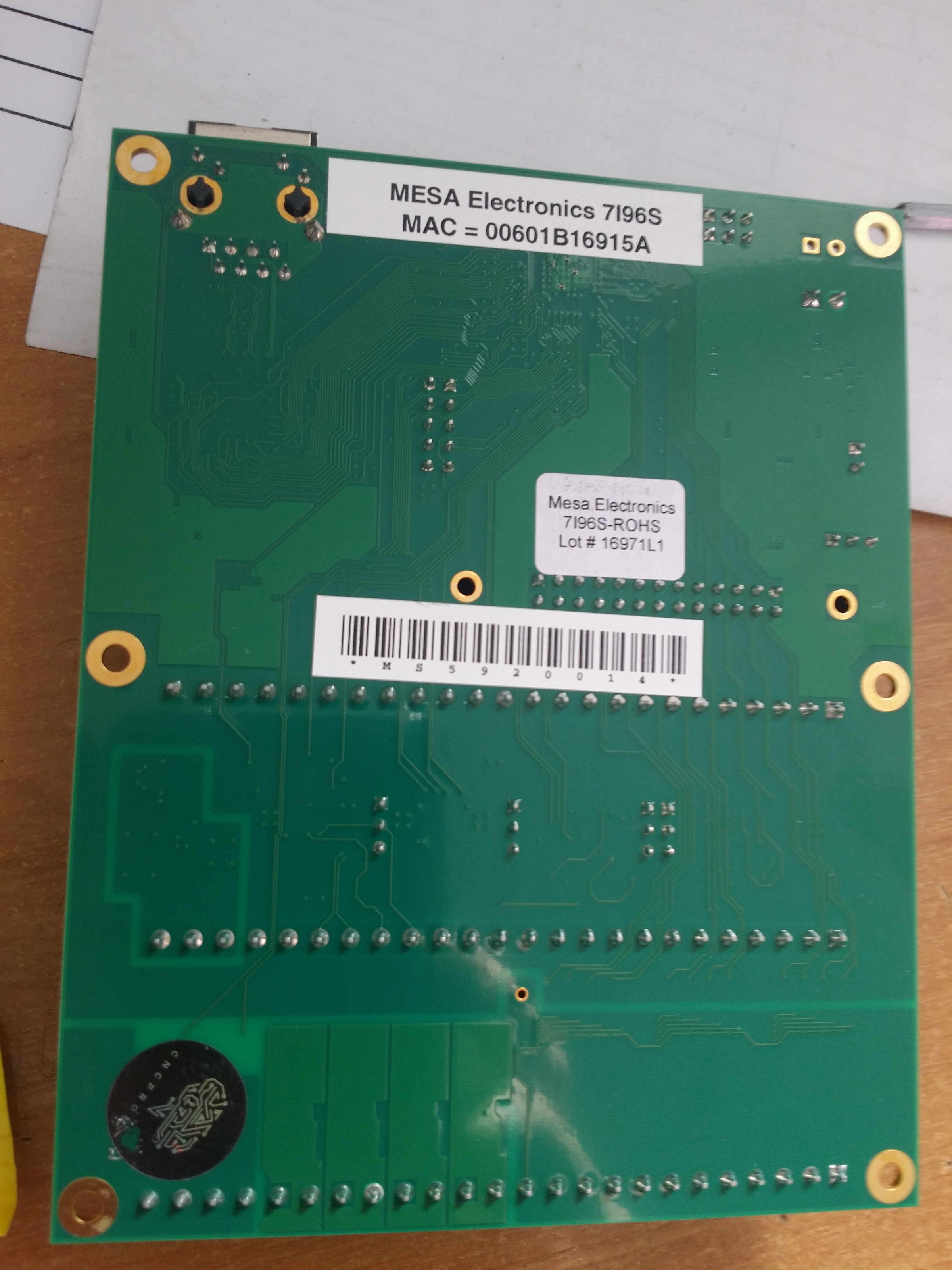

- xenon-alien
- Posts: 157
- Thank you received: 4
28 Apr 2026 07:58 - 28 Apr 2026 08:14 #345997
by xenon-alien

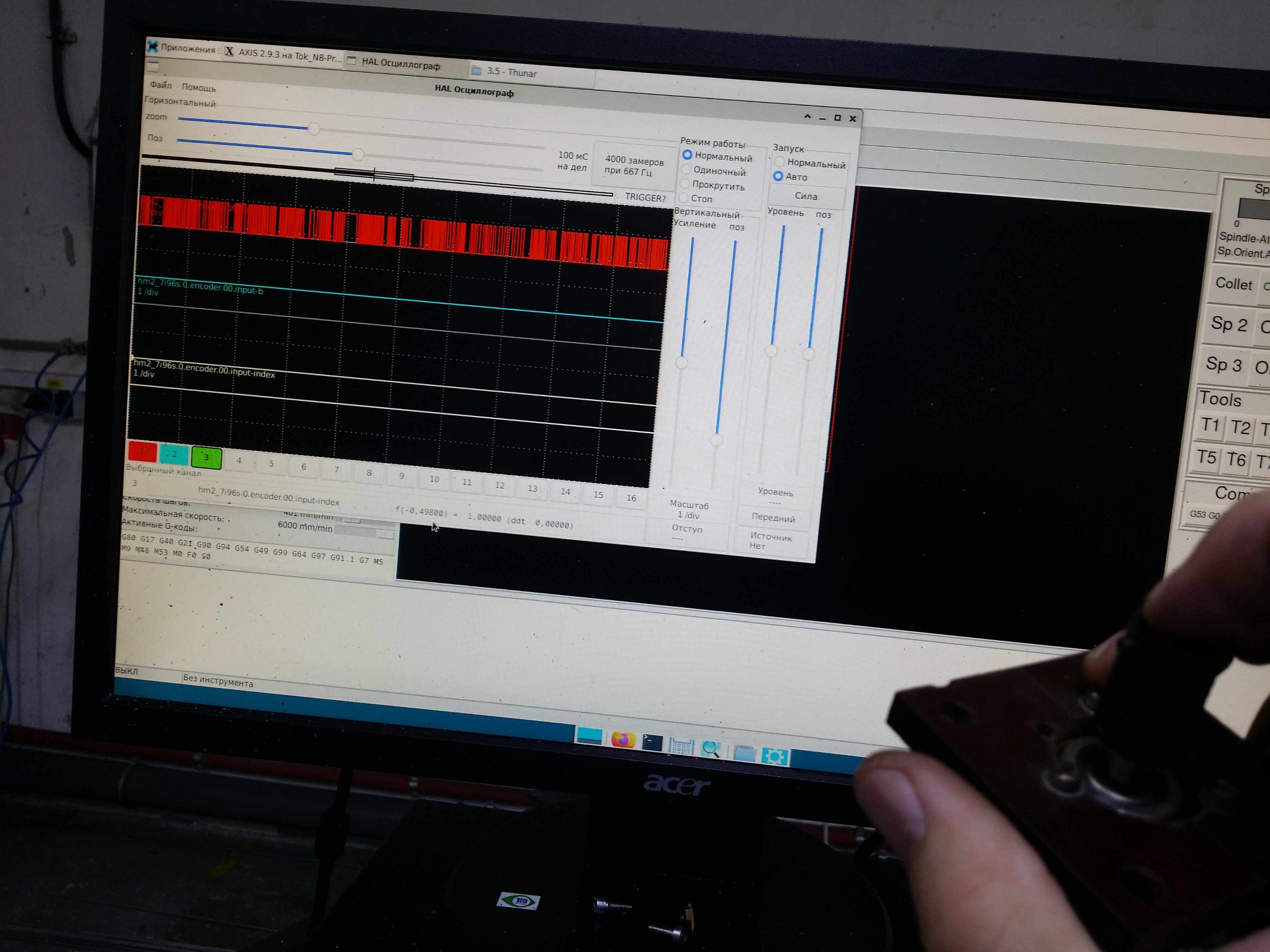

5 years using mesa cards and this is the first time i had issues. The cards i'm ordering via cnc.prom.ua (the same price ±, like on the official site but not need to pay customs and tax) Usually they came already opened (the sticker is damaged), maybe they testing it, or just puts their logo.
I found only DS26LS32CM, AM26LS32AC , AM26LS32ACDR, 26LS32AC (which can be used?)
So, the used 7i96s card, which was on a lathe. Signal wires on one side of the El.box, power wires on the other side of the El.box - nearly one year worked well:
ch-a - working
ch-b - not working
ch-i - not working
The new 7i96s (rev E was not used and not tested after arrival) :
ch-a - working
ch-b - not working
ch-i - working
ch-a - working
ch-b - not working
ch-i - not working
ch-a - working
ch-b - not working
ch-i - working
Last edit: 28 Apr 2026 08:14 by xenon-alien.
