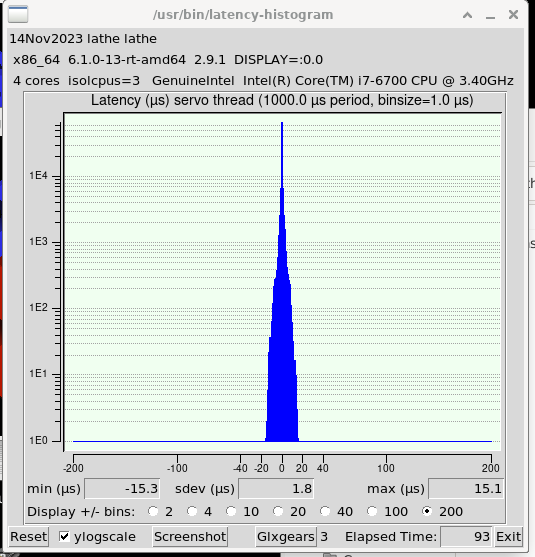

Replied by Unlogic on topic Mesa hm2/hm2_7i96s.0: error finishing read
I had major issues with this exact Elitedesk setup recently that I made a post about in my build thread here on the forum: forum.linuxcnc.org/12-milling/50559-opti...nc-conversion#284497[Rather than starting a new thread, I'll continue here...]
Starting to commission a new build and I'm getting the error finishing read problem crop up within seconds of starting LCNC and could use some help diagnosing.
PC: HP elitedesk 800 G2 mini
NIC: Intel i219LM
LCNC: 2.9 from ISO on LCNC home page
Kernel: 6.1.0-13 (haven't messed with this)
etc/network/interfaces:
auto lo
iface lo inet loopback
auto eno1
iface eno1 inet static
address 10.10.10.1
hardware-irq-coalesce-rx-usecs 0
Grub:
isolcpus=3 intel_pstate=disable processor.max_cstate=0 idle=poll cpufreq.default_governor=performance i915.enable_dc=0 ahci.mobile_lpm_policy=1 irqaffinity=0 nomodeset quiet
Good latency after fiddling with grub. Just copied the above from the latency thread, don't really understand the backstage stuff.

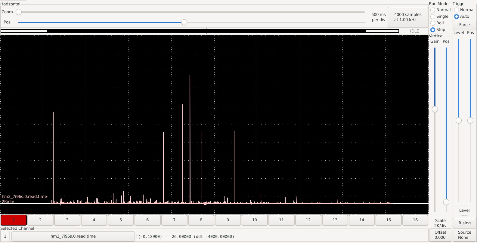

hm2/hm2_7i96s.0: error finishing read! iter=4596

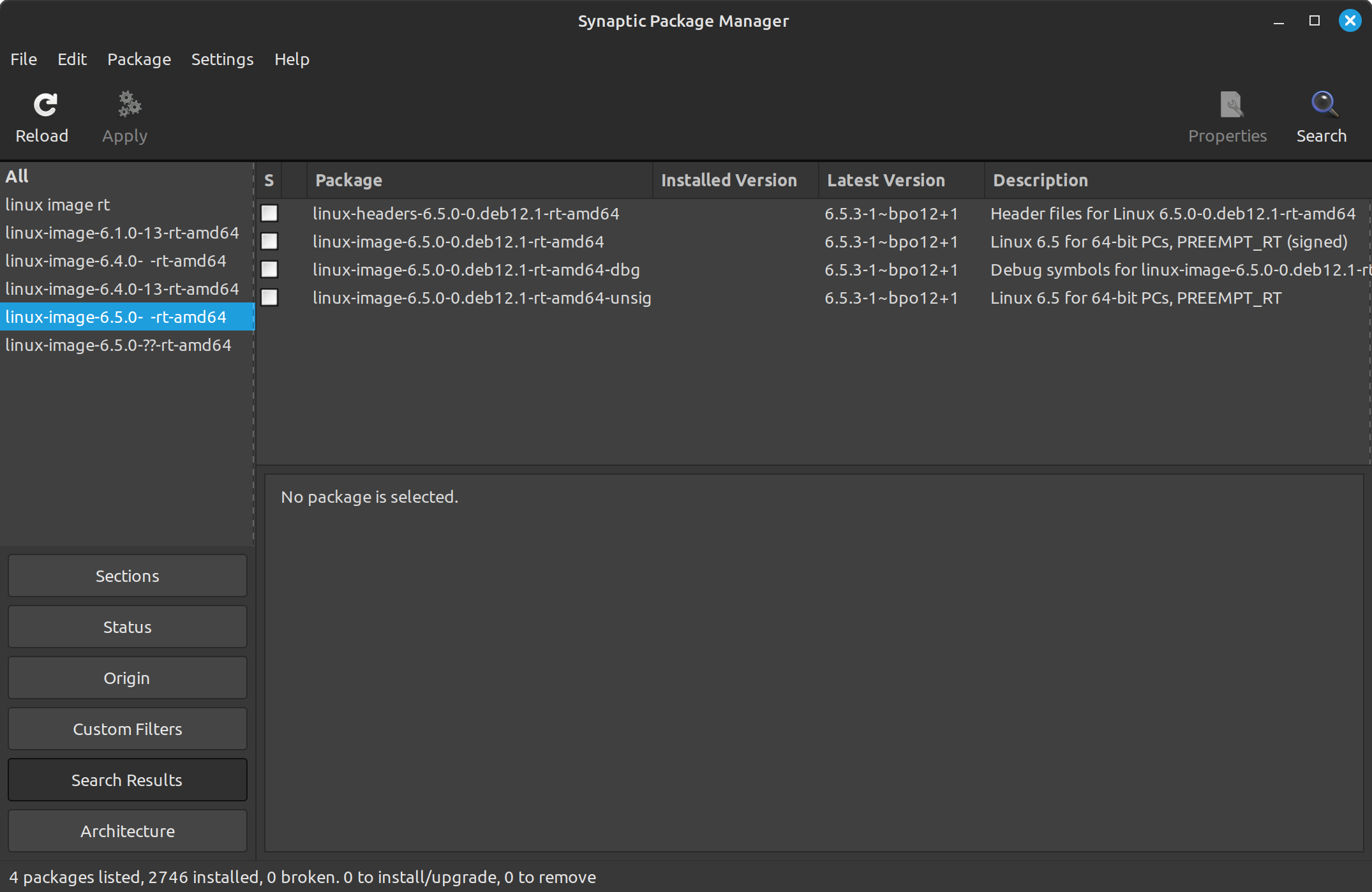

Would trying a later kernel (6.3,6.4,etc.) help? I did see mention elsewhere here that there is a recently fixed bug related to Intel i219LM NICs...but don't know if that's related or when the fix will make it to kernels appropriate for LCNC.
ThxI

@Unlogic - thank you. Your thread was what I referenced earlier about the kernel bug.
I'm hoping either
Really, really don't want to deal with installing another PC in my console. Again.
I'm hoping either
- New LAN cable, or (slim hope, but easy)
- PCW's suggestion to pin the IRQ, or

Update...
New cable - no joy butwas worth a try - Thanks Tommy
PCW's IRQ affinity - no change in behavior, but thanks for the braiin-dead instructions.
Screenshot of the read times attached... huge spikes.
Next step is a new kernel.
I've checked synaptics and the only kernel available with the bog-standard bookworm ISO install is 6.1.0-13.
Before I grease this thing and have a go with Trixie...
is there some other way to get the 6.5 kernel and patch? I fumbled around last night and added 'testing' and 'unstable' debian repos through synaptics, but none of the newer kernels appeared in the search results.
