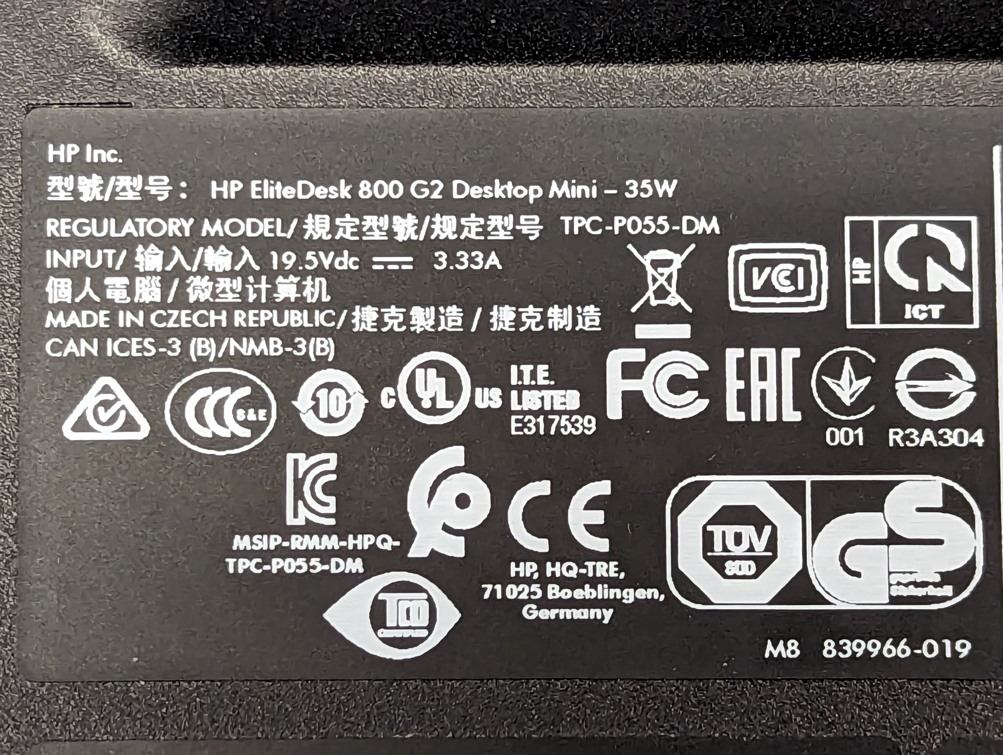

PC specifics are:
HP EliteDesk G2 800 mini 65W
I5-6500 3.2 GHz
BIOS N21 Ver,-2.19 06/01/16
Ran for LinuxCNC 18 hours without issue but my test
SSD drive died  when I did a power cycle to read the BIOS
info so I probably wont do a longer test until I get a
new drive.
Last edit: 01 Dec 2023 21:45 by PCW.
02 Dec 2023 09:05 #287011 by Unlogic
Replied by Unlogic on topic Mesa hm2/hm2_7i96s.0: error finishing read
Interesting the unit I have is also an i5 but the 6500T model and it's rated at only 35W.
  • tommylight
  • tommylight's Avatar
  • Away
  • Moderator
  • Moderator
02 Dec 2023 13:42 #287022 by tommylight
Replied by tommylight on topic Mesa hm2/hm2_7i96s.0: error finishing read
Seems like this one uses a laptop processor, hence the latency issues.
I did not check, it's just from experience.
02 Dec 2023 13:59 #287024 by Unlogic
Well at least we found the cause of the varying results, I bet the it throttles like crazy going in and out of various power states in order to maintain that 35W TDP.
02 Dec 2023 14:29 #287027 by PCW
Sort of funny actually, because that's the power supply I got with
my ebay 800 G2, and it will not run the PC, you get a beep error and
no bootup. I had to borrow a 135W supply from another HP Elite
to do the test...
02 Dec 2023 17:09 #287032 by spumco
Replied by spumco on topic Mesa hm2/hm2_7i96s.0: error finishing read
And mine is a 65W, which explains why I didn't keep seeing EFR's once I sorted out the 7i96s 5v power supply.
