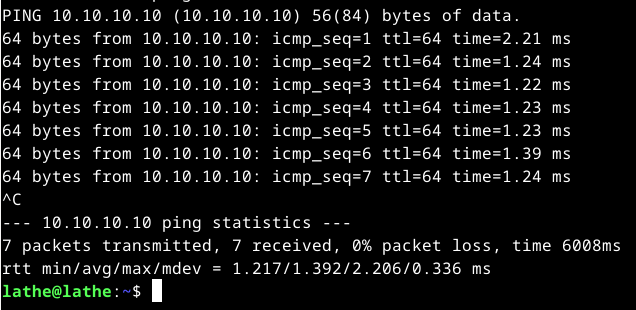

Ok, back in the saddle.
Quick try with MX23 both with 6.1 and 6.5 rt kernels. No joy, still getting read finishing errors.
What's the next disto/version/kernel/NIC driver combo to try?

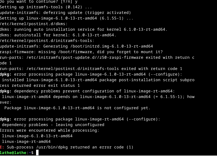

Now I'm getting errors trying to remove the driver.

17 Nov 2023 09:47 #285713
It is an older version of Debian 12 with some issues, namely looking for raspi stuff on an AMD build!
You can fix it by searching for "raspi" and deleting all 3 files it finds, then update and upgrade as usual.
Replied by tommylight on topic Mesa hm2/hm2_7i96s.0: error finishing read
How and from where did you install this version?Now I'm getting errors trying to remove the driver.
