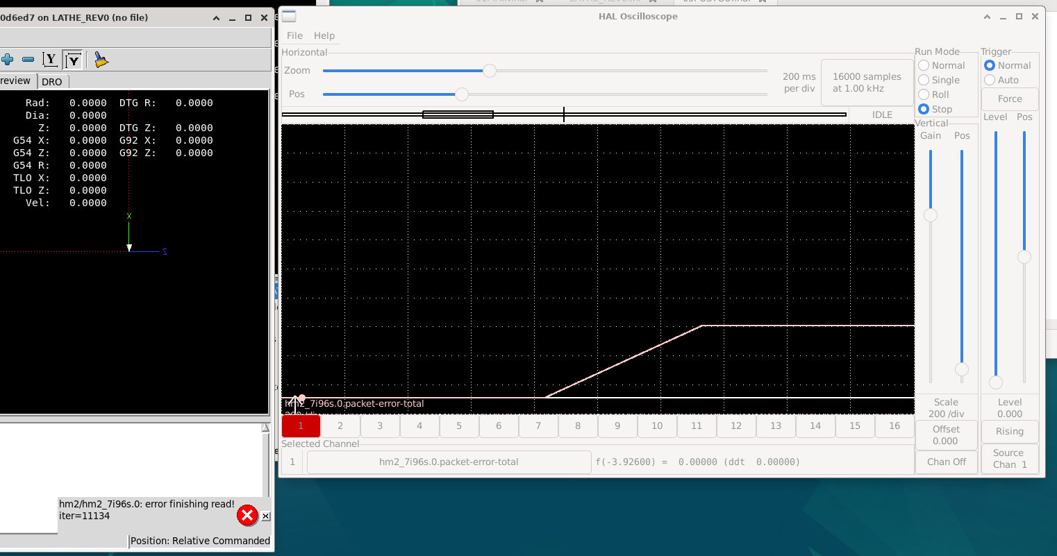

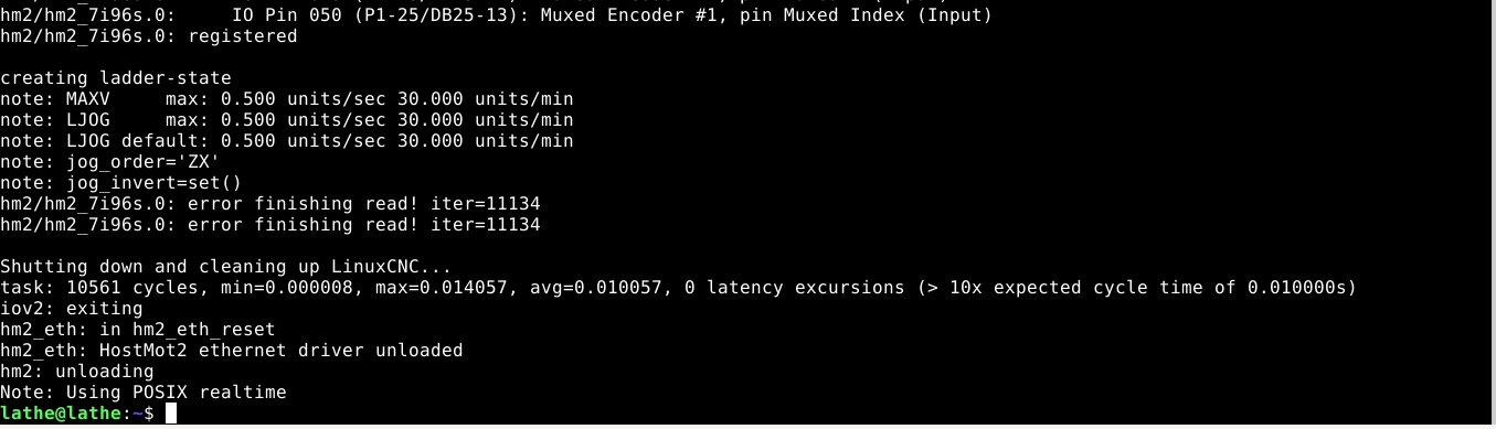

19 Nov 2023 18:02 - 19 Nov 2023 18:10 #285929
by spumco
Replied by spumco on topic Mesa hm2/hm2_7i96s.0: error finishing read
Managed to catch it. This with error-level set to 1000.
Does not appear to be intermittent errors piling up, but a failure to commuicate from the start?
EDIT
Set error-level to 10000 and exactly the same thing happened, just took longer to trigger.
This feels like some sort of setting I've got wrong and not some intermittent communications error.
EDIT
Last edit: 19 Nov 2023 18:10 by spumco. Reason: more info
- Posts: 18111
- Thank you received: 5330
19 Nov 2023 18:17 - 19 Nov 2023 18:21 #285933
Replied by PCW on topic Mesa hm2/hm2_7i96s.0: error finishing read
Yes, that looks like it simple times out every packet
(so about 1/2 second to get the 500 time out errors needed to trip the read error)
Maybe is is worth looking into the configuration a bit,
Can you try a minimal configuration? (nothing but axis stepgens for example)
Last edit: 19 Nov 2023 18:21 by PCW.

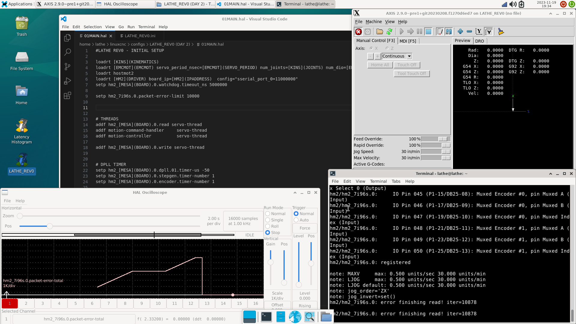

- spumco
- Posts: 2180
- Thank you received: 905
19 Nov 2023 19:36 #285945
by spumco
Slight change with minimal config - errors stop briefly, then accumulate again.
Entire HAL file is in upper left of screenshot.
