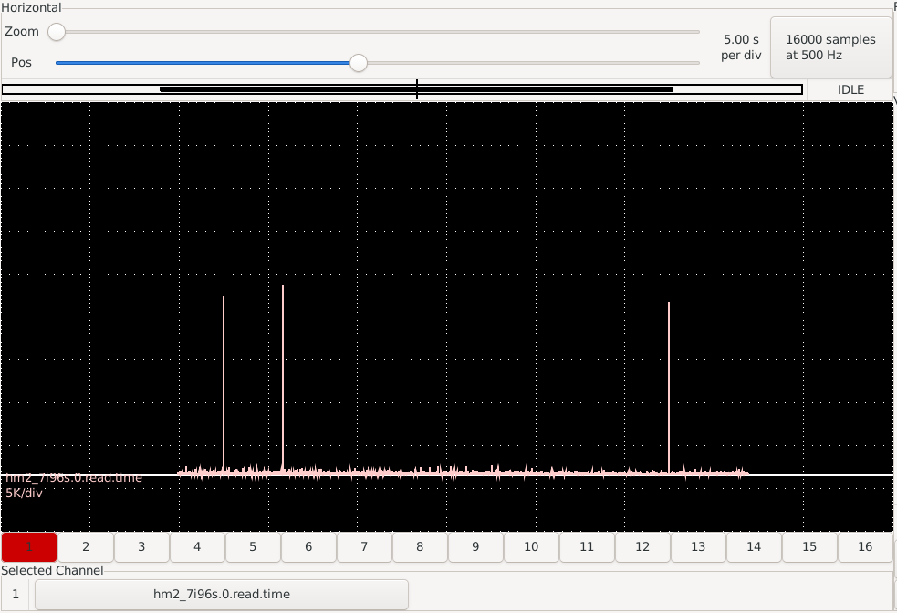

16 Nov 2023 02:21 #285564
by spumco
No dodgy caps inside.
No overheating during latency histogram.
Ran automated latency test for a couple hours last night with no hiccups and really good latency.
Only one memory module and no spare laying around, so cant test that.
HD is an SSD that was newly installed when I bought it last year.
Power supply is the OEM HP, nothing fishy about it.
Time to break out the other SFF PC and see if the realtek NIC problems have been sorted since I tried it early this year.

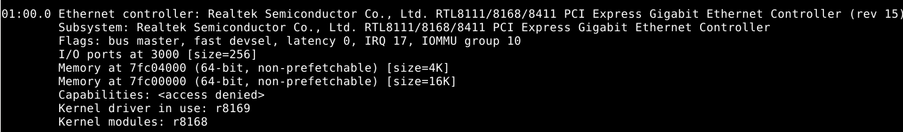

@spumco, I can't remember. Do you have an R8168 et al NIC card?
add non-free to your sources.list and install dkms, linux-headers-$(uname -r) and then the r8168-dkms driver....
Failing that its time to build the 6.5 kernel from source.

16 Nov 2023 04:43 #285574
by spumco
Replied by spumco on topic Mesa hm2/hm2_7i96s.0: error finishing read
Rod - yes, the 'backup' PC has an 8168. The earlier failures were on an HP elitedesk 800 G2 I bought because the other one was unusable because of the realtek NIC.
I've got non-free in the sources, and dkms vomited while trying to install it.

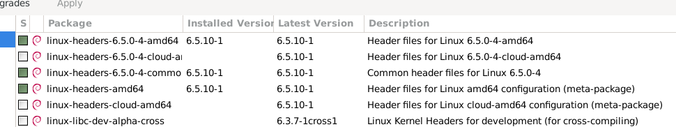

16 Nov 2023 04:58 #285576
by spumco
Screenshot of the NIC info:
Yep, shows up in synaptics.DKMS needs linux-headers. Did you instll them? Using $(uname -r) makes sure you get the right one for your running kernel

16 Nov 2023 05:21 #285577
Replied by rodw on topic Mesa hm2/hm2_7i96s.0: error finishing read
not seeing a Real time version
Do you have a PREEMPT_RT kernel installed?
What does uname -v say?
