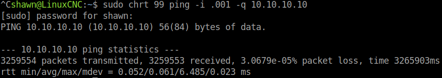

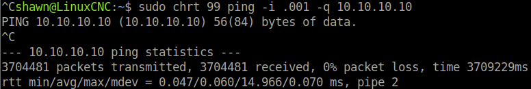

22 Feb 2023 21:12 #265068
Replied by PCW on topic Guidance Needed! Initial LinuxCNC/PncConf setup
For testing network latency, you can try this:
sudo chrt 99 ping -i .001 -q [card_ip_address]
And run it for an hour or so while doing normal things on the computer.
(you stop it with control C)

23 Feb 2023 00:17 - 23 Feb 2023 00:18 #265078
by Sray69
Replied by Sray69 on topic Guidance Needed! Initial LinuxCNC/PncConf setup
I ran the following:
sudo chrt 99 ping -i .001 -q 10.10.10.10
Result:

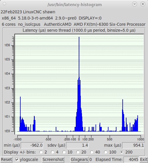

I also ran:
latency-histogram --nobase --sbinsize 5000
Result:
Both of these tests ran for an hour at the same time. I also ran one instance of GLXGears and a web browser with like 20 tabs open (but no internet).
I also want to mention that I am still getting the same error as mentioned previously when I am in LCNC and I click the "Toggle Machine Power [F2]" button. The amber light comes on after about 30 seconds or so of clicking the button.

23 Feb 2023 01:09 #265081
Yeah that's not unexpected with almost 15 ms peak on ping
Do you have all power management, CPU speed
modulation (cool and Quiet turbo modes etc) disabled in the BIOS?

23 Feb 2023 18:28 #265134
by Sray69

23 Feb 2023 19:21 #265138
Better but still pretty bad (6.5 ms)
How is the latency test?
