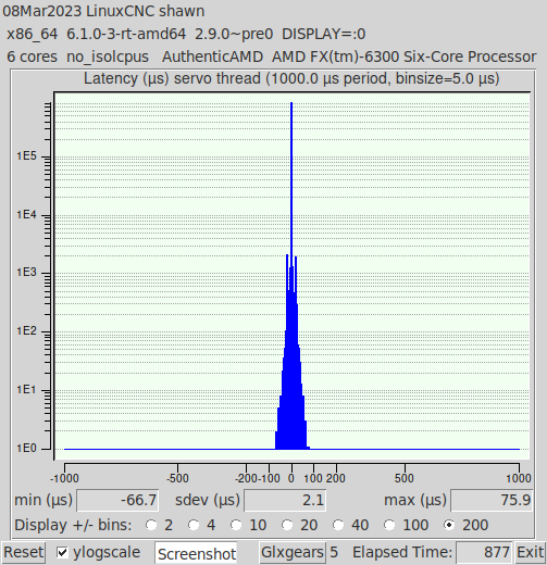

08 Mar 2023 21:58 #266153 by Sray69
I think my latency is good. I just ran this with 5 glxgears and a web browser with like 20 tabs open. Does this look OK? I am running a Mesa 7i76E.
latency-histogram --nobase --sbinsize 5000
I was recently having ethernet latency issues. Not sure if I still am though. If I were then could that be resolved with a new intel NIC?
09 Mar 2023 00:06 #266161 by rodw
it looks acceptible.
Try adding isolcpus=2,3,4,5
Isolating 4 cores made a big difference with my 6 core ARM chip.
But don't stress if you can't improve on what you have,
The following user(s) said Thank You: Sray69

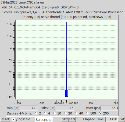

09 Mar 2023 23:57 #266244 by Sray69
OK so I finally got the isolcpus to work. The histogram still shows 6 cores but is shows that I am using isolcpus=2,3,4,5.
I would say it looks much better. Thanks
10 Mar 2023 00:49 #266248 by rodw
That looks right. What you have done is isolate those cores to be for PREEMPT_RT only. eg the real time part of linuxcnc (servo-thread)
User space items will run on cores 0 & 1.
Core 0 by default also recieves some system interrupts so we don't want PREEMPT_RT to run on it as it could be a bit clogged with other traffic.
