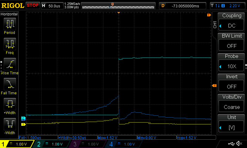

My 2023 'Christmas project' is a probe interface board that measures the resistance of the probe contacts. It will provide a PNP NC or NO signal to the CNC, red & green LED outputs and a buzzer output. This is an earlier version that didn't do the resistance measuring: www.youtube.com/shorts/Yk2ZmRjruxY
The resistance measuring means the CNC signal fires on initial touch rather than waiting for the contacts to fully open. It also cuts power to the contacts before they are fully open to mitigate any risk of arcing.
The design is built around my ebay bargain 21 year old Renishaw TP6 but that is a test group of one... so if any one is interested in this project, please let me know and/or if you have a probe I could borrow to increase the test group to two (it would not be used in the mill, only on the bench) please let me know! I'm based in the UK.
This is a oscilloscope trace of what happens when the probe is triggered (yellow is the voltage applied to the contacts):

Another significant advantage to resistance over bouncing switches is noise immunity, and ofc improved latency of which Lcnc could certainly do with. Not uncommon for a switching-probe (with debounce applied) to calibrate as much as with >0.05mm error with Lcnc. Hopefully yours can cut this by half or more.
Keep us informed of your dev. Thumbs up on the oscope trace.

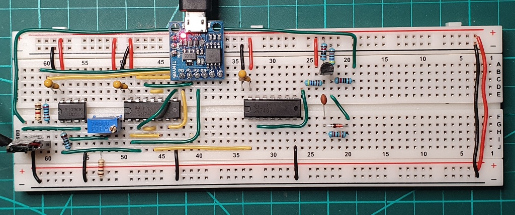

Hopefully I won't be dismantling my Renishaw unless it starts playing up (more) but the schematic (and probably din rail mounts) will be made available in a repository.
This is today's breadboard that implements the current schematic, from left to right: op-amp (but not using the second half as a comparator because it is too slow), a 74LS02 operating as a latch, an ATTiny85, a SN7407 (who knew you needed one of them?) and a PNP to switch the probe contacts off/on with (just below it) an asyncronous Miller integrator (and that bit was waaay above my pay grade ... thanks Zapper!).
And hopefully enough space to fit the CNC signal bit, the (24v to 5v) voltage regulator bit and the buzzer bit.

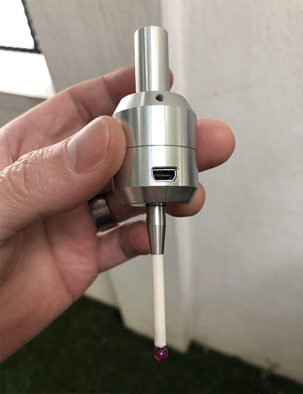

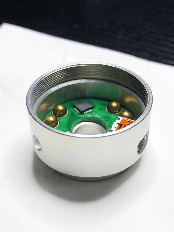

Clever. I like that circuit, quite inspiring. I'm one of those who makes his own personal 3d probes so please update us, I might honor your design! Never owned a renishaw (or any precision-grade), I'm one of those who perceives that tool as a "consumable" you see! (I'd never forgive myself for smashing one out of spec or worst, seeing a whole unit to hell. And so affordable probing it goes...)
Last one I did was 3 or 4 years ago. Tiny Mini Small Form Factor (26mmOD), using the pcb for ball mounts and switching. Using it with Lcnc nowadays, w/ 3 spares in the drawer for crappy days.

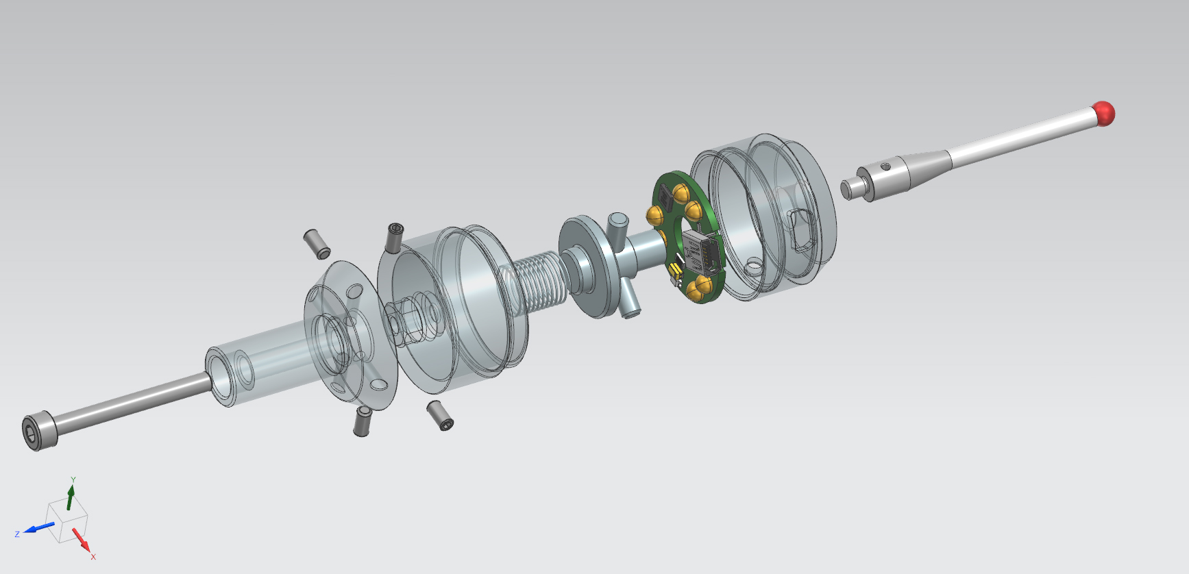

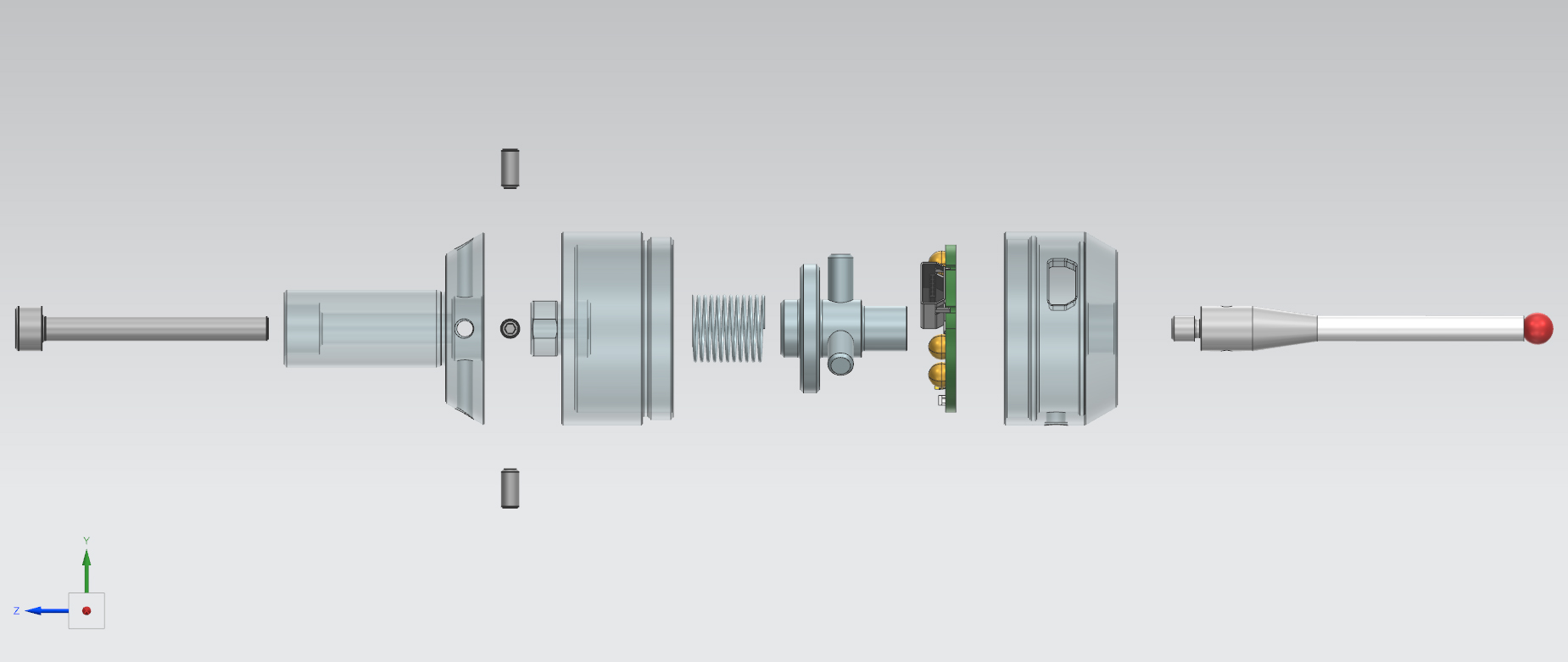

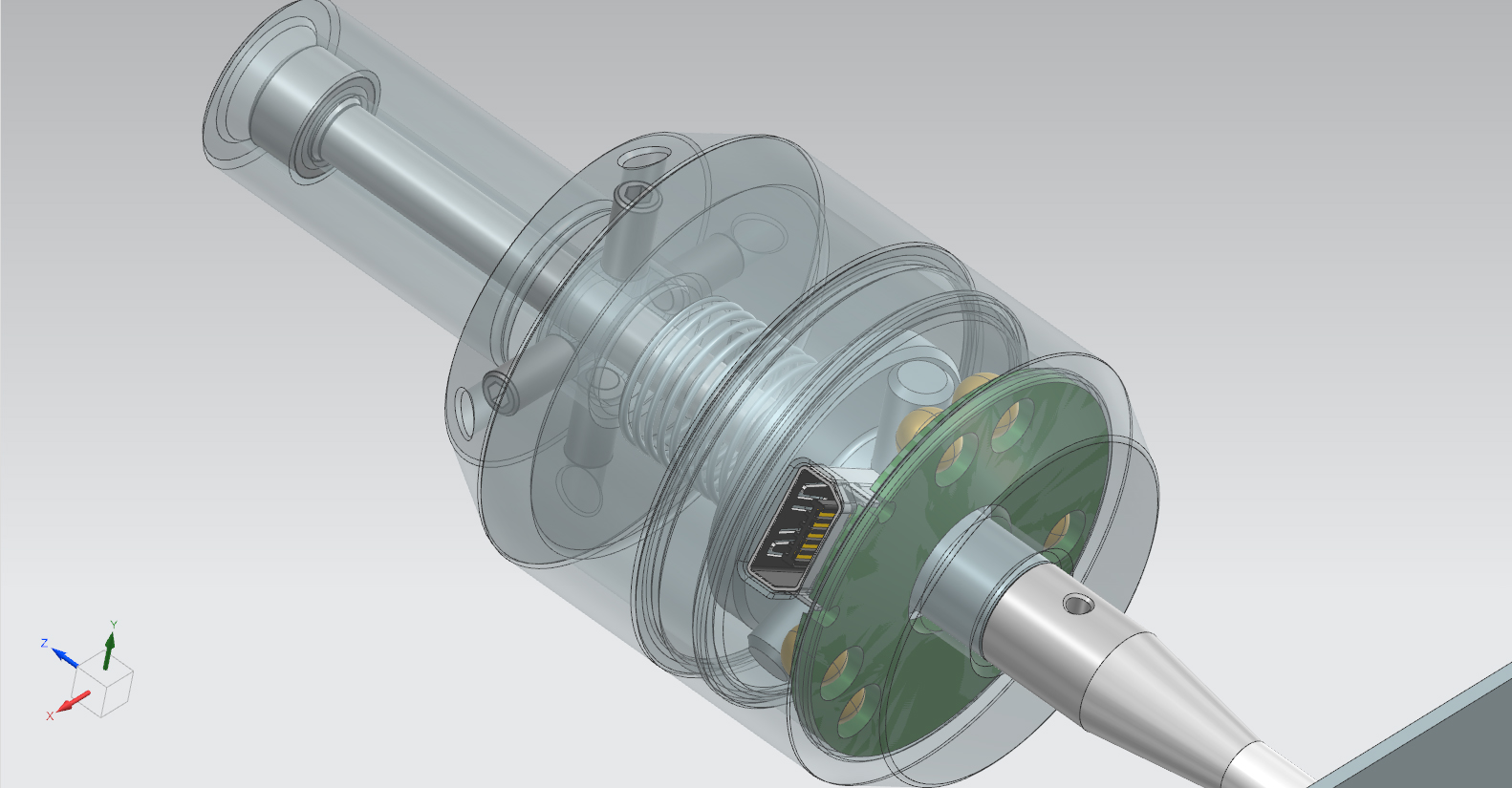

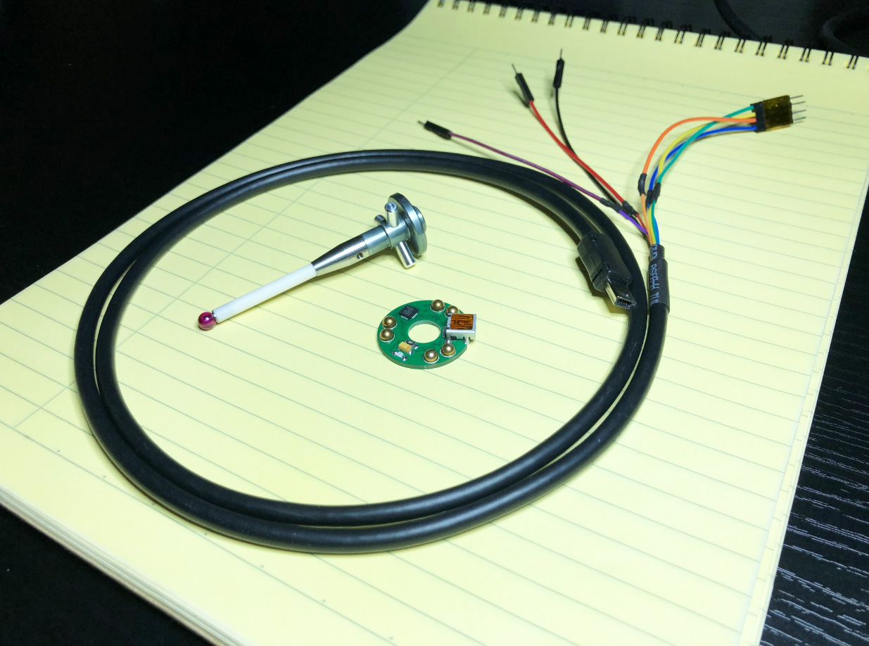

11 Jan 2024 21:46 - 11 Jan 2024 22:07 #290458
by Mecanix
Replied by Mecanix on topic Probe Interface Board Design (resistance switching)

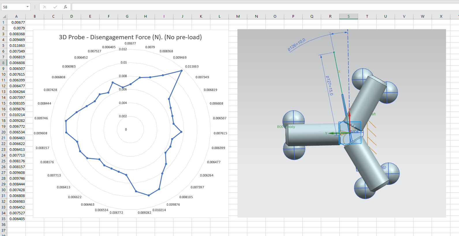

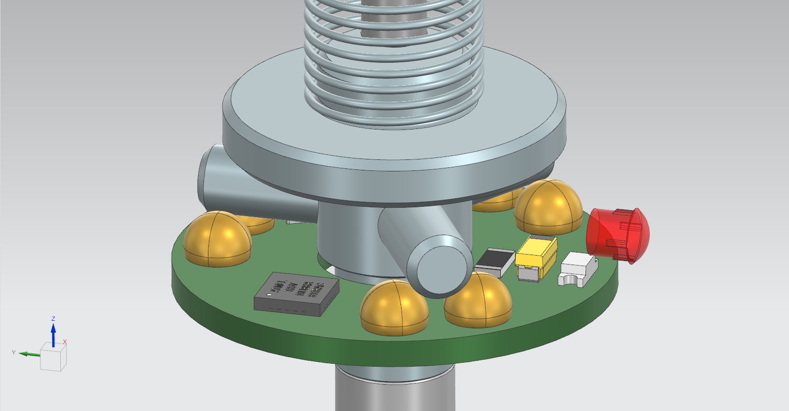

Unpublished however I'm more than happy to get in touch and send it over, no commercial affection whatsoever attached, just a dumb (but essential) tool. Mind you there isn't any space-tech to it, easy to replicate on a cloudy sunday afternoon (see visuals).
I'm all-in for trying your circuit when you feel it's ready though (oscope to share for sure). ps. screw renishaw and their secret magic... diy +/-0.01mm is enough!
edit; added a few visuals, you'll get the idea. Fun weekend cad...
Last edit: 11 Jan 2024 22:07 by Mecanix.

Replied by fletch on topic Probe Interface Board Design (resistance switching)
That's a very clean design! Not sure how DMs work here but my email is on the github page.

I've STEP the entire assembly for you (proprietary LinuxCNC confidential IP and all lol). You should be able to unpack that lot using any half-decent CAD. If that doesn't work, let me know and I'll find another way.
