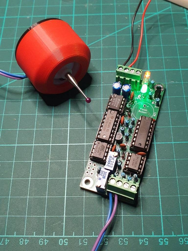

Yes, I will share all the schematic and gerbers on github - although I have a few spare v1.0 PCBs but I haven't yet tested on the CNC - still have to print a case to avoid shorting on all the chips.
Talking of pictures, here's the first one fully soldered without releasing any blue smoke (paired, obviously, with a Mostly Printed Probe).
Philip
Philip

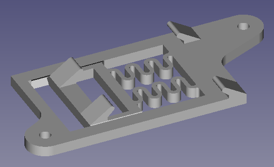

I've also just uploaded the case and din rail mount (my first print-in-place design).
github.com/Stutchbury/CNCProbeInterface/tree/main/stl
Enjoy
Enjoy

Oh christ who came up with this springy pcb clippy idea? that's just so brilliant (and useful)!!!
Placing the monthly passives and components order this coming week. I'll swing in what's needed in that lot. Nice work man

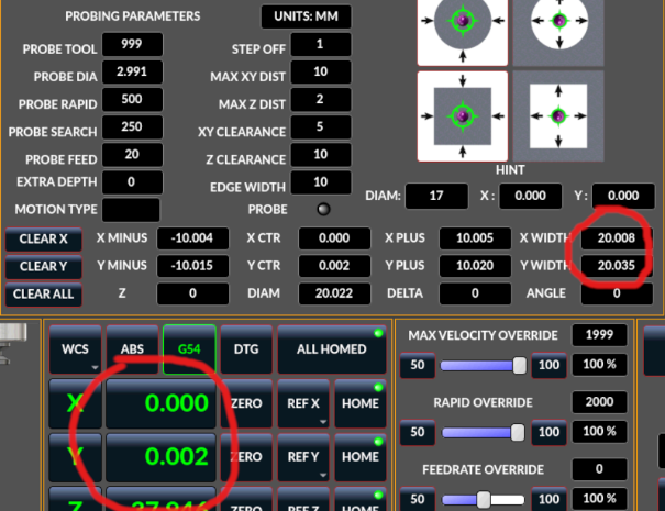

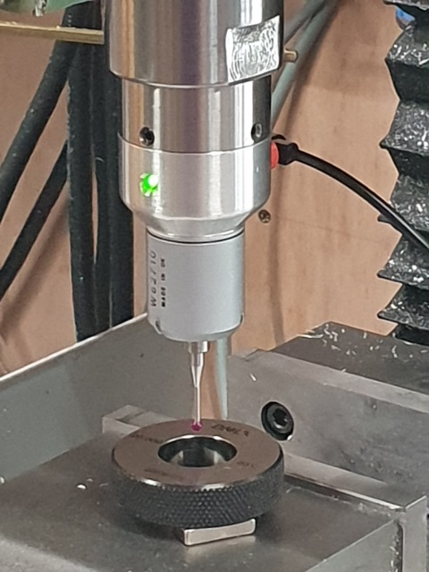

Quick update: I did some more testing today with my new improved Renishaw mount, complete with magnetic connector:
and am very happy with the results:
My test 'hole' is exactly 20mm (I always thought they were never exact, but this one is bang on the money) so to be between just 8-35 thousandths of a millimetre off makes all the effort worthwhile. Repeatability of less than a few thousandths is good too.
I'm sure if I wasn't using a 21 year old probe it would be even better but the ability to 'tune' the resistance of the knackered contacts was very useful.
Replied by fletch on topic Probe Interface Board Design (resistance switching)
Thank you - the design is mine but based on something I saw a year ago with a single 'spring' but now, of course, can't find - so I can't take all the credit.Oh christ who came up with this springy pcb clippy idea? that's just so brilliant (and useful)!!!
