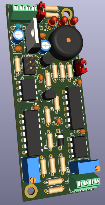

20 Jan 2024 12:25 #291199
by fletch
Replied by fletch on topic Probe Interface Board Design (resistance switching)
Progress has been made... A Wheatstone bridge to help 'tune out' residual resistance in the probe contacts & cable, I finally learnt how to flash a bare metal ATtiny85 from PlatformIO. Still have to 'calculate' the usual random resistor values - some are confirmed but others are a bit finger in the air.
This was originally planned to be my first SMD project but the my brain put the electronics in the 'quite hard' pile, so possibly a step too far. Maybe. Even with THT the PCB is 32mm wide x 84mm tall so should be DIN rail mountable.
