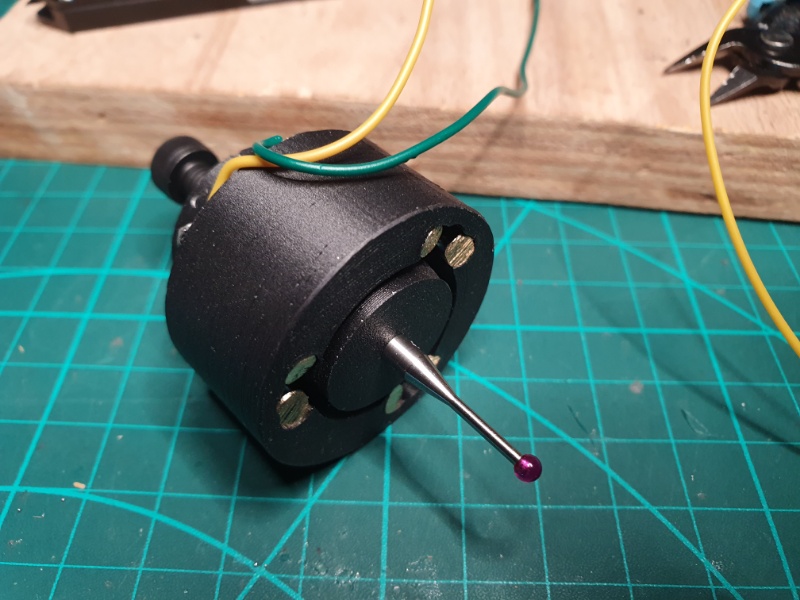

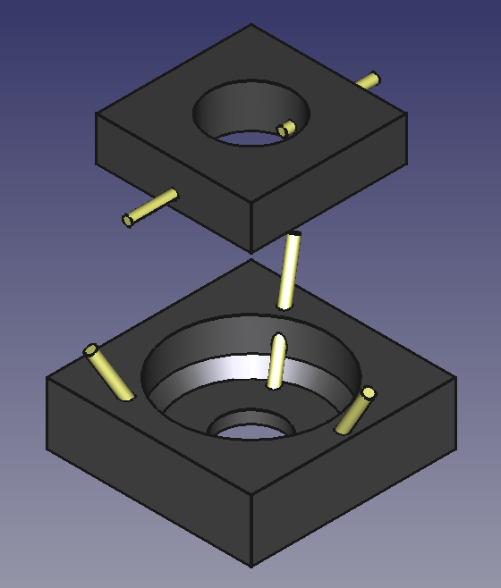

Today's tech never ceases to amaze me. 24 hours ago development of the board stalled because my probe broke yet now I have a 3D printed one! Shame the chrome rods are not the best conductors but nothing a quick spin on the lathe tomorrow back to the brass won't solve (tungsten rods on order though).
Thanks again Andy - I'll be definitely have a go at designing/making a more precise one - I like the idea of being able to repair/replace it when (not if) I crash it.
Edit: Now I've removed the chrome this now shows similar electrical characteristics as the Renishaw TP6.

22 Jan 2024 11:12 - 22 Jan 2024 18:30 #291334 by fletch
Thanks Cake - now I want to know more about how the piezo compensates for the 3 lobes but I suspect I'll be disappointed.
The TP6 looks like the top cap should unscrew from the main body and/but there are three 'pin holes' that could either be for a specialised pin spanner or need punching out before disassembly. I have called Renishaw but while hopeful, I don't expect an answer soon. The tension screw on mine has never worked - fully out it would stop and there was no fully in. The pressure required to move the stylus never changed so I suspect there's a bit on the loose inside which is now stopping the contacts making.
Up until it broke, the contact resistance was a bit variable (probably because of the lack of spring tension) but operated fine at 5v with the 'check if still open loop' able to detect closed at 0.5v. Now I've removed the chrome, my '3D printed special' shows similar characteristics.
Philip

22 Jan 2024 19:10 #291358 by fletch
The Reishaw TP6 probe is fixed! Hopefully. I modelled a couple of 'tools' to use with 5 x  1.5mm drill bits to use as pin spanners and then bravely took it apart.
Apart from an interference fit that caused a fair bit of head scratching, the process went smoothly. Some of the smallest springs I have ever seen but the culprit was the central spring knocked sideways - a complete pig to reassemble (three times) but it is done. Electrical resistance is quite high, so I suspect I'll have to have it apart again to do a proper clean up.
If anyone is interested in seeing the internals of a Renishaw, then I have a couple of photos, otherwise normal service on the interface board will be resumed.
