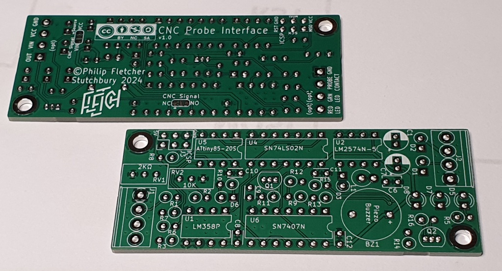

Well, someone had to try it out on a real CNC... Up until now I've been using a bench fixture & wedge to control the contacts & opening speed for the probe interface board.
www.youtube.com/shorts/06nPOA94Pbk
I am pleasantly surprised by its competence - I repeated the probe 4 time and was within 0.002mm each time. Yes, that's way beyond the limitations of my machine and yes, the plastic will likely move with temperature and humidity changes but hey, it's a Mostly 3D Printed Probe!

Hi it's looking much promissing results I wold really like to try interface board with mine electronic damaged OMP60

Hi Yagnesh - That's a nice probe - is the OMP60 a mechanical device? If so, you would have to somehow wire into the physical contacts - would be interesting to see the innards
Edit: If not, you could always make a Mostly Printed Probe...

Sorry for late reply i actually mate a small accident at shop...
Yes its mechanical probe that use same principle Ball and Leg type and ya it is possible to wire physical contact.
i have put it somewhere once i find out will post picture of it.
