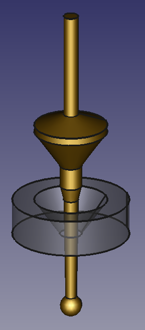

No, I have a Blum TC50 probe. It uses IR to communicate, runs off a 9V battery, and takes fast pulses of IR to turn on/off, and then the probe output is very similar to what you describe. But, it uses a short cone segment attached to the probe fitting, and that is pressed down on another code segment for centering. Any deflection of the probe lifts the cone, and a rod breaks a laser beam.

I'm assuming you mean similar to the Renishaw wireless probe? I did consider doing the IR stuff but would need to get at least the op-amp & Wheatsone bridge on board - and if I'm doing probe-side electronics, why not just go for strain gauges or piezo?
This scheme removes the3-lobed pattern of sensitivity with the Renishaw balls and bars design. Not that that pattern is anything I'd ever be aware of on my machine!
Jon

Ah, something like this? With the bar (or something poking out the top) to break the laser beam.No, I have a Blum TC50 probe. It uses IR to communicate, runs off a 9V battery, and takes fast pulses of IR to turn on/off, and then the probe output is very similar to what you describe. But, it uses a short cone segment attached to the probe fitting, and that is pressed down on another code segment for centering. Any deflection of the probe lifts the cone, and a rod breaks a laser beam.

Yes, that is the concept.

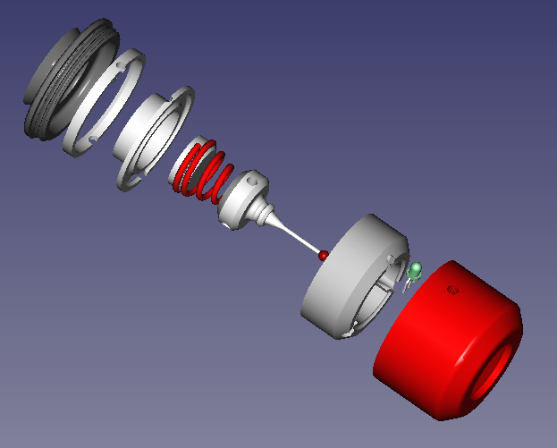

All the stl files are now on github: github.com/Stutchbury/MostlyPrintedProbe (there is a mag-safe version in the works).
I will write a print/build guide soon, but enough distraction for now, back to the interface board!
