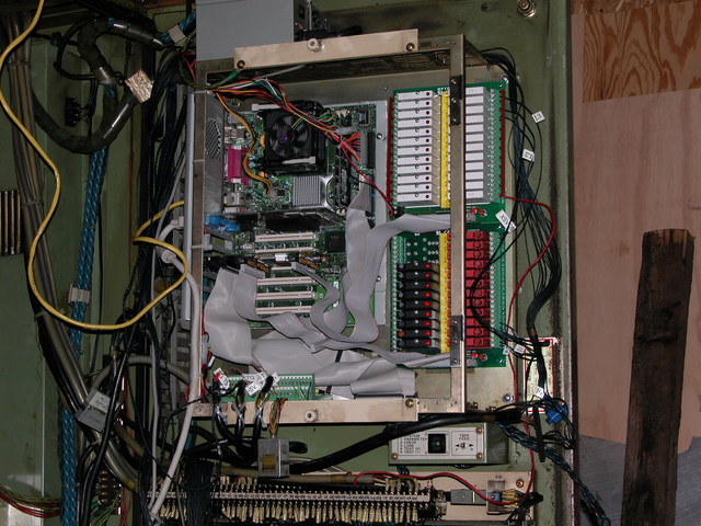

4 Aspirin later, I think I understand how the parts are chosen.
Working backward,,,
From the number of inputs and outputs you determine the Isolated I/O card requirements divide your needs by 8 output, 16 inputs to know how many 7I37 you need
From the number servos you determine which ( and or how many) Analog Servo Interface are needed.
For 3 axis and a spindle can a single 7i33TA 4 axis analog servo interface be used?
For more axis either multiple 7i33TA or a 7i48 would be needed.
From the number of Isolated I/O cards and analog servo interface cards you know how many connectors you have.
If it is 3 connectors, you can use a 5i20
If it is 4 connectors, you can use a 5i22
If it is between 5 and 6, you can use 2 5I20
If it is between 7 and 8, you can use2 5I22
My machine has servos for 5 axis but I don't have the rotary tables so I think i will go 3 axis for now just see if i can do this.
So my parts list would be:
2, Isolated I/O cards @ $79each = $158
1, 7i33TA 4 axis analog servo interface = $79
1, PCI I/O card 5I20 = $199
Misc cables = $100
1, HP xw6000 leftover computer
Total est cost = $536
Is this about right?
Just wondering what parts did Chris use on his MVJR shown in this image?
4, Isolated I/O cards @ $79each = ~$320
1, 7i33TA 4 axis analog servo interface = $79 (assuming this can run 3 axis and a spindle)
2, PCI I/O card 5I20 @ $199 = ~$400
Misc cables = $150
Mother board with 2 PCI slots, any thoughts on that?
I'm looking at:
IntelĀ® Desktop Board DG41WV
www.intel.com/products/desktop/motherboa.../DG41WV-overview.htm
It seems to have two PCI slots, but I'm not up to date on mother boards anymore.
Touch screen, any thoughts on make, model and source for that?
I'm looking at:
ELO TOUCHSYSTEMS 1522L(E518492) 15"
www.newegg.com/Product/Product.aspx?Item=N82E16824217102
Total is getting closer to ~$2,000, but it is looking like an interesting and rewarding challenge.
