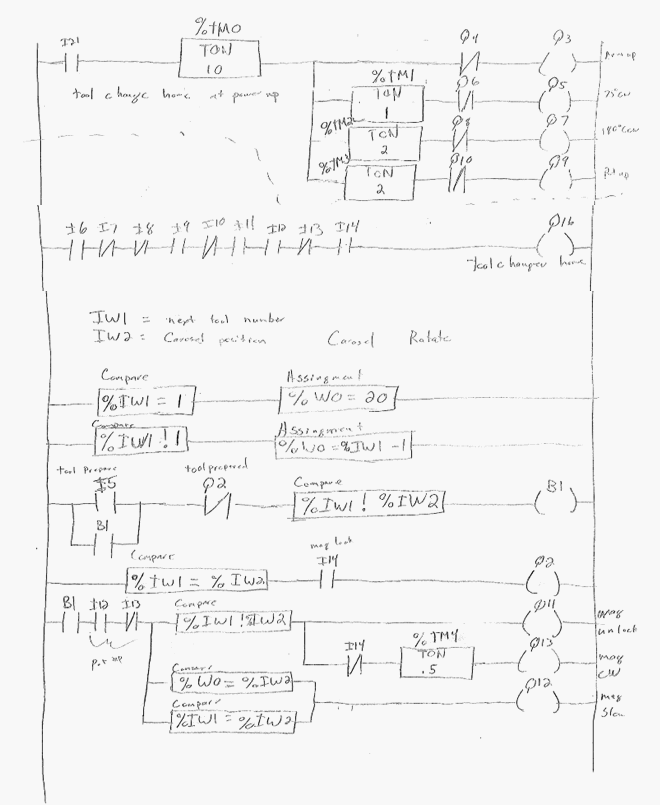

I need to be able to lock out machine movements when the toolchanger is not in the home position. Home position is determined by 5 limit switches
I would assume I should do this in classic ladder as these switches will also be involved in the toolchanger routine.
What do I add to the hal and ini file so I can use the gpio pins in classic ladder?

You would have to link them up with a net command in a .hal file. Once classicladder is up and running open up Show Hal config and see the classicladder pin names and the gpio pin names.
www.linuxcnc.org/docview/html/hal_basic_hal.html
John

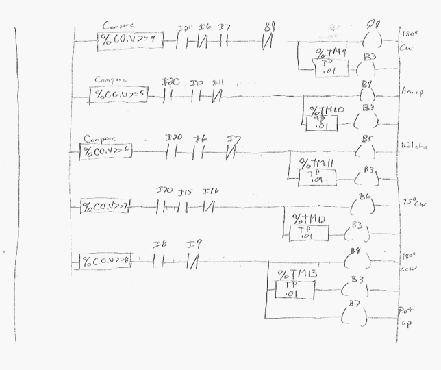

23 Sep 2011 18:13 #13402 by clkeck1
Replied by clkeck1 on topic Re:Mori MV 35/40 retrofit
I layed out the tool changer logic in ladder format. Does this look functional?
The carousel position is determined by a rotary transducer. The plan is to use a "mux32" comp to convert that into a position "%IW2"
