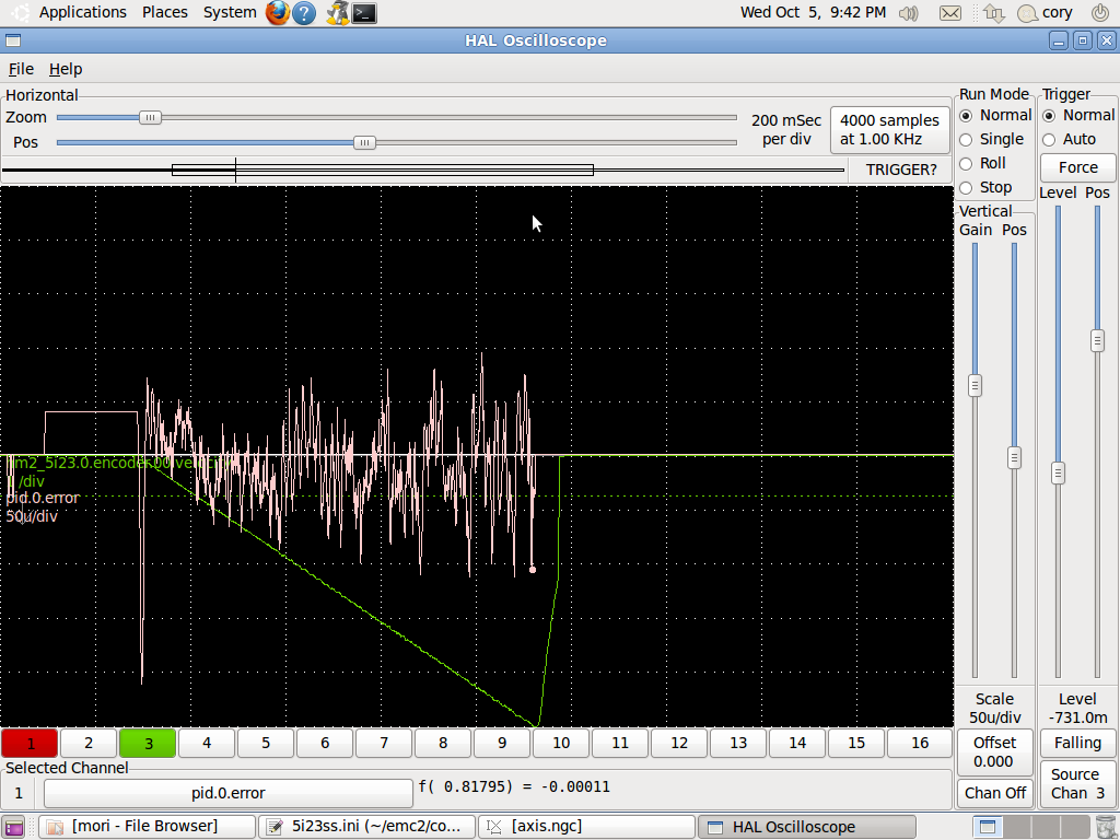

06 Oct 2011 03:12 #13691 by clkeck1
Replied by clkeck1 on topic Re:Mori MV 35/40 retrofit
I worked on it a little more tonight.
(P=40 I=275 D =.12 FF0=0 FF1=.116 FF2=.0002)
I still have a following error issue the attached picture is with Ferror and min_ferror set to .005" The machine errored out on axis 0 (X) at 5in/s and .0001" error there was a .0002" spike at the begining.

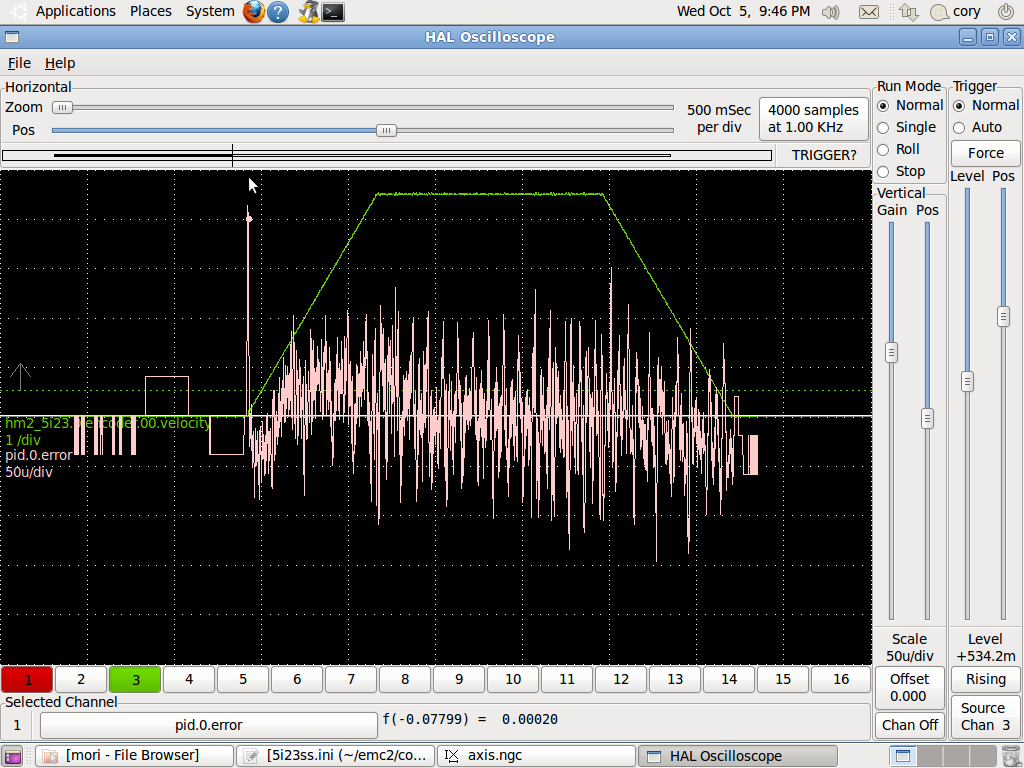

06 Oct 2011 03:15 #13692 by clkeck1
This was with max feed set to 4.5 in/s and the same ferror settings and all was well.
06 Oct 2011 04:00 #13695 by jmelson
Replied by jmelson on topic Re:Mori MV 35/40 retrofit
I wonder if you have too much I? Other than that spike at the start, everything looks very good.
Even the spike is not bad, it is only .0002" (4 divisions at 50 u"/div). I also notice a static error
of about 1 division (those square "boxes" just before the move starts. Unless your encoder
resolution is 50 u", then it is just the position quantization inherent in the encoder. But, maybe
when there is a move, the integral term gets dumped and causes a discontinuity. I have never
seen an EMC system where I was more than 20% of P, so I'm just suspicious.
Jon
06 Oct 2011 04:40 #13697 by clkeck1
Encoder resolution is 40u".
I will pull some more I out and see what happens. It seemed like it wanted more to balance out. With less it went from high to low or low to high. I dont know that I tried anything that low thought. I was under the impression I was 100 plus term.
