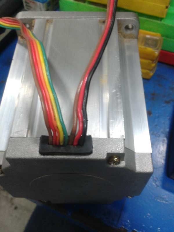

18 Nov 2013 11:33 #40918 by nick gill
Replied by nick gill on topic Roland mdx-650a question
Here are the voltages to chassis:
Black +12V
Red +12V
Brown +12V
Brown +5V
Red 0V
Orange +5V
Yellow +5V
Green +5V

18 Nov 2013 18:45 #40929 by andypugh
Replied by andypugh on topic Roland mdx-650a question
What I don't understand is why does the spindle have hall sensors?
It is (almost definitely) a brushless motor.
With a brushless motor you need Hall sensors to know which of the motor phases need to be energised to make the motor run.
en.wikipedia.org/wiki/Brushless_motor
18 Nov 2013 19:01 - 18 Nov 2013 19:12 #40930 by nick gill
Ok, so you can controll the speed and rotation this way.
Is +5V GND -5V the usual way to drive hall sensors?
What in your opinion Andy, are the questions I need to be asking Jaeger about their spindles? Such as
What method does the spindle use to contol speed (frequency)
and What is the frequency range required to govern your spindle
Sound right ???
Many thanks in advance
Last edit: 18 Nov 2013 19:12 by nick gill.
18 Nov 2013 19:33 #40932 by andypugh
All the ones I have seen have been +5V and 0V power and then the output pin is pulled up to 5V by a resistor. When it is activated by the magnets it pulls the output pin down to 0V.
The Jaeger spindles are induction motors, and need to be controlled by a variable frequency drive. Jaeger can probably supply a suitable drive.
Note that of the three you listed, two have automatic tool change (with HSK25 tooling) and the last is manual tool change. Make sure you have a source of HSK tooling before committing yourself.
22 Nov 2013 08:54 #41102 by jlviloria
Replied by jlviloria on topic Roland mdx-650a question
Andy,
I need help.
connecting my system (4 servomotors), but did not work.
I did the hardest disarm all and start over.
try to ride one just to see because they had worked and check the connection with one servomotor,
but now I have problems when I try to move the servomotor, sueve moves clockwise, and sometimes a touch touches servo axis for rotation and in the other direction also plays a touch servo axis, but rotates with vibration, probe all servomotors, test all drivers. and the same thing keeps happening.
the only thing different was putting on UTP cable to the hall sensor and encoder.
my question is:
that may be causing this? :(

22 Nov 2013 10:00 #41104 by jlviloria
pico-systems.com/acservo.html
www.shinano.com/motors/docs/LA052.pdf
understand, is that you have to rest!
I had worked well when I tried it with a single servomotor.
assemble the whole package (4 servo) motors energized but not move.
disarmament all, to see if he had a connection error.
turned to connect a single servo motor home, but now what I wrote about in the previous post.
in negative direction, moves well, sometimes you have to give a touch to the motor shaft to move
in positive direction, moves vibrated, sometimes does not move, you feel a buzz in the engine,
I changed the PID, up and down P, play with D but nothing's the same with all servomotors and all drivers.
test all sensor connections hall, and this was the one that moved,
there may be bad?
thanks
