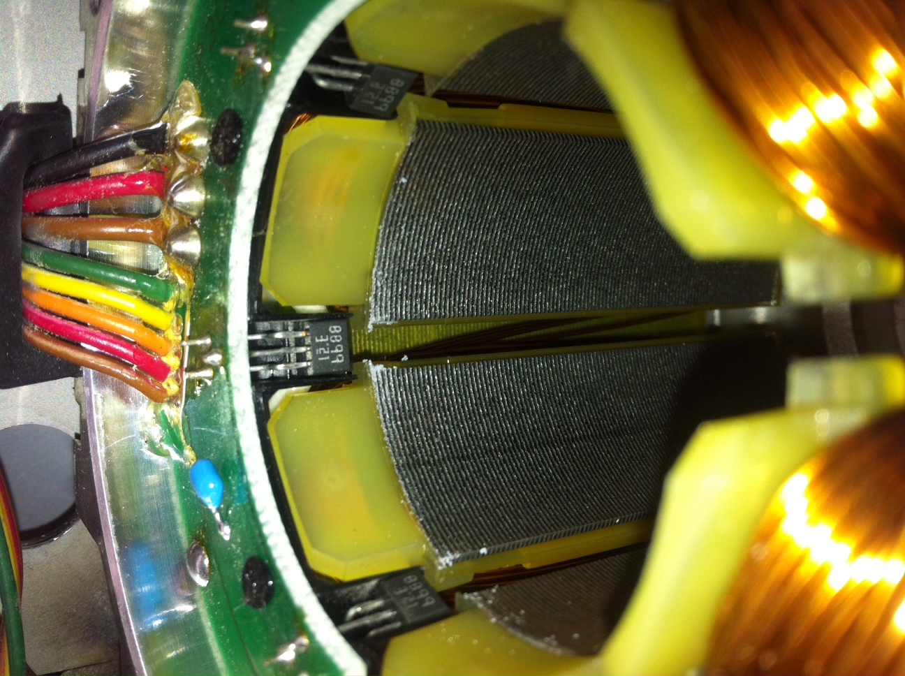

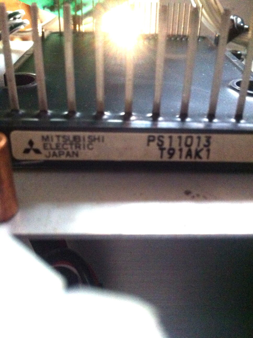

28 Nov 2013 12:39 - 29 Nov 2013 04:55 #41197
by nick gill
Replied by nick gill on topic Roland mdx-650a question
I have discovered some more about this shitty Nidec motor on the 'scope:
AC delta config, 90V RMS @15KHz.. PWM. Idling at 1500 rpm requires 14% duty cycle, 6000 RPM 50% duty cycle.
On the drive side it uses a Mitsubishi IGBT integrated power module PS11013. At least I can exchange this 400W block for a 750W or 1500W block.
I think my only choice is to use a 1.5KW domestic 110V motor like a hand-held router motor, and get my required spindle speed by retaining the 2:1 belt drive, and making it 3:1.
Looking inside the sensors tonight...
Last edit: 29 Nov 2013 04:55 by nick gill. Reason: new information

30 Nov 2013 15:00 #41242
by nick gill
Hi Jorge
I found the datasheet for the Panasonic 8899 spindle hall sensors today.
Here it is pdf.datasheetcatalog.com/datasheet/panasonic/DN8899SE.pdf
The permanent magnet has four flats 90 degrees apart on its rotor. Three hall sensors are arranged 60 degrees apart between the windings.
Is their any other information you require?
