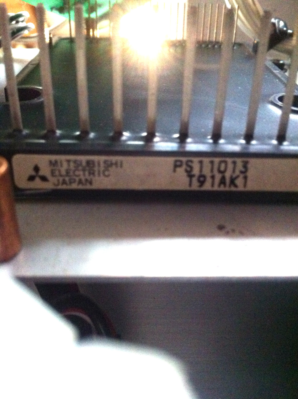

This is what the spindle board on the 650 looks like:
Maybe check the transistor power block for the motor. It's a big thing like this:

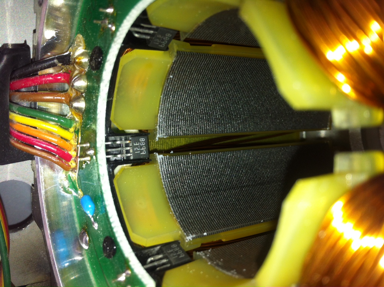

Also check the hall sensors on the spindle motor stator. They look like this:
Reading at the motor stator are:
Black +12V
Red +12V
Brown +12V
Brown +5V
Red 0V
Orange +5V
Yellow +5V
Green +5V
Black +12V
Red +12V
Brown +12V
Brown +5V
Red 0V
Orange +5V
Yellow +5V
Green +5V
