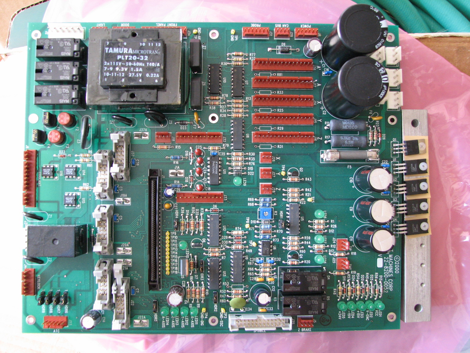

16 Dec 2016 08:01 #84273
by TGTROPIC
Replied by TGTROPIC on topic Light Machine Corp. Benchman XTr (retrofit)
Steve,
I am not able to send pics from my phone and did not bring camera so I will do my best to describe what I see.
J9 has 3 terminals with Y/G, BK and WH wires.The BK goes to the center of the machine near the large donut coils into the bottom LH terminal, along with a different Y/G wire, of a square block with 4 spade terminals potted into place...Fuse?...Ohms about 3.8 across legs.
The white goes into the smaller coil then WH out to lower RH spade on block.
The upper RH spade has a tan wire to the larger coil and then another tan wire from the large coil is attached to the upper LH spade. Coming from the large coil are 4 wires; WH,Y,O,Grey to plug J3 on the bottom of the main board.
TAN(lg coil) TAN(lg Coil)
BK/GR(J9) WH(sm coil)
There is no voltage AC or DC on any of the 4 wires or terminals with the machine powered.
Drive Pilot Light? Full wavwe Rectifier?
TG

- steve_a
- Posts: 75
16 Dec 2016 16:04 #84291
by steve_a
Replied by steve_a on topic Light Machine Corp. Benchman XTr (retrofit)
TGTropic Well that complicates things.... Your board is different than mine but if the schematic is correct then it's a very confusing situation. According to the schematic, the relay should energize when you get the cr_drv_pwr signal. Probably a +24V signal. That should also light LED8, which you have already said is off. So we are back to the Nextmove card. The conclusion is that you are not getting that signal. However, you swapped with a computer that has a known working card so you must have had that signal on that test if it were the Nextmove card you currently have. Unless something is grounding out that signal. So D4, D8, D17, R12 shorted or K4, K6 relay coil shorted. Also a bad cable from the Nextmove Card to the Benchman Or a broken wire from the connector on the Benchman to the control board are possibilities. My experience says that most diodes and resistors are pretty bullet proof though I have seen them fail. The coils are a real possibility but I guess the most likely thing is a bad cable from the Nextmove Card or broken wire. Kind of running out of options here. You might try swapping the cable and see if that does anything.
- dynamyte24
- Posts: 15
16 Dec 2016 17:06 #84294
by dynamyte24
Replied by dynamyte24 on topic Light Machine Corp. Benchman XTr (retrofit)
TG,
This is the spare board I got with my machine, I'm thinking is should be the same as yours.
Rex
Rex
