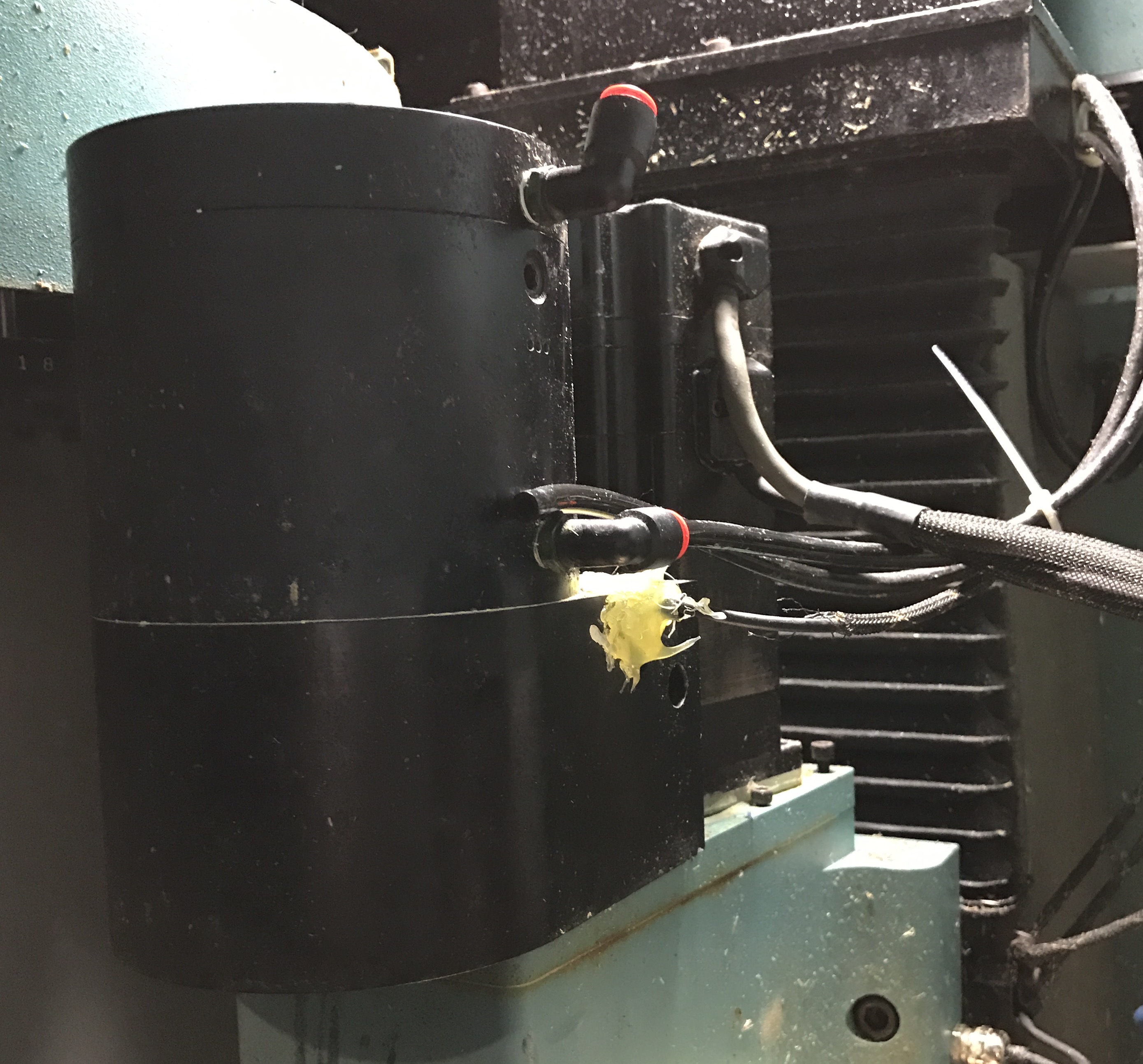

Let me start off by saying I am not an ET and have limited electrical skills but am responsible for other maintenance functions at our shop. We have 3 Benchman XT w/45k spindles and ATC. All was well until about 6 months ago when we had one machine stop moving with the door locked and in the tool change position. Finally able to get the door unlocked but spindle will not energize and table will not traverse and Z axis will not move.
Intelitek made a new power supply and a couple repairs on the main board but still have the same problem. When we start the machine
1) There is a S-Enc red error flashing in the lower LH of the screen. Tech said he “ thought” this was spindle encoder error but machine does not have a spindle encoder.
2) The spindle will not energize and will go through the warm up cycle without turning. We eventually get “ Timed out waiting for the spindle to reach 15000 RPM Sensor indicated RPM is 0. Is the spindle at a safe speed to operate” Y..N
3) After responding yes and attempting to move any axis we get “ Amps could not be enabled, please try again. If problem persists, contact tech support ( FUNNY cause it DOES NOT EXIST)
Any thoughts, ideas, tests that you guys have would be a great help prior to a full retro. Not sure what our problem may be but think is could be something simple.
TG
TG

TGTROPIC, If you have a TL series spindle motor, the encoder is built in. Mine is a 5K but there has to be some kind of encoder for the unit to even know it has a spindle error. That is a symptom though, not the problem. If I understand right, the 45K system has a warm up routine and checks speed. Since the measured speed does not match the expected speed you get the fault. The real issue is that the spindle is not turning at all. Unfortunately, I can't really help you with what to do. My unit has an Allen Bradly Ultra 100 controller that runs the spindle motor. I think what ever controls yours is somewhere in the top of the unit. If it were my unit, I think the problem would be in 1 of three places. 1) a bad spindle motor. You can probably ohm out the coils. 2) a bad controller, like I said, mine is an Allen Bradley Ultra, if you have one of those in the top, I think you can talk to it with a program that should be on your computer that is separate from your normal operating program. I don't have it but it's called something like Ultra Master for my unit. 3) The controller card that sends speed signals is defective and not commanding your spindle to turn.

Your machine does have a spindle encoder, and that is likely the source of the problem.Attached is a pic of the spare 45K spindle that I got with my machine. The encoder is contained in the upper portion of the housing.
It has been rebuilt by a company in OK. I will get the contact info for you later today. They may have a testing procedure for the encoder.
Replied by dynamyte24 on topic Light Machine Corp. Benchman XTr (retrofit)

Spindle is bi directional TDM brand. Spindle Driver controller is a Safetronics VG05 JVOP-130. I have a back up Safetronicst that has been rebuilt and we have swapped these to no avail.

We have had spindles rebuilt a couple of times by GTI in NH. after checking, they say my spindle doesn't have an encoder.
there is a Safetroncs drive unit that possible take care of that?
