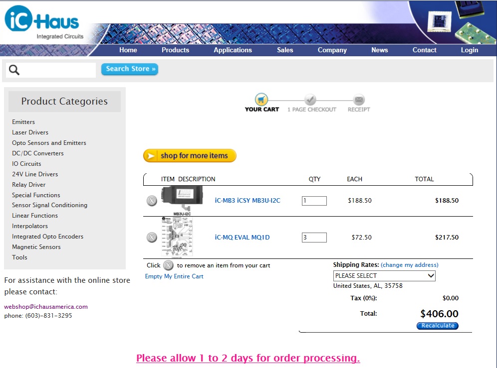

I have been reasearching the iC-MQ EVAL MQ1D and iC-MB3 iCSY MB3U-I2C USB adapter. The adapter is expensive!

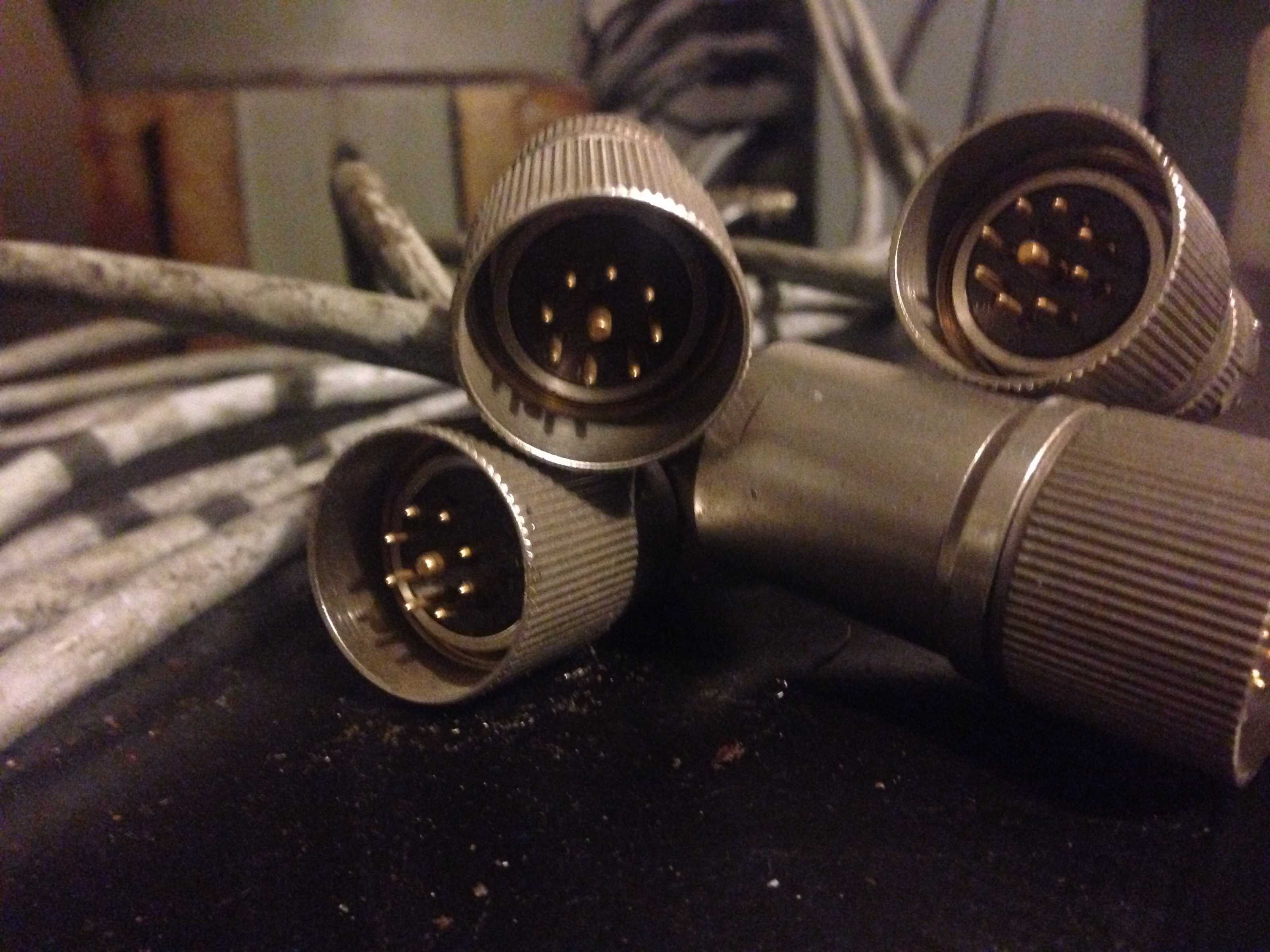

Andy, the encoders terminate in 9 pin male plugs. I'm considering the exe boxes at the moment.
Most of my connections to the TCN-151 controller was cut. Not much of a bad deal. Also one of my encoder cables were cut. I can just shorten and install to the servo, I have plenty of slack.

Andy, the encoders terminate in 9 pin female plugs. I'm considering the exe boxes at the moment.
The encoders look like they will plug straight in to those EXE boxes that you bought and then cancelled.
So that just leaves the puzzle of finding connectors for the outputs, which Mouser seem to sell at a reasonable price.

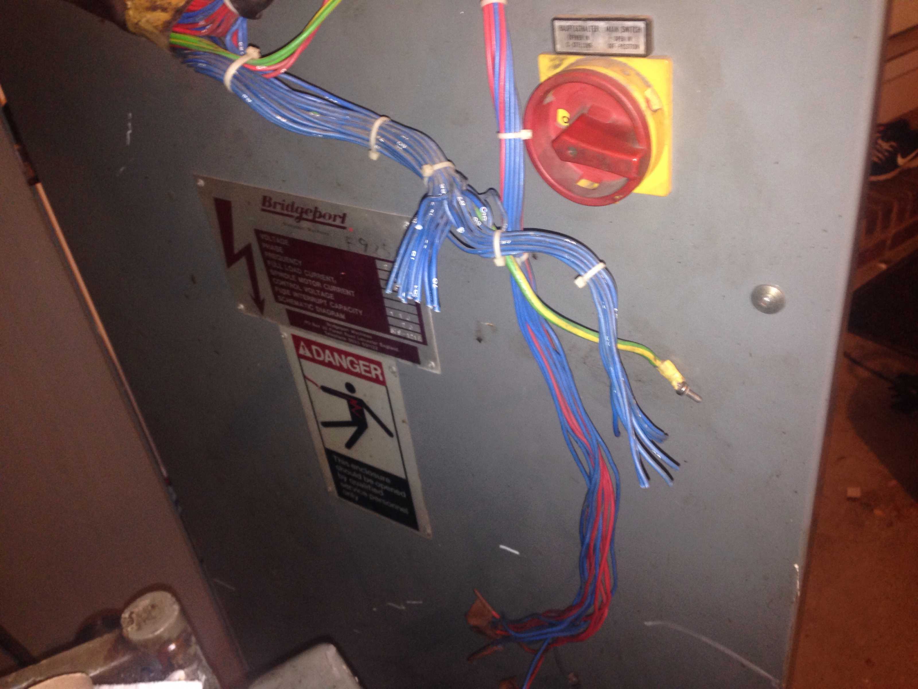

In accordance with the schematic I checked 0v line and my 380v line and received around 350v. My L2 (#112) is connected to 210v on the T2 transformer. (Was wired previously for 210 3ph).(I need to move it to the 220) I had to actuate 5FC relay manually to get the power to T2. I haven't figured out what signal to actuate it yet.
Now the bad news. I blew a resistor in my control cabinet upon first actuation of 5FC. (Scared the **** out of me!)
Attached is the resistor I'm currently trying to figure out what it goes to. I think power is heading toward my z axis limit switch wiring. (I had one disconnected and grounded) I think it was a 3R3 prior to me destroying it. But that is from memory.
I'm a child playing pilot in an Airbus here!
Alright. Traced it down to R7, #169 and #7. Guess I took out the z axis power resistor. Now to find a replacement. I think I found the short. I'm at fault. I had the wires hanging from the encoder box but failed to ensure one wasn't grounded. :doh:
Maybe someone should take this machine from me before I destroy it! ;)
