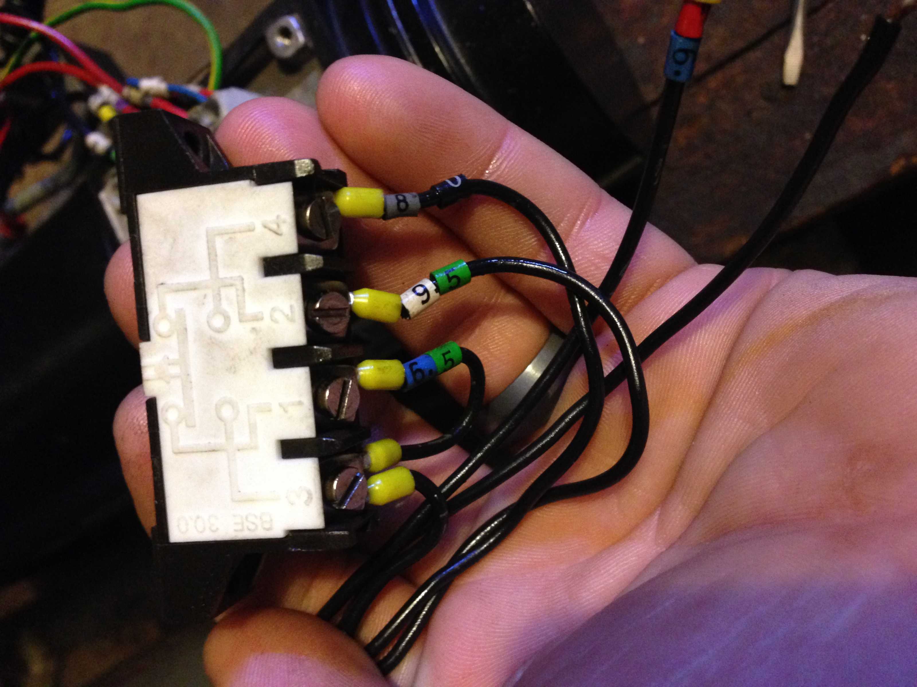

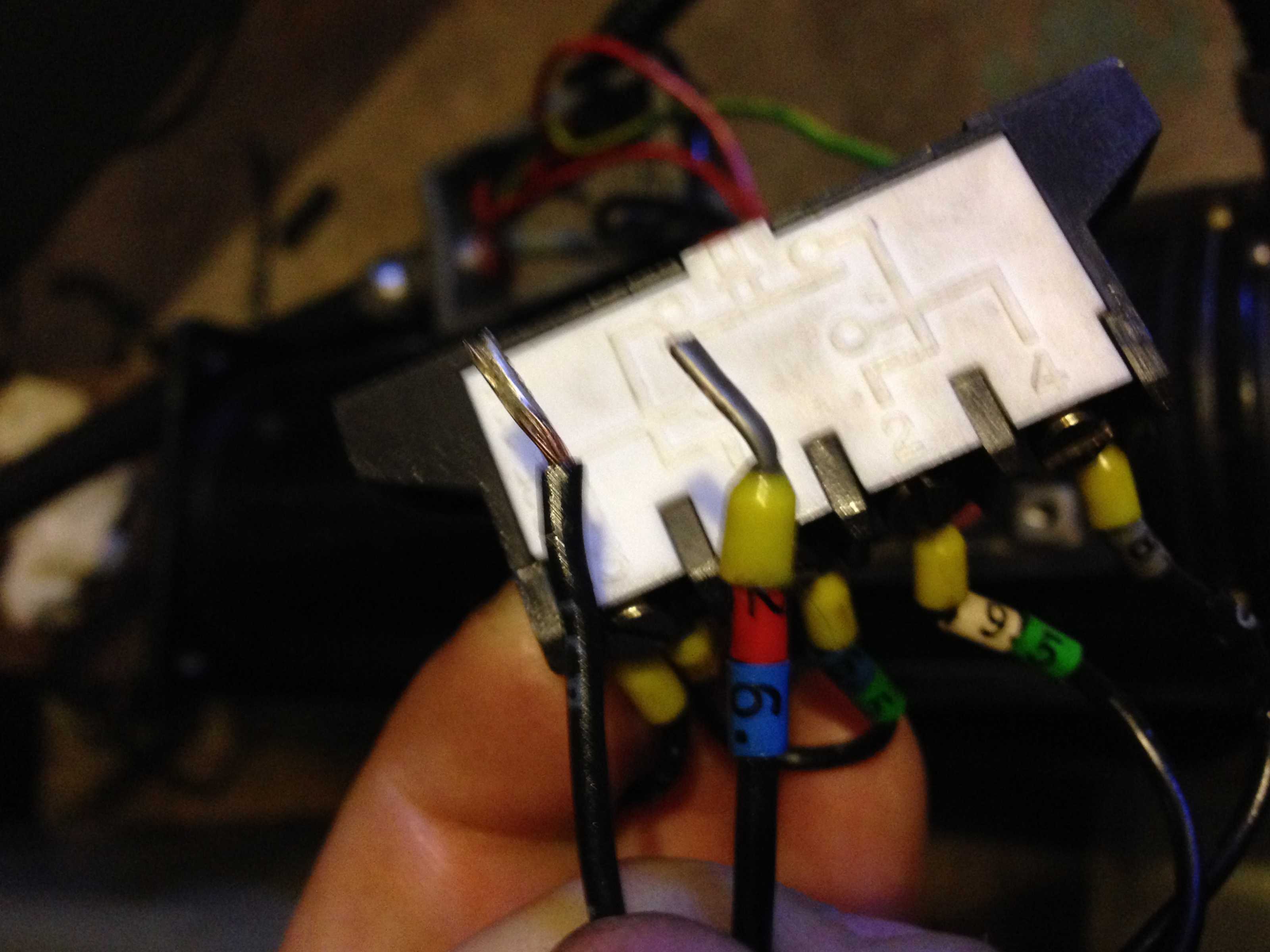

But now I have a more immediate issue.
I just ran 120v to my 24v system!
Blowing my resistor on my "bread board" and taking out my CFU1 fuse, good thing those blew, but I might have taken out a 24v relay or two. Not sure yet.
My "y" axis limit switch was partially dissembled. Wire# 26, and a unmarked wire going to my "z" axis upper limit switch, Those two had 120v. I HAVE not made any changes on this limit switch since I received this machine. The way I connected these wires was to #26 to 95 and the unmarked [#25?] to 65. [Limit switch pin 1 and 2] I guess you can now say I know I was wrong
Im guessing I had 24v going through wire #95. And the way the switch is wired I did not realize I had 24v on the other side of the switch. I need 110v to pass through my limits for the joystick. I tested this by just connecting my #26 and the unmarked wire together. Voltmeter had 120v on each wire, prior to me connecting them. (I had my enable on a on/off switch) after connecting them I could "turn off my enable switch" and use it as a momentary switch as designed.
I was correct that it was what I needed. However I screwed up my wiring in my "y" limit switch box.
I sure could use the help figuring this wiring out of my limit switch.
Here are some attached photos.

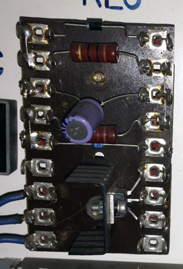

I removed the blown resistor located on the 2nd leg from the top. Anyone can you tell what size it is? Looks gold, black, black, brown. I'll check the tables for the 4 banded resistors and see if it makes sense. [Edit: its a 10 Ohms 5%, Watt's unknown] suggestions?]
The lower wire #65 is where i ran my wire out. I made the mistake of not disconnecting it first. Perhaps I missed something, or I was connected elsewhere. I'm going to disconnect it an try to ring it again, to figure out the unmarked wire number.
I attached a highlighted wiring diagram of what I blew and connected. "blown.pdf"

- Posts: 19893
- Thank you received: 4648
02 Jan 2016 04:31 #67685
Well, given that resistor cost is minimal, just assume it dissipates all it can at the applied voltage.
P = V2/R
So, 120V = 1.4kW
24V = 60W
OK, so don't assume that
It looks like a 5W, but if you can read the bands it might be OK.

In your first picture Terminals 1 and 2 are normally closed contacts and terminals 3 and 4 are normally open. Wire 65 should be common since it's jumpered and wires 95 and 80 would be your signal wires all should carry 24v. These are home switches right? You should have 2 more switches on other axis with wires 94 and 79 and another switch with wires 96 and 81.
The schematic suggests you should have limit switches where wires 23,25, 26, 123, and 27 would be connected carrying 120v signal. There should be 1 limit switch for the x and one for the y axis and 2 on the z axis, in addition to a home switch for each axis. Is this correct? If you don't have limit and home switches on each axis you'll need to figure out what you do have and redraw the schematic. Given this configuration there is no way to use the limit switches as home switches or vice versa without changing some IO hardware
