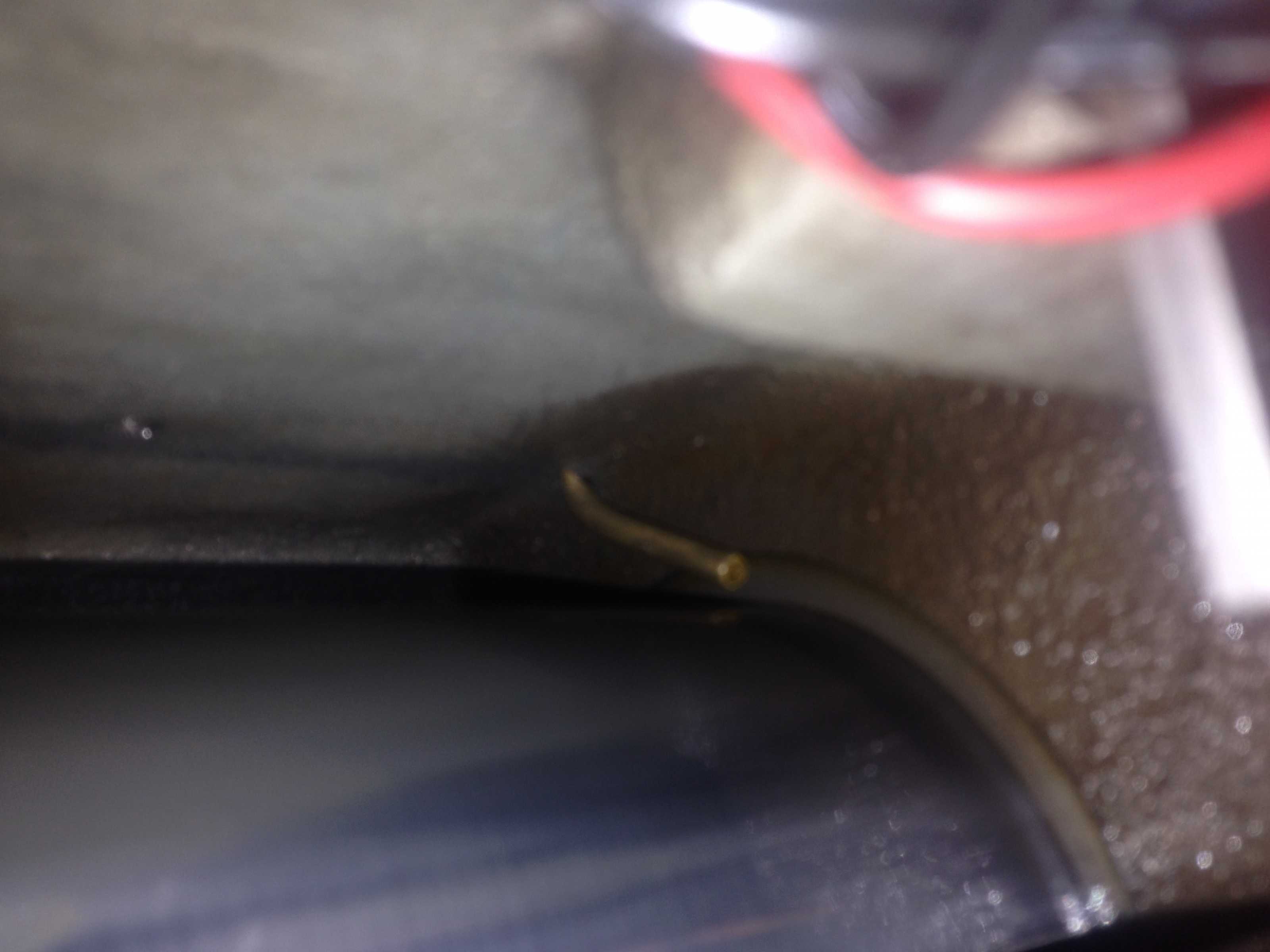

I've got my mill thinking it's running all day long. Just to check out the oiling system. The saddle, table and knee are all pouring oil (after 12hrs), but the head does not seem to be getting a lot of oil.
I've attached a photo of the lower oiler for the quill. I maybe have had a few drop. I don't know if this is normal or what. The orifice for it is a 00. Does that sound sufficient to you?
Last edit: 21 Dec 2015 01:35 by cncnoob1979.
21 Dec 2015 10:10 #67195
I have never had a machine with central oiling, so I can only speculate. But 00 sounds like it would be the smallest of all.
Perhaps they wanted to make sure that oil didn't drop on the workpiece?

21 Dec 2015 17:00 #67212
by cncnoob1979
Replied by cncnoob1979 on topic Planning - Bridgeport Interact 1 linuxCNC Retrofit
Andy,
I think I will be disassembling the oil lines, remove the table etc.. and check each oil orifice.

22 Dec 2015 13:06 - 22 Dec 2015 13:07 #67237
by BigJohnT
Replied by BigJohnT on topic Planning - Bridgeport Interact 1 linuxCNC Retrofit
The metering valves for the oiler can plug up with time, I had to replace all of them on my surface grinder to get the central oiler working. I would replace the metering valve with the same number if you suspect it is plugged up. If you have another metering valve with the same number swap them to see if that changes the volume of oil. Just because I don't use the grinder much any time I'm near by I give the plunger a pull to keep fresh oil in the metering valves.
