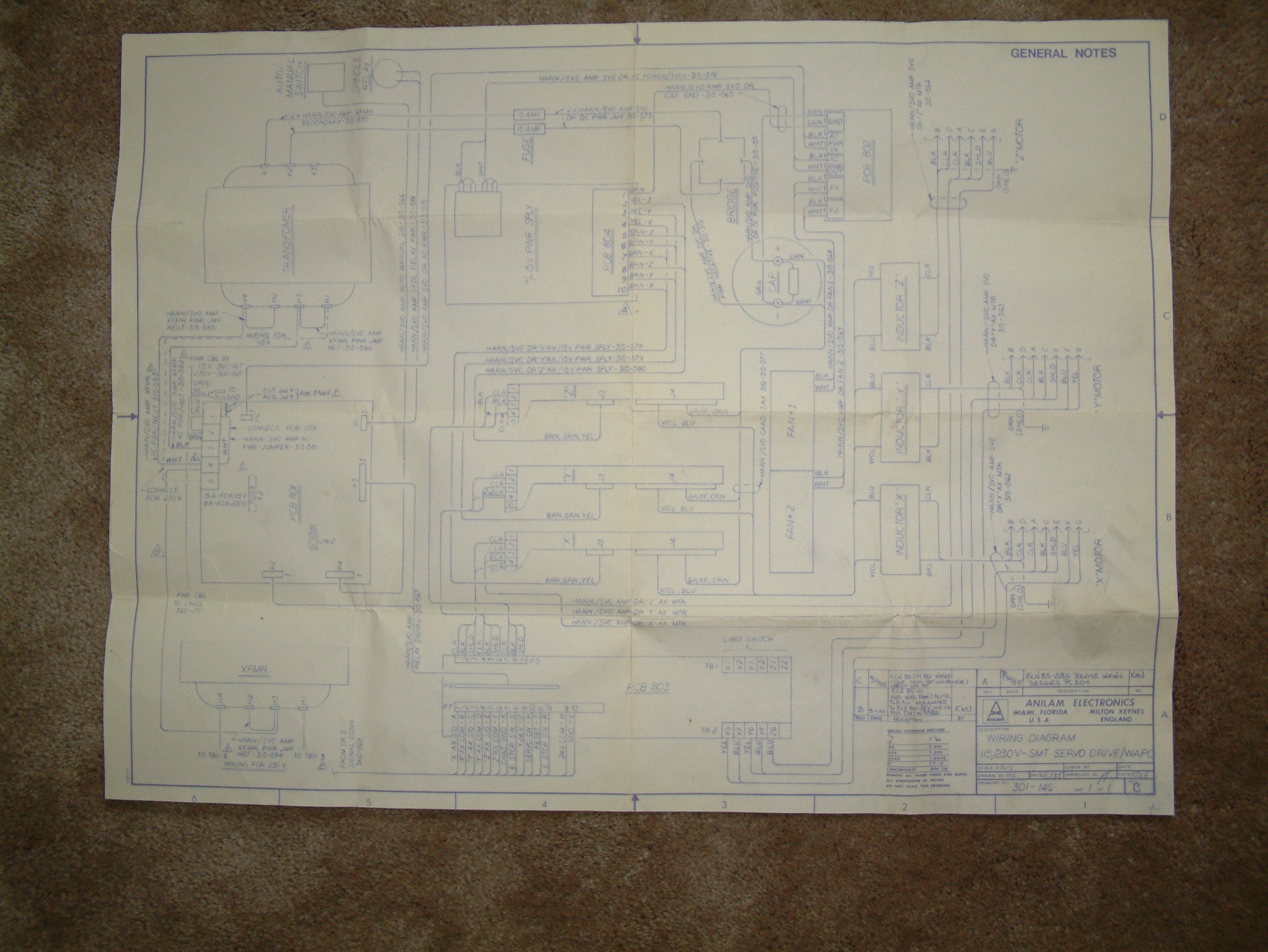

Yes after looking at the ebay item closer it appears to be for a automotive application and trying to power it with the output from the ATA power supply it may not get whatever is required for this circuit.
As far as the limit switches voltage requirements they should do fine 24 volts as the Z axis uses ones like THIS and the X & Y use plunger types like THESE .

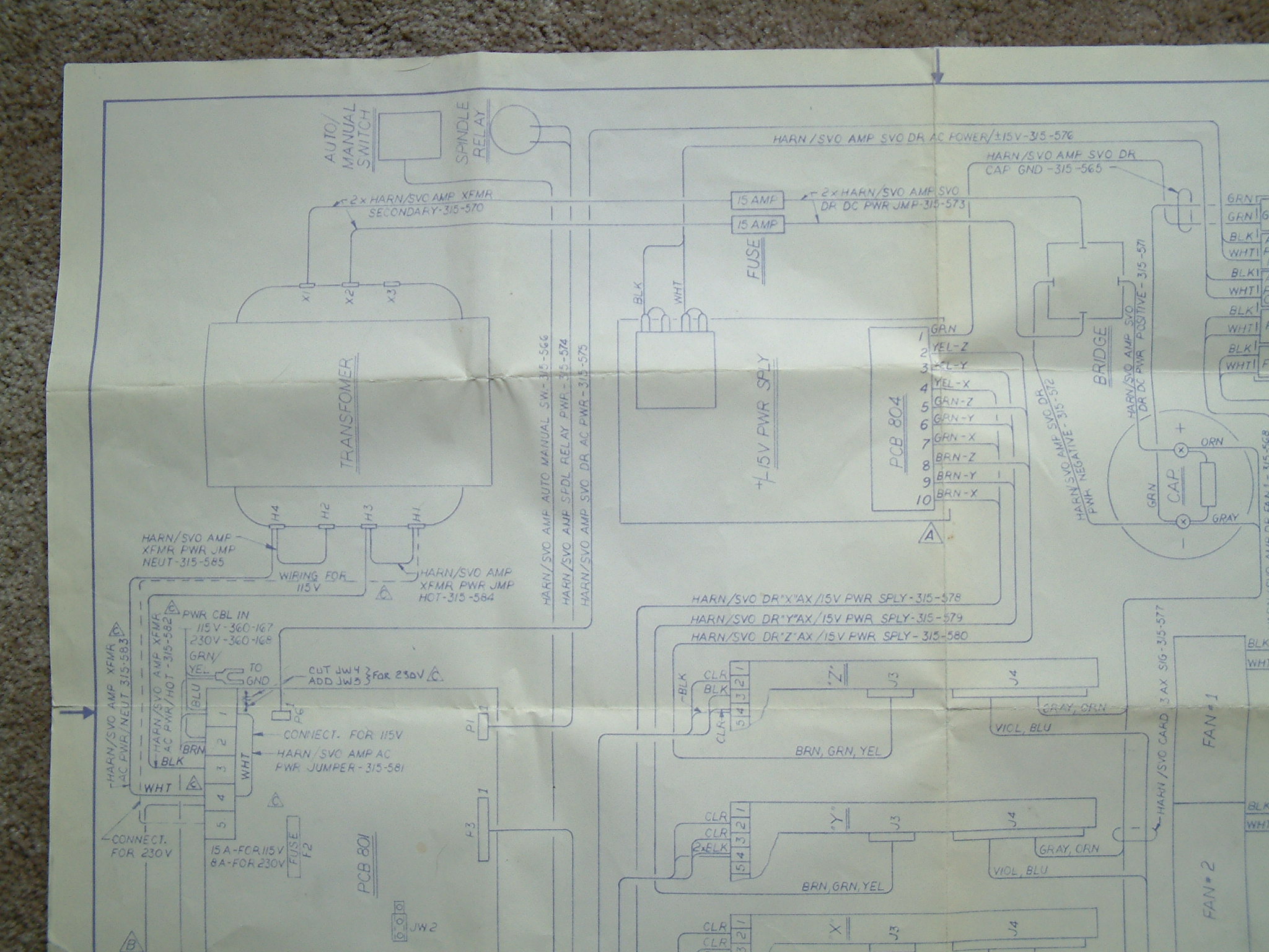

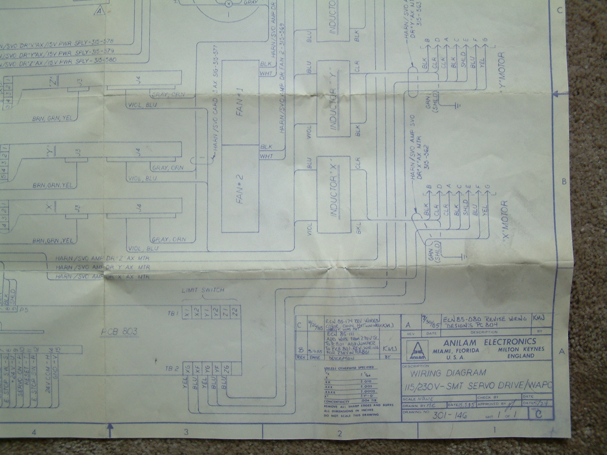

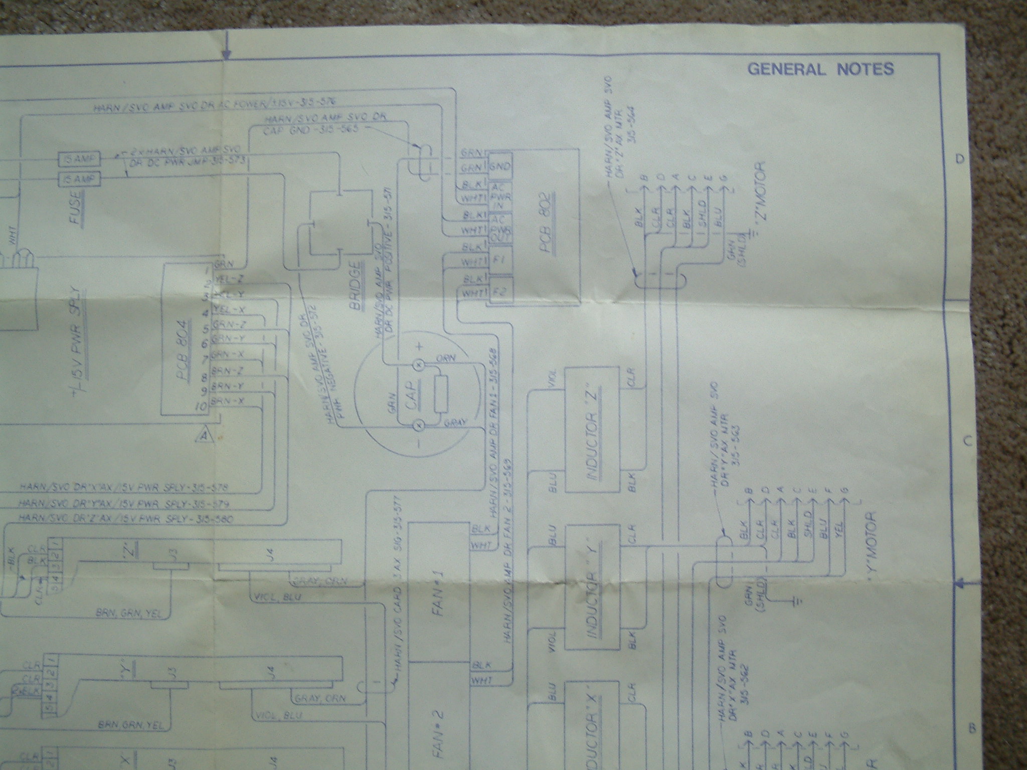

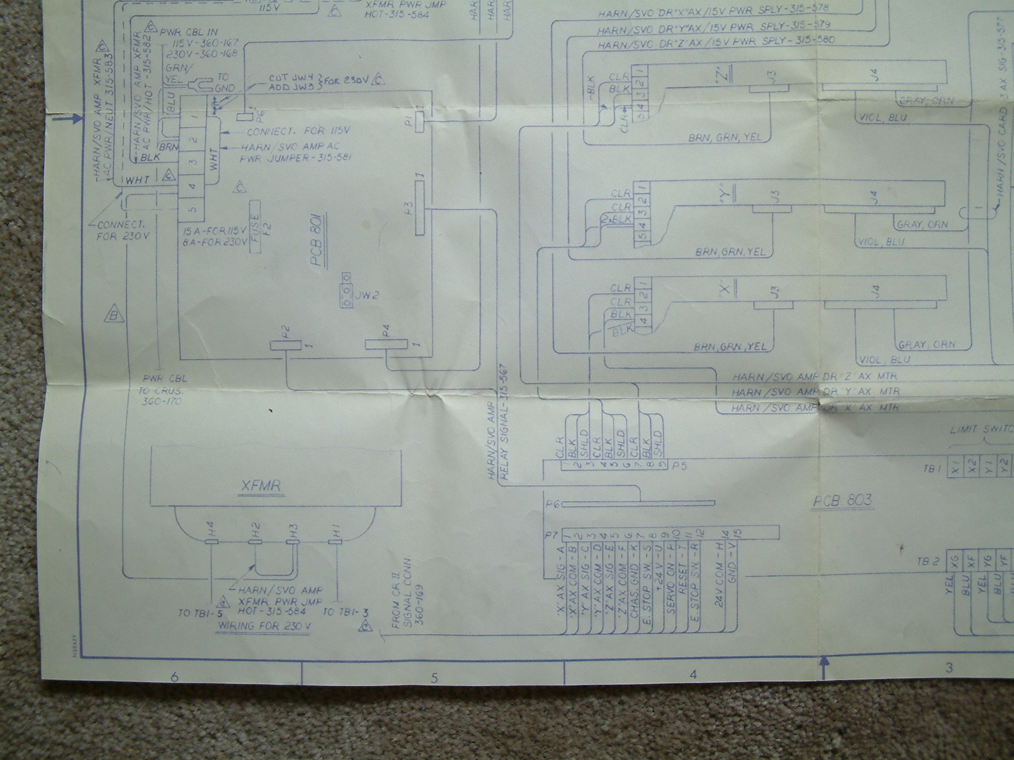

On your sketch, upper circuit, I believe that the contactor may already exist on the on the PCB 801. You can see it below in the attached photo #0002.jpg. photo 5 is the whole schematic and the others are closer shots of each corner.
Jim

As far as the contactor on your board, you're now at a point where you need to make a decision on what you want to do. Your schematics look similar to my Anilam Crusader M and I had a board w/ 3 relays on it, but the problem was that the Anilam circuit board was powered 'backwards' for the outputs from the 7i77, ie the 7i77 output sources 24vdc and the Anilam circuit board was setup to sink 24vdc. For me, I simply didn't use two of the relays and wired one 'backwards' so that I could use the sourcing 24vdc output from the 7i77. If that makes sense... I wired in the relay to turn-on the servo amplifiers and left the others disconnected. For my estop, I wired in a safety relay and contactor, but the latching circuit I drew would work fine as well.
Mark

I believe the 801 board has (2) relays on it.
Your M controller was the next version after my crusader II controller.
Looks like I need to learn how to chase down how my circuit works.
