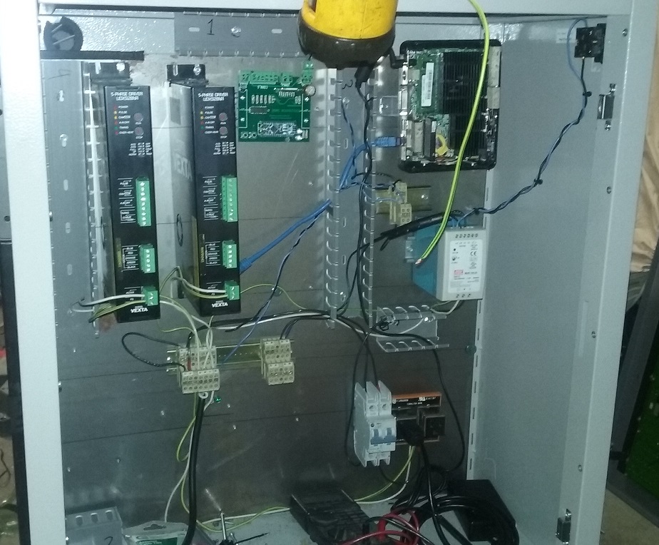

ran most of the power wires today. It looks a mess but I will jacket all of the loose runs that are there now. Removed the big contactor and stole the piece of din rail to mount the 3amp double pole breaker and the outlet which arrived yesterday this let me wire the 24vdc psu and the computer, which I also mounted using a short piece of 1x1 aluminum tube. I need to make a mount for the mesa board, and then figure out all of the control wires. I have a 240V plug coming but I will still need to wire an outlet in the garage for 4 wire and get an extension cord to go from the wall outlet to the lathe plug. Still lots to do. I also need to wait for the encoder plug and make that wire, along with a shaft adapter and modified mount.

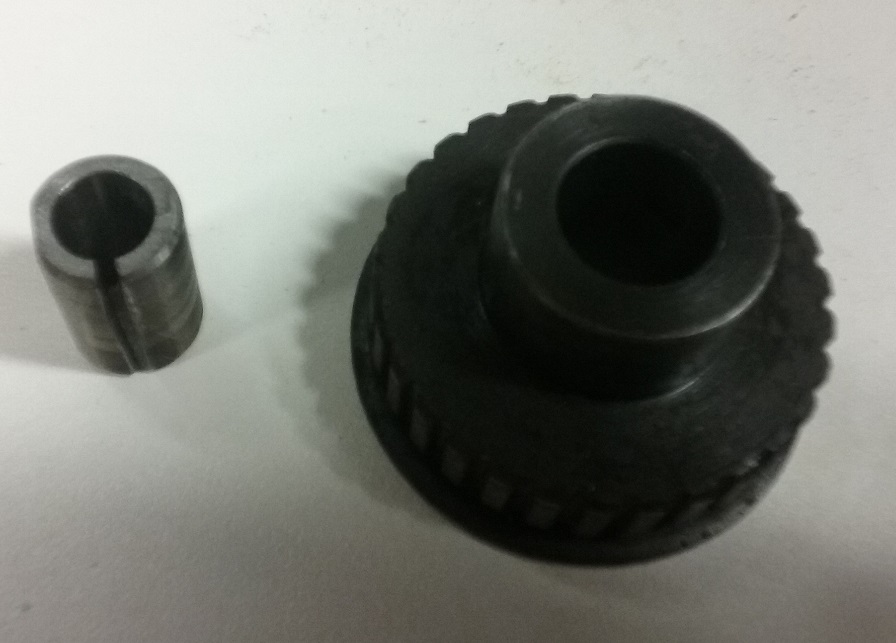

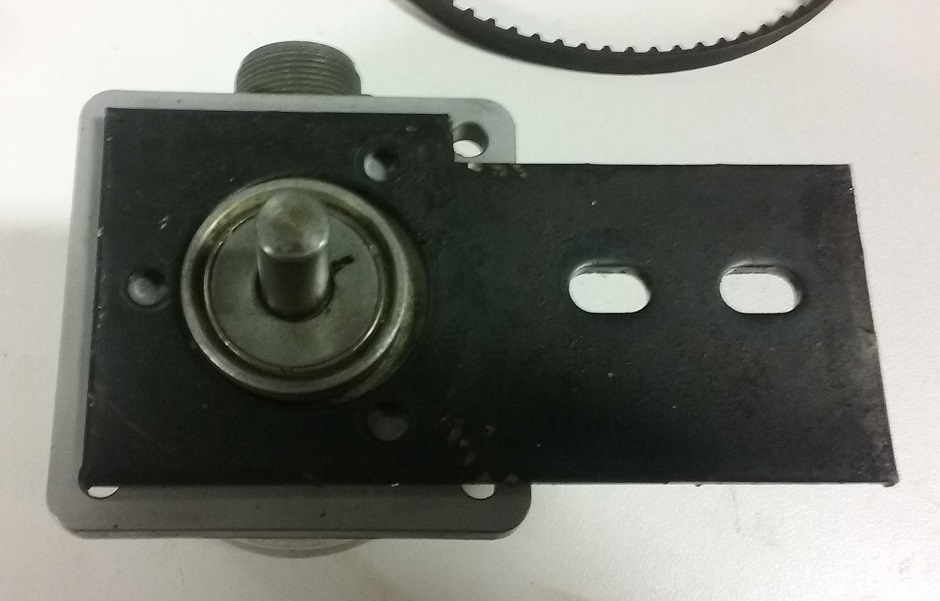

Sunday I made a shaft adapter. since the difference is not enough to put in a set screw I just ended up splitting it to use the pulley set screw for both diameters. this doesn't have a lot of torque on it so it should be fine. The mounting bracket will have to be remade. Im looking for a decent shareware 2D cad package so I can do this at home, I can do it in Solidworks or Pro/E Creo at work but at home I'm limited to Cambam which I don't like very much as a drawing package.

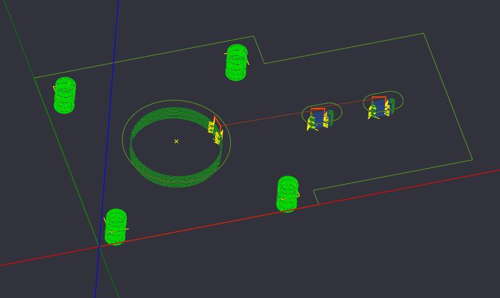

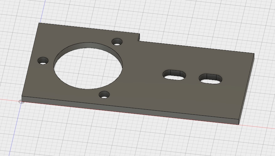

thanx Ill check that out. So far I downloaded one from dessalt ( maker of solidworks it was terrible), and also LibreCad which is similarly bad.
EDIT: yeah this isnt too bad. took me about an hour to do this, would have been a couple minutes in SW but theres a learning curve. It looks pretty much exactly what I was wanting for a home CAD software. Thanx again
MODIFIED
DXF out to CamBam
