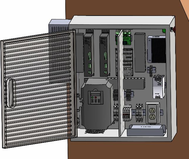

OK thanx, Ill see if the dims I got are correct once I get the physical part. The 3D model shown is 14x7x5 inches, so it is quite large.
- LutzTD
- Posts: 216
24 Jun 2016 09:40 #76569
by LutzTD
Replied by LutzTD on topic Emcoturn 120 lathe retrofit

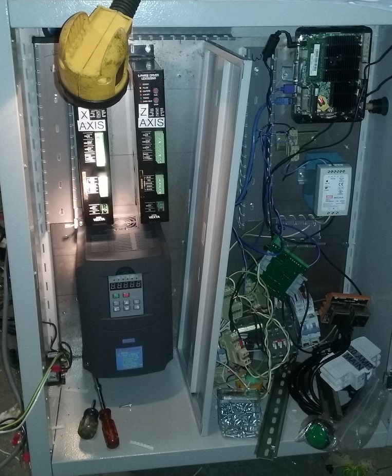

the VFD is causing quite a shakup. heres the 3D and the real (now a mess)
Im going to add a wall so I can move the toolerator and the mesa card onto the wall for added space. I will likely pack all the 35mm DIN parts on one DIN rail now too. I may have to scrap the emco contacts for some that will fit on 35mm DIN rail as well to compress everything.
- Posts: 19908
- Thank you received: 4659
24 Jun 2016 10:09 #76574
Replied by andypugh on topic Emcoturn 120 lathe retrofit
You could mount stuff on the door, possibly.
Or maybe mount the VFD on the motor.

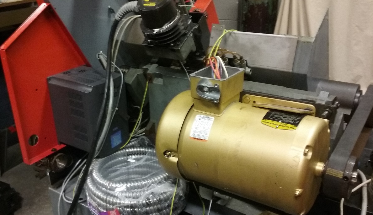

- LutzTD
- Posts: 216
24 Jun 2016 10:20 - 24 Jun 2016 10:20 #76579
by LutzTD
I plan to investigate this over the weekend, this will not only move the VFD, but the 2 reactors and the emi filter. Maybe even the brake.

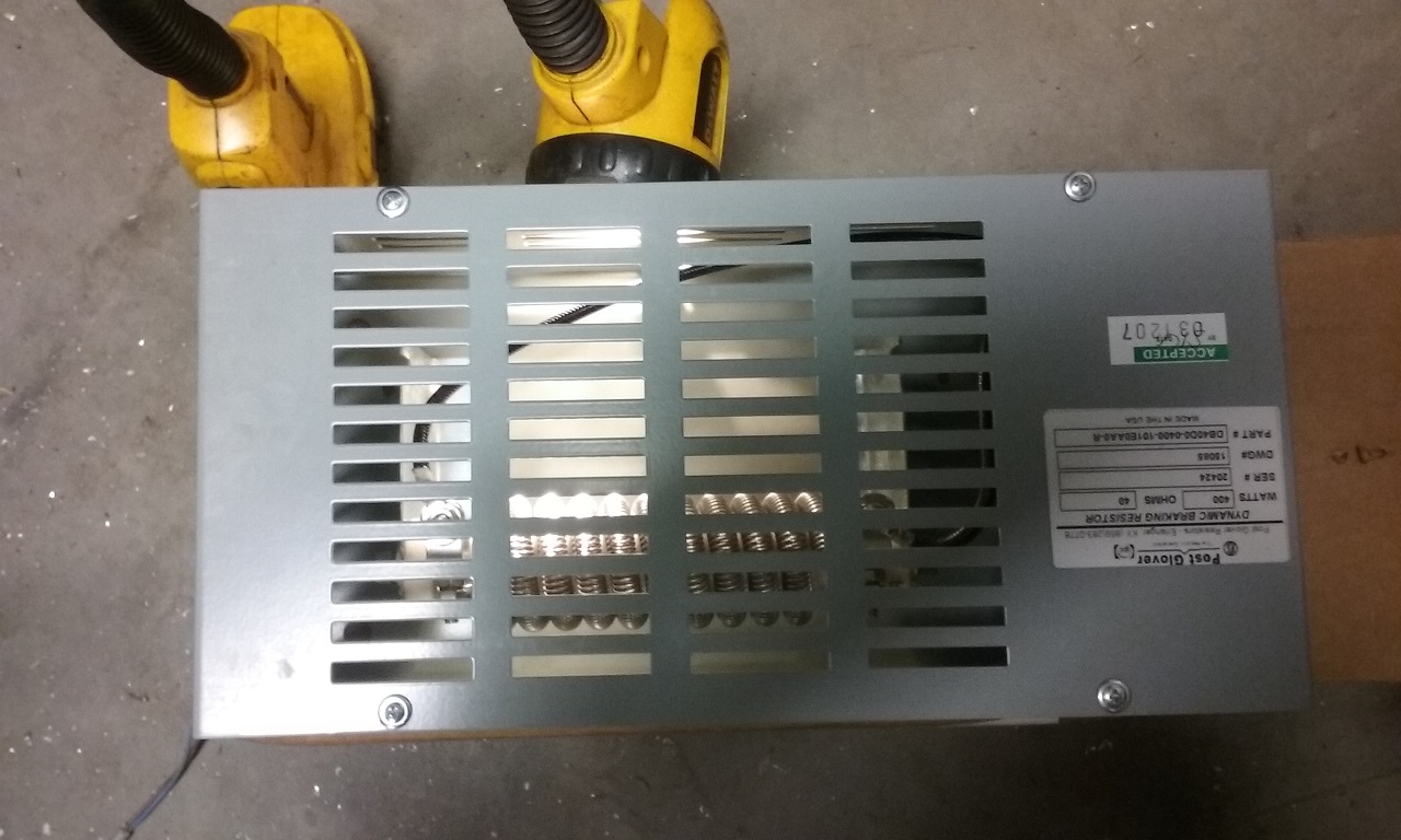

looks like we are both right. the box is huge just like I found in the specification but the resistor is small and only a fraction of the inside of the enclosure as you thought
If that is the brake resistor on the left of the view it looks massively oversized. It doesn't have to be continuously rated.

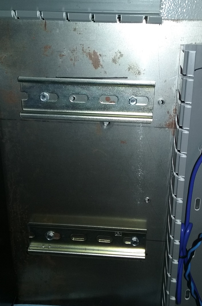

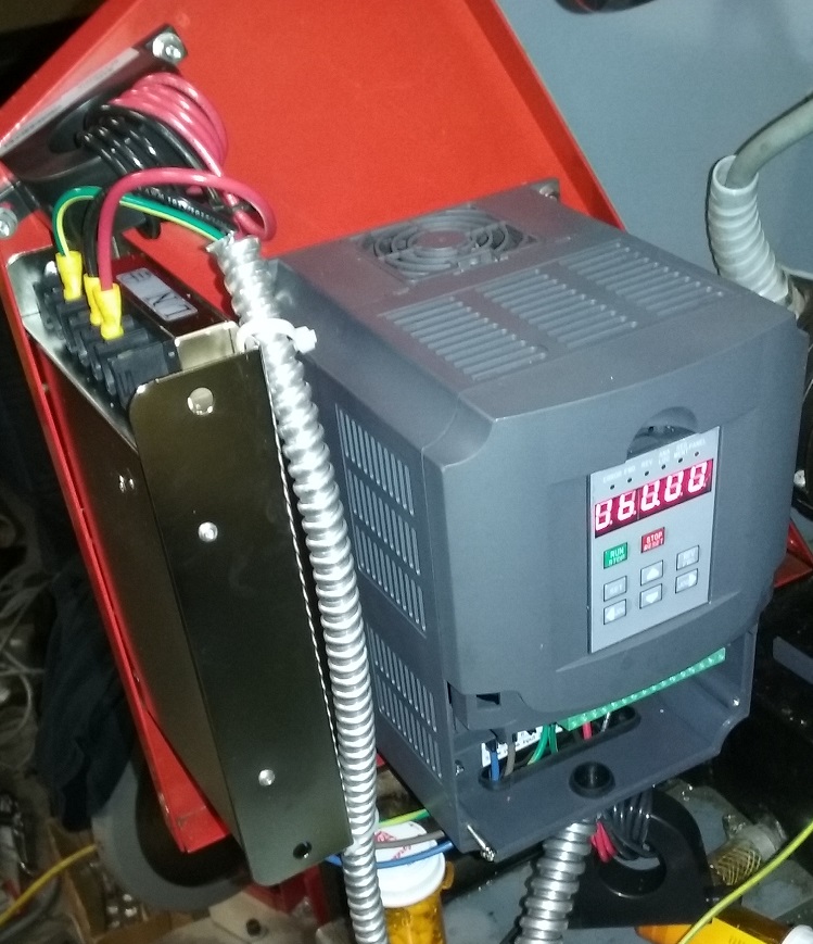

looks like moving the VFD to the back of the lathe main enclosure is the best idea. I will attach it half way up this panel and fabricate a splash shield to be doubly sure the coolant cant make it into the VFD. Makes the control enclosure layout much cleaner and less crowded as well. Ignore the spaghetti wires those are pulled and laying about from the old layout.

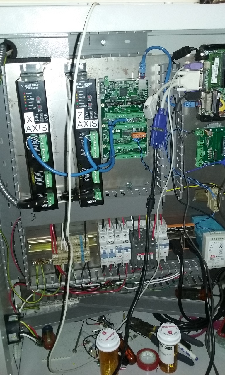

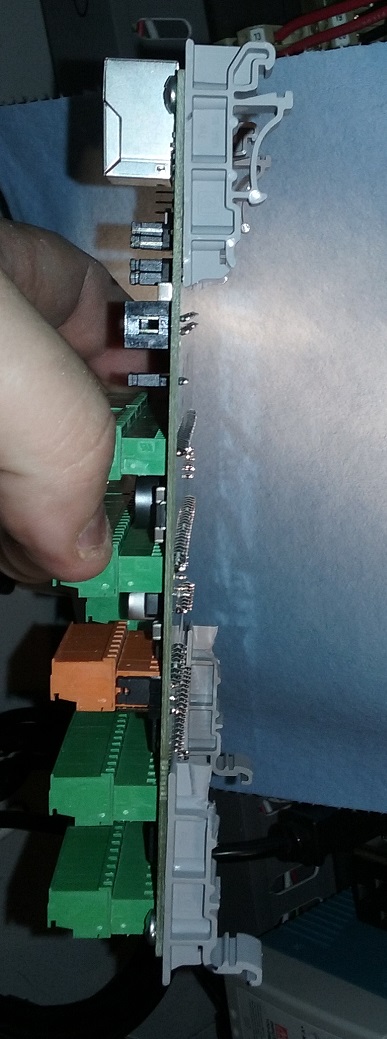

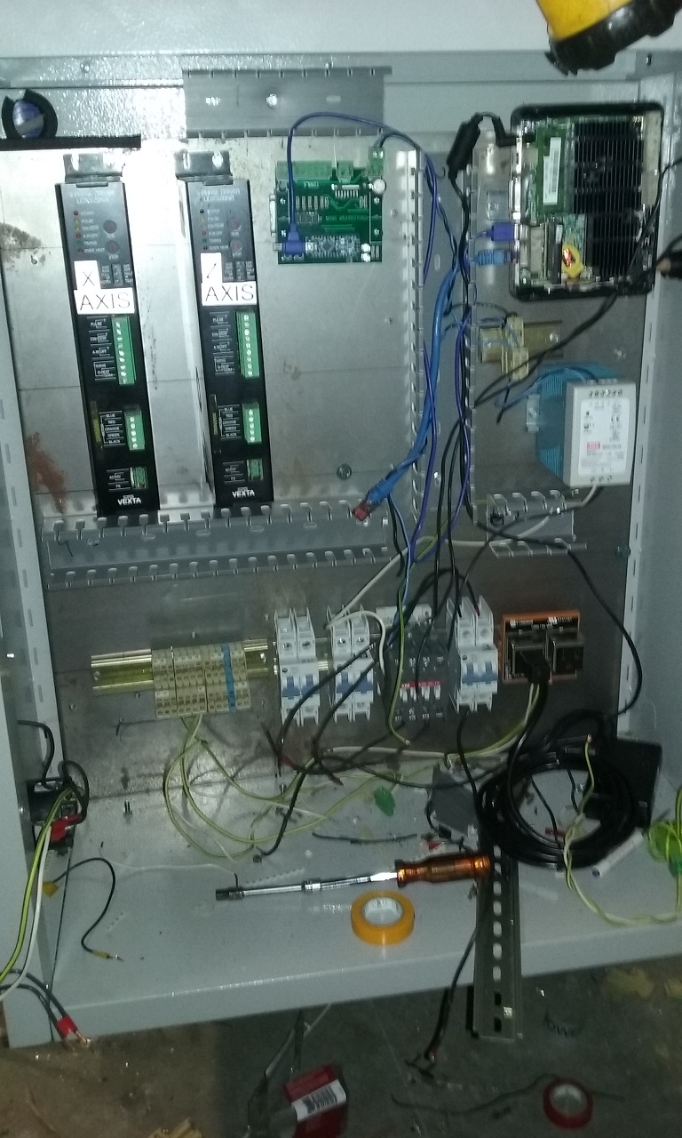

haven't posted for a while. The shake up with the gigantic VFD is pretty much settled. The VFD was moved to the inside wall of the right side rear panel. Along with the VFD the EMI filter and 2 phase reactors also were relocated. I didnt have sleeves for the flex conduit but will add them. This made the control cabinet a lot more efficient. The Mesa 7i76e PCB mounting was done by using the pheonix snap stands, I cut the snap from 2 and the clip form 2 and put them top and bottom using 2 din rails to snap it in place. I also received a few spools of 12awg and 16awg machine wire with correct colors so I also rewired and added some more wire duct. I relocated the 24vdc psu down to the din rail as well. I like this layout much better. I started running some of the control wires now that all of the power wires are pretty much done. I need to get the ethernet interface between the 7i75 and the Dell working. I will ask some more detailed questions in the next post. Next step is to get the spindle encoder working. Once that is working I can finish assembling the lathe cabinet.
