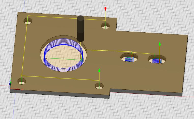

As a solidworks, pro/e Creo long time user I can see it has the typical issues with the low cost offerings. It isnt bad for small stuff but I see long term feature modification and some of the dissassociation of features as somewhat labor intensive in comparison. I will say at least that is much easier to manipulate then most of the free offerings I have tried. you can redimension a sketch and it modifies the model, but when I patterned a feature the pattern copies lost association and there was not a good way to copy feature that I found, but I have used it for about an hour so take this with that in mind. Also its not really fair to compare a free CAD package to two 5-7K offereings so on the flip side its really nice for a free offering and I was able to do a pretty easy job of making my plate, then making a copy and modifying it rather easy to the new shape. definitely better than a lot of packages out there, and the price is right. Its a keeper for me right now. I was also able to output DXF for the CAM program, looks like it outputs step, igs and others as well. Not too shabby.

The CAM is really very good. Fancy toolpaths and rapids at feed level.

If you look in the "Linking" tab of an operation you can select the amount of stay-down and how far it is allowed to move at feed height.

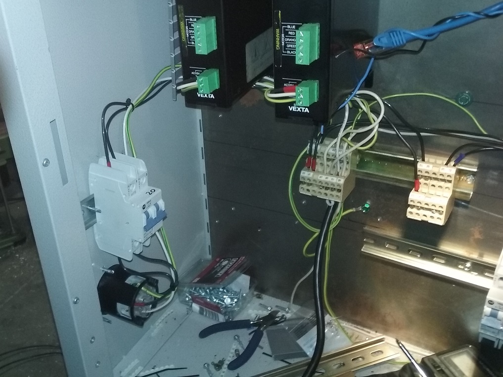

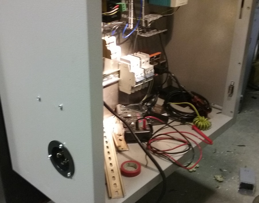

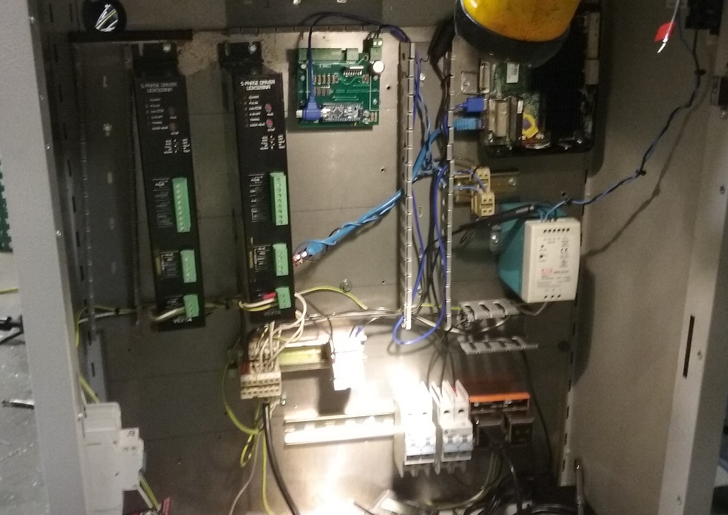

got a little more done last night. I got 5 packages of parts so I was able to do more on the power wiring. I added the inlet plug and the main breaker as well as mounting the new longer din rail for the 3A breaker and the 110vac power outlet. The tangle of commons and grounds at the power block will get re-cut in the future once everything is placed in its final spot. I also have wrap for most of the runs courtesy of the emco I will be adding at the end

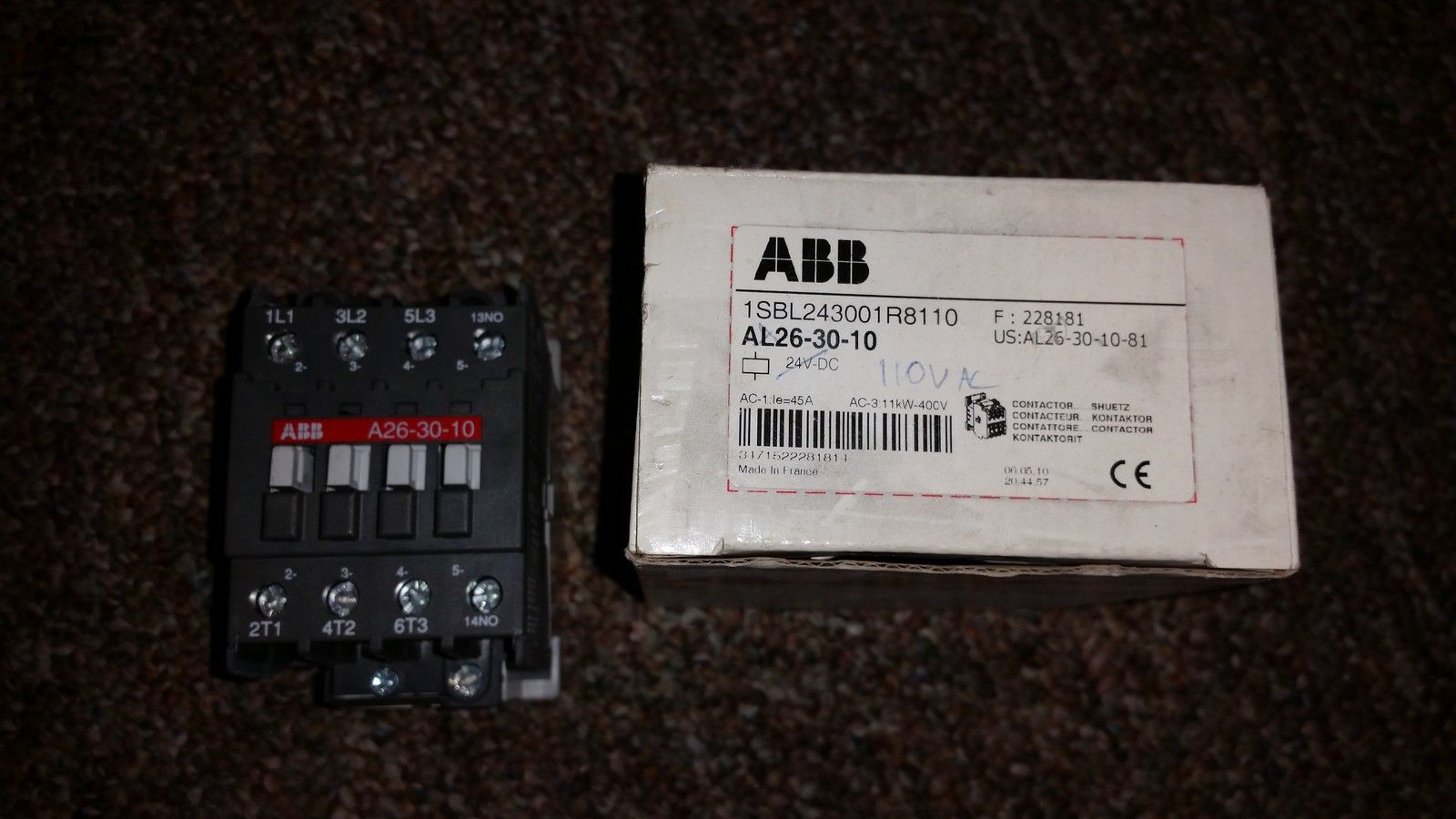

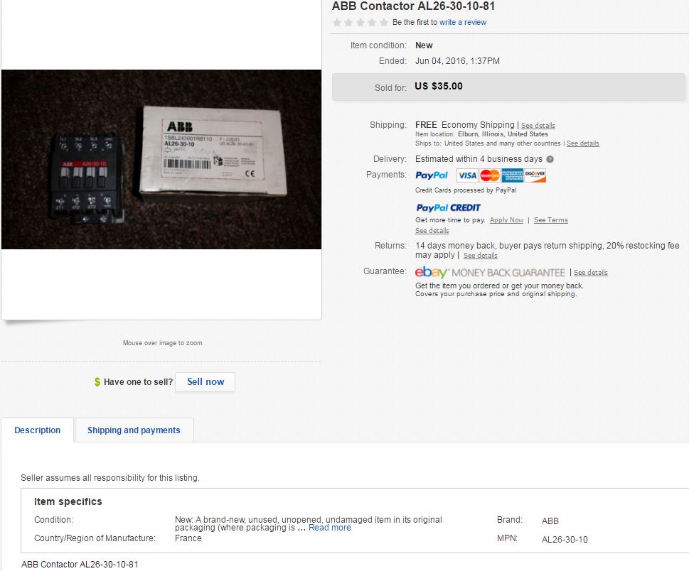

I won an Allen Bradley contactor from ebay, It was supposed to be a 24vdc coil version (A26-30-10-81) but much to my surprise the 24vdc on the label was crossed out and hand written 110VAC was on the box label. Its there in the picture now that I look, but all descriptions say its the r81 coil so I didnt look hard enough to see the hand written change on the label. Sure enough it is a 110VAC coil. A26-30-10-84) So, I rewired the stop switch to pull a 120V from the B leg and through the 3A circuit breaker and this works. It pulls .18A according to my meter so no biggy on power consumption, but the relay buzzes. If I do it one time its quiet, but if I actuate it a couple times in quick succession the buzz gets louder each time then sometime goes off. I dont know if this matters, but the buzz worries me that it will introduce noise in the line and emmitted. Is this normal for a contactor? Should I ask the seller to refund and send it back and get a 24VDC coil as I originally intended? I figured DC would be quieter, but this is just a guess.

I would be tempted to in your situation. the -81 suffix stated in the description and the title definitely means 24V DC, so what arrived isn't what was stated in the auction.
But, perhaps the 110V coil is useful, as it can operate without needing the 24V PSU to be working.
Replied by andypugh on topic Emcoturn 120 lathe retrofit
