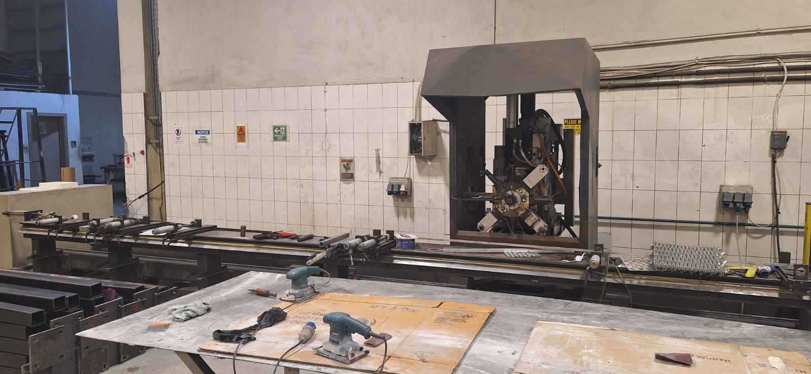

More pictures, inside the control boxes also.
This is absolutely a 3 axis machine mounted on a long linear axis, see my pictures, everything in white is that 3 axis machine, everything in gray is the long axis.
There are no resolvers on my machine, it has serial absolute encoders on all axis, grayscale coding and ac motor with clutch on the tool changer, pneumatic brakes on the long axis, electronic brake on the Z axis, 6450mm usable long axis, 300x300x300mm (not sure about Z) usable area on the mill. Oh yeah, it weights in at over 5 tones.
Has AC servo drive for spindle, DC servo drives for all axis.
Besides the Mesa boards, i added over 30 or 40 small relays on all outputs, should be in the pictures somewhere on the back side of the control box, used the existing drives and motors and encoders (thanks to PCW making custom firmware for me), existing e-stop loop <== this is very important not to mess with or rewire, etc etc.
In general, this is a very hard and very complicated job even for people with experience, so take it easy, read a lot, then read again and again, and when you think you can not figure anything = take two to three days of, go out for a coffee, chase some cats in the yard, throw some stones in the river, or whatever helps you relax, then when you start again = everything starts to fall in place and make sense and seem much, much easier.

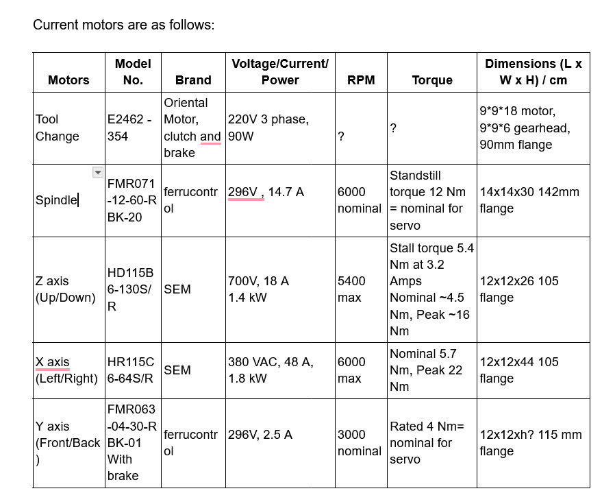

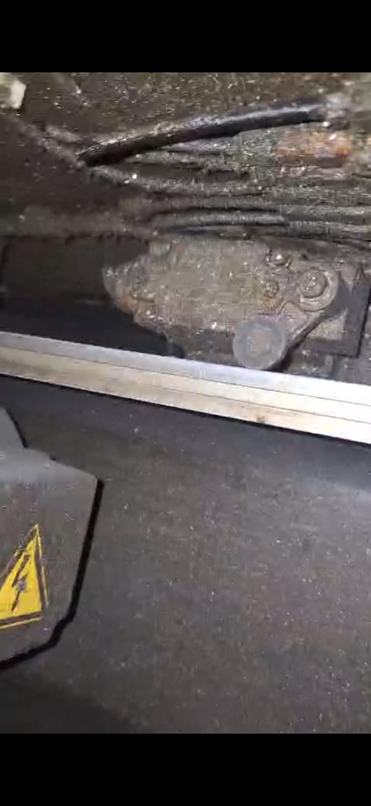

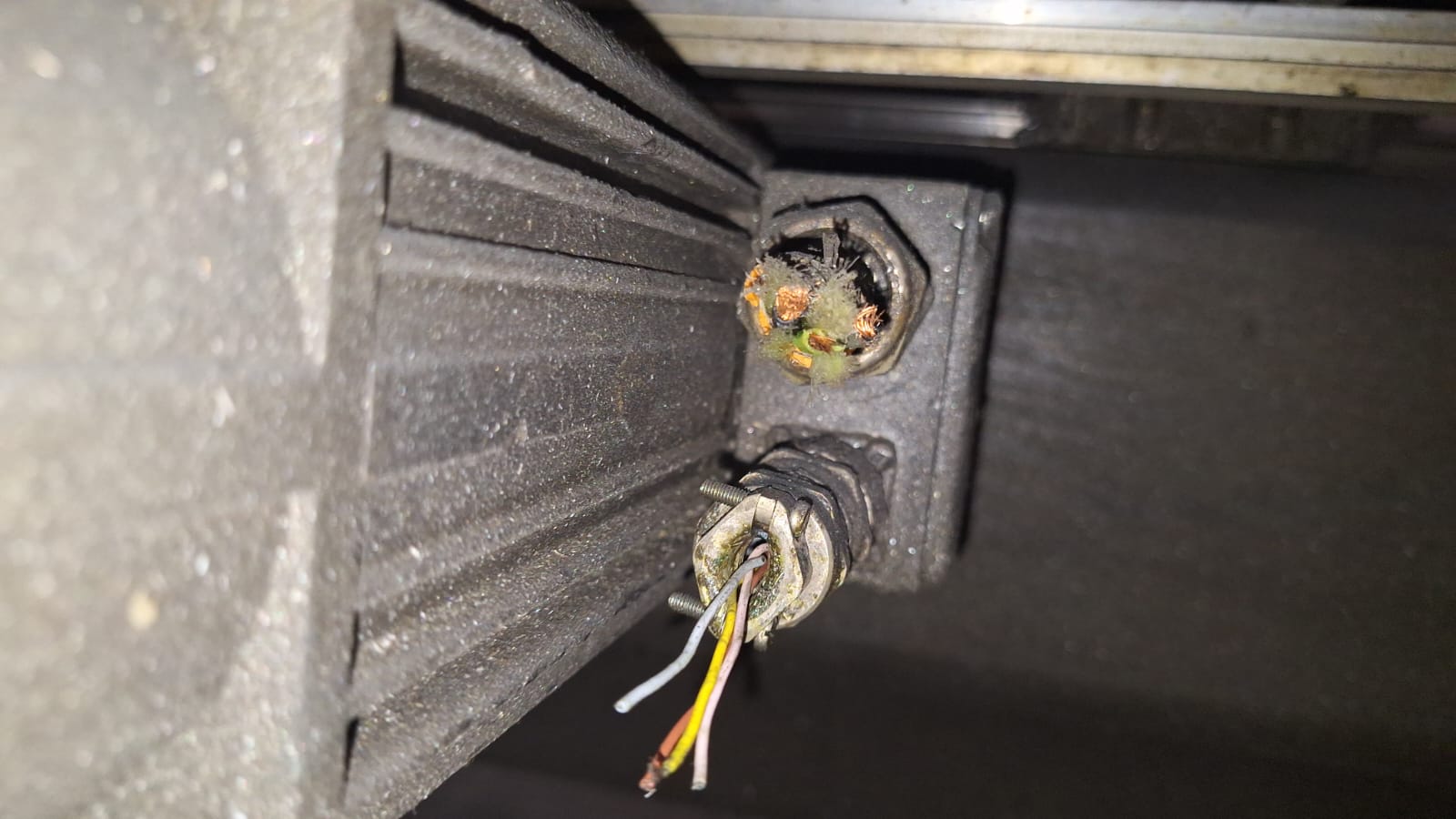

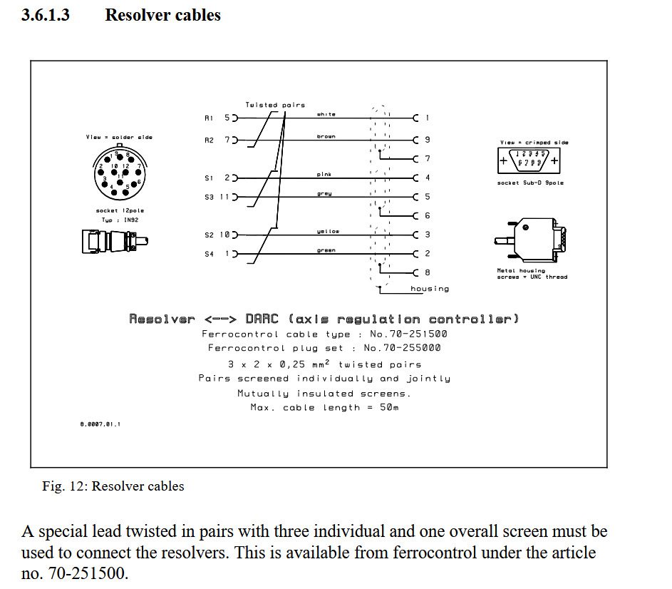

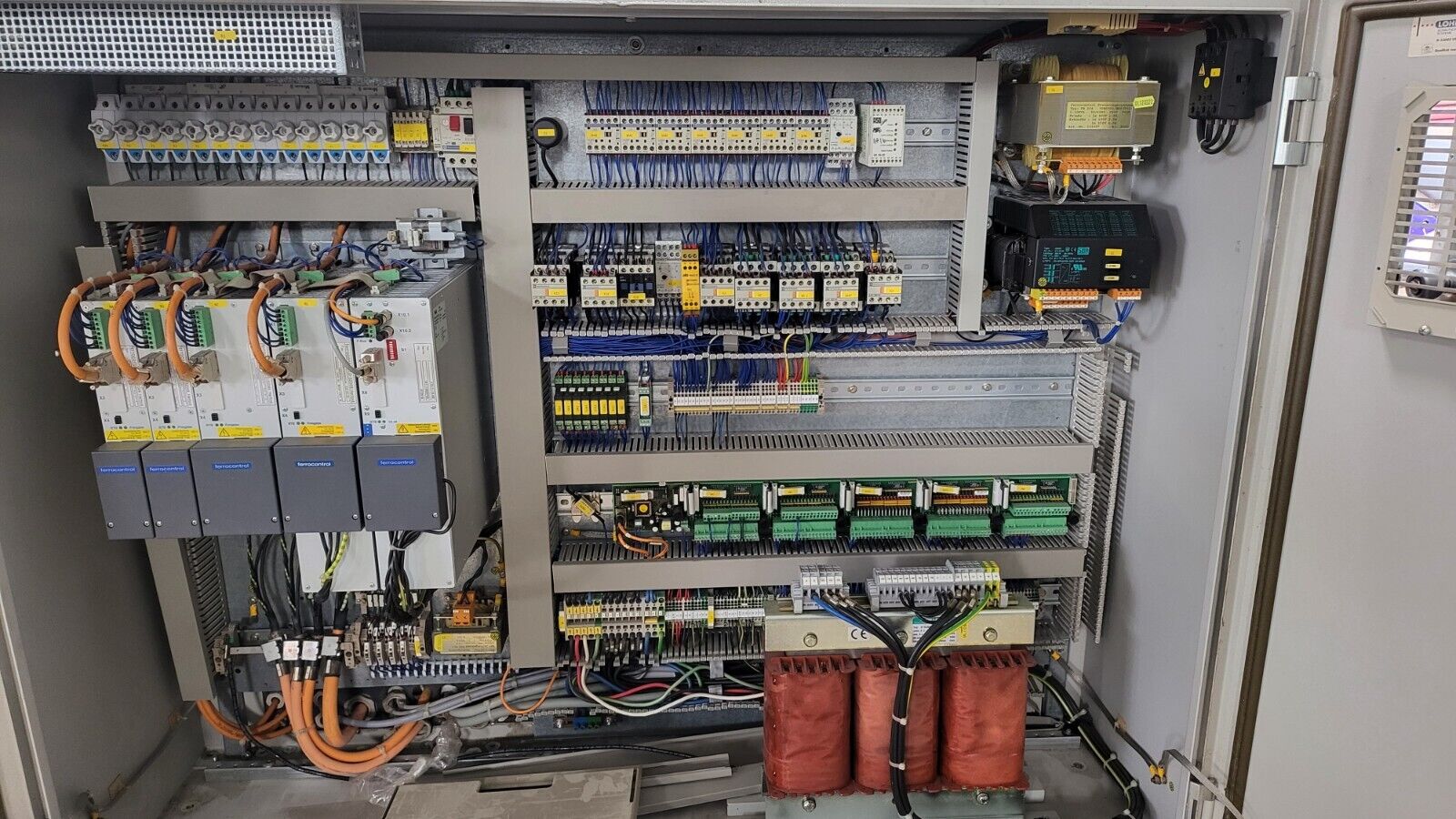

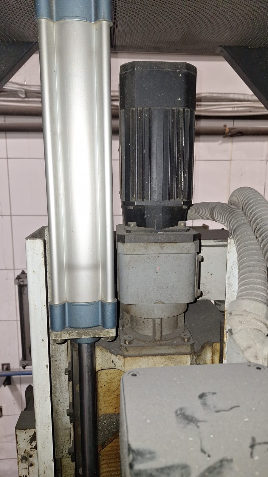

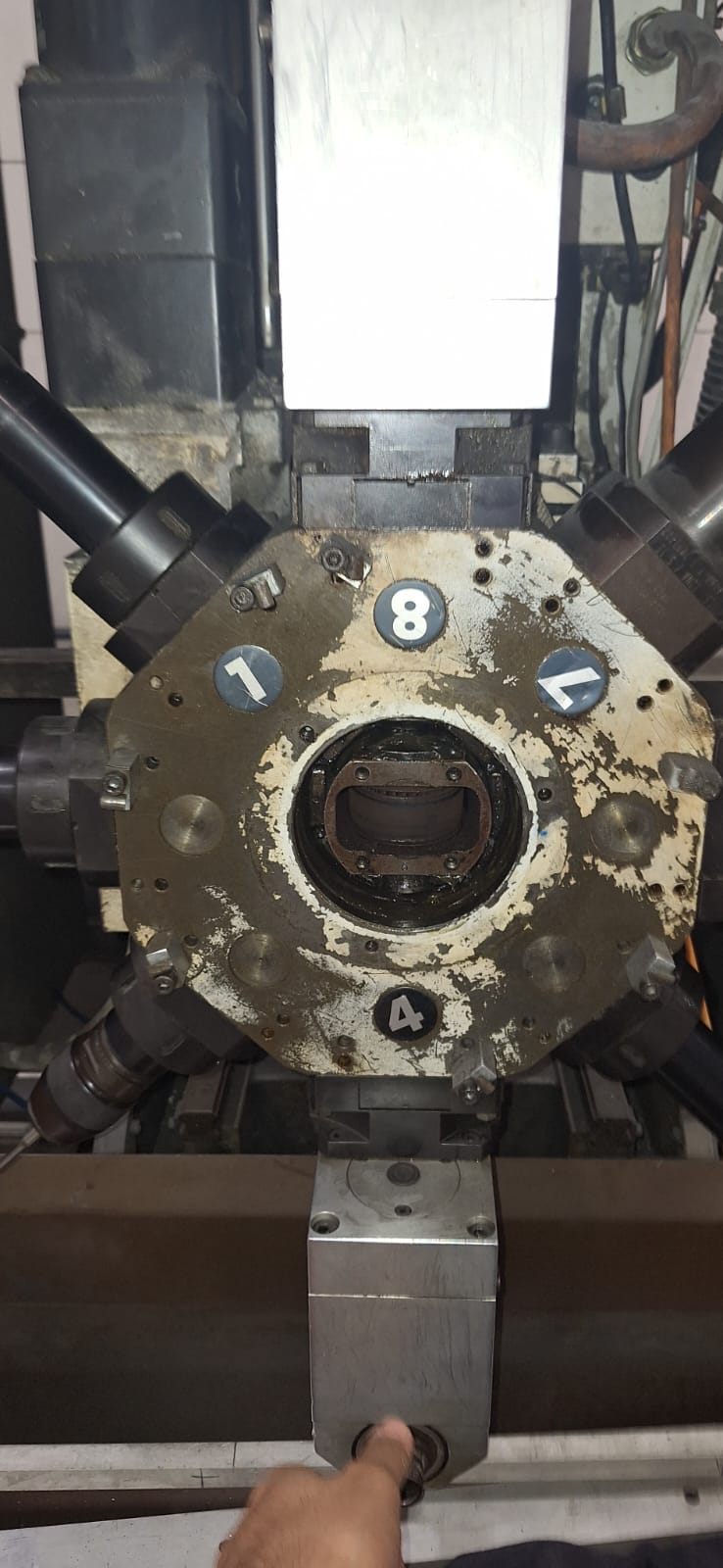

Thanks for the advice, Tommy.
After reviewing all the information exchanged so far, do you think it's a good idea to start a new thread about retrofitting our Sbz 130 model?
Basic differences include:

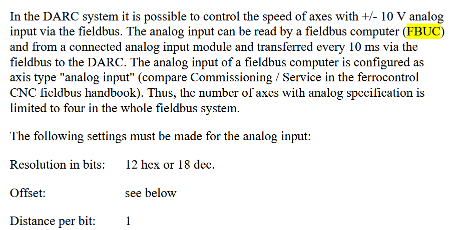

1) all 4 motors are AC 3 Phase, with integrated 2-pole resolvers
2)no short X-axis
3) newer DARC system (drives motors) (manual attached)
4) possibly different mesa configuration (6i24 7i49 for resolves feedback and - 10V of analog control signals for motors?)

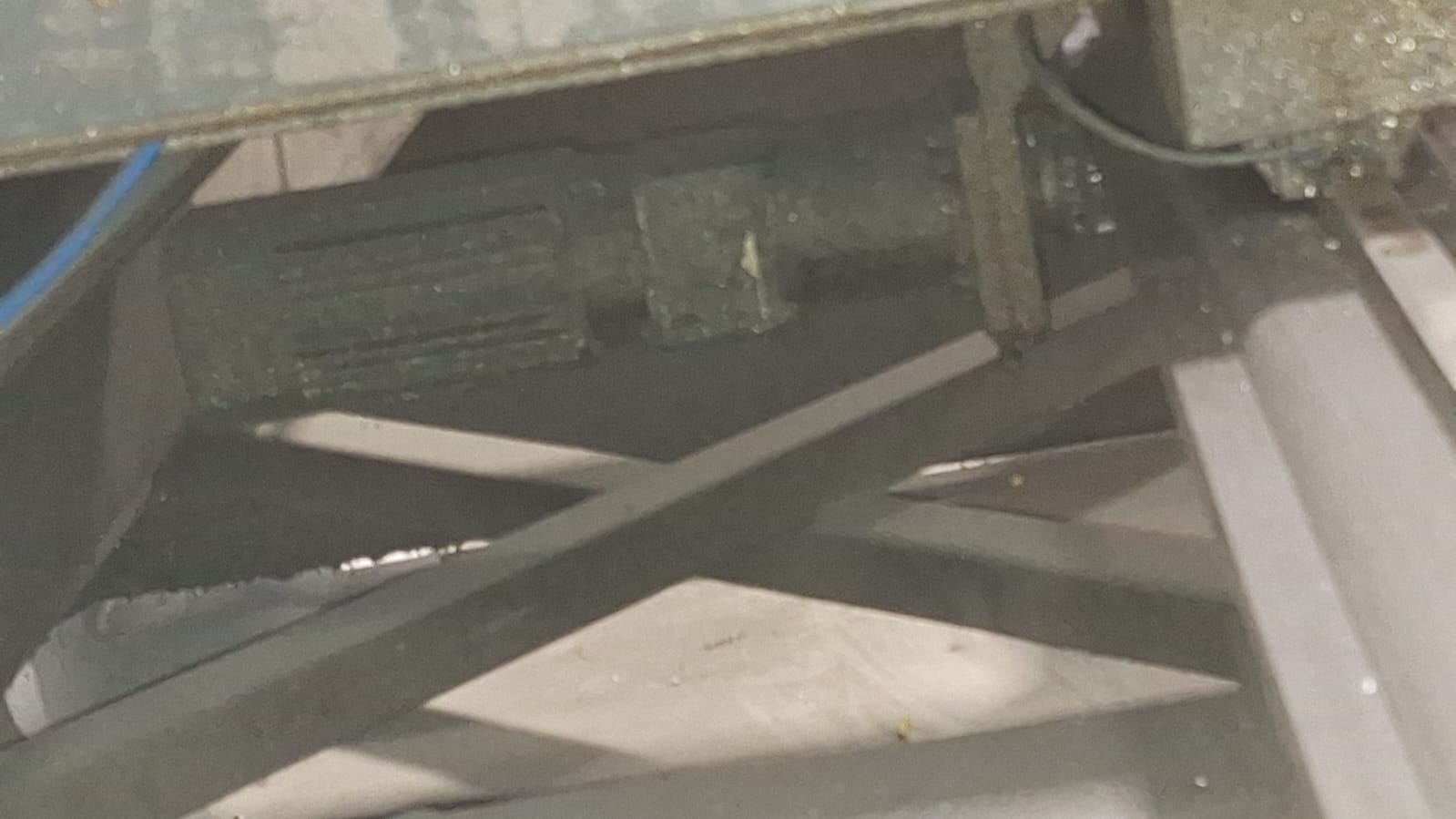

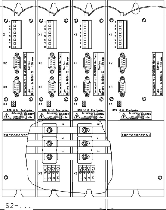

5) 2001 model
6) No pneumatic brakes are used for the x and y axis but we did notice some sort of pneumatic counterweight or brake for the z-axis (picture included)
7) In the picture you can see the 'DARC system' comprises of from right to left: supply module, that receives AC 380-415 3ph, then distributes through dc links (metal bars under the grey boxes) L+ L- PE to the other drives (spindle, x, y,z), diagram attached as well.
Attached is a picture I got online of the control panel with all the connections intact of the same machine 2001 model. The next picture shows the internal connection on the top side of the spindle motor. The next picture shows the cables for the resolvers found in the DARC manual. A picture of the whole machine in its current condition is also attached. A table containing info about the motors used is also attached. A diagram of the DC linkage is also attached that distributes power to all drives sharing and originating from the supply module, all drives also have inbuilt inverters to send 3 ph AC to their respective motors.
This is a link containing the DARC manual and the electrical schematics for the SBZ 130 - we.tl/t-zhbMsN1qWM

Hi, I'm
azim4411's
teammate working as an intern on the same project with him, we've realized that the choice of 7i49 would be apt for standalone resolvers, and have been advised that for AC servos with resolvers connected to the drives, it isnt suitable.
After further reading into the manuals, we have reason to believe there's resolver to digital converters in the drives for the resolvers, which produce absolute position and velocity outputs as "10-bit to 16-bit unsigned binary word and twos complement word respectively", I'm not entirely sure what that refers to, but this is as per a datasheet of general RDC's.
With this in mind + I confirmed the drives can be controlled via +-10V analog signals, what card combination can be used for feedback and control here?
- Posts: 4806
- Thank you received: 2163
25 Feb 2025 07:16 - 25 Feb 2025 07:25 #322561
Replied by Aciera on topic Elumatec SBZ 130/01 retrofit
Seems that these drives use a fieldbus interface which makes it pretty much impossible to use them in a LinuxCNC retrofit.

- Posts: 4806
25 Feb 2025 15:54 #322604
Well, I'm not in the position to tell you what you can or cannot do but your first problem is that you have to find out what kind of fieldbus is used. 'ferrocontrol CNC fieldbus' can mean anything. It might be CANOpen or something entirely proprietary. The only one that is reasonably well supported in LinuxCNC is EtherCAT which is not what your drivers use. I think there has been somebody here who got a CAN bus working through an EtherCAT interface.
In my opinion your best option is to get new drives and motors (preferably step/dir or if you feel like it Analog or EtherCAT). The costs of this can be calculated reasonably well and integration in LinuxCNC is well supported.
Everything else is certain to involve a massive amoint of time that is quite likely to lead you nowhere.
