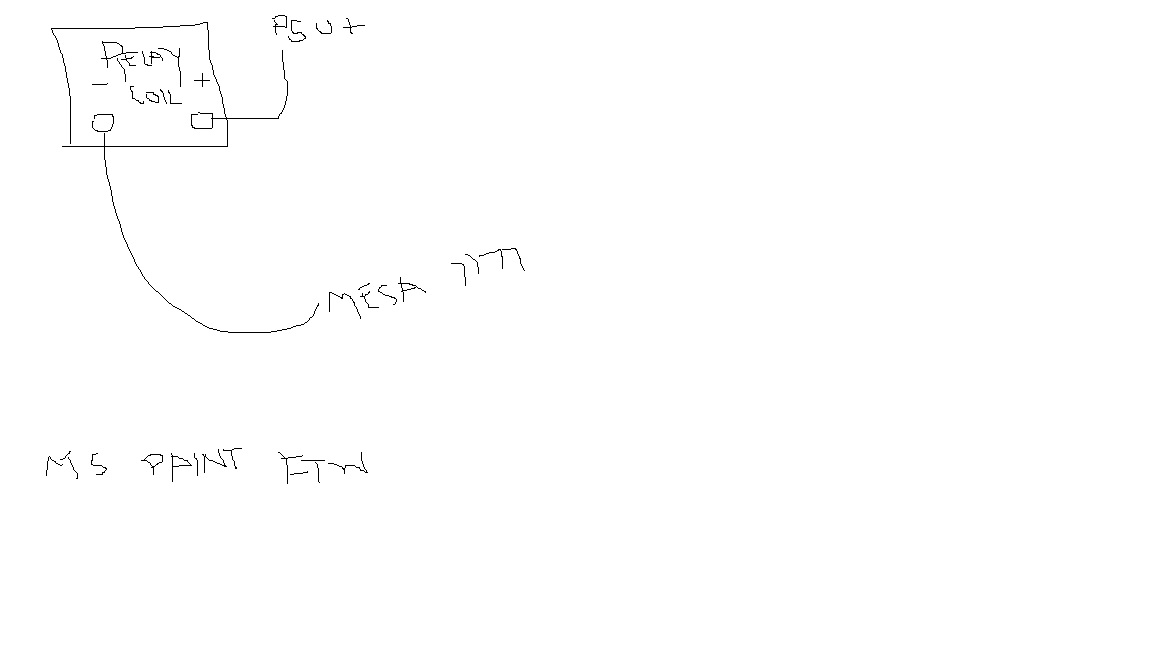

that ebay relay does the same thing as mine! haha. all the inputs to ground.

No, it has a set of switch-to-ground outputs and 24V positive voltage inputs.
No, that's wrong. Sorry.
I think I have seen positive-voltage input versions.
Replied by andypugh on topic Brother TC-225 / TC-229 adventure!
Last edit: 02 Aug 2017 13:52 by andypugh.

sure doesnt look like it, in any case, its wired identically to what I have already.

heres a nice drawing of what I have now
Actually... This is a job for the ULN2003, and those are cheap. (25p)
docs-europe.electrocomponents.com/webdoc...0900766b8135f9fb.pdf

Replied by ihavenofish on topic Brother TC-225 / TC-229 adventure!
that interesting. but I'm slightly confused (as always haha)
so, on one of those, id connect "IN1" to the mesa output. "GND" to the mesa field ground. "OUT1" to the minus terminal of the relay, and then common to the 24 ground of the machine (also the same 24 ground that's connected to field io on the mesa)
that's seems... right? looking at the diodes in their block diagram anyway.
with 7 channels, I could basically patch this into my cable and shrink wrap it. and add one or 2 more as needed for other relays in future.
also 75 cents at mouser with next day delivery. woo.
