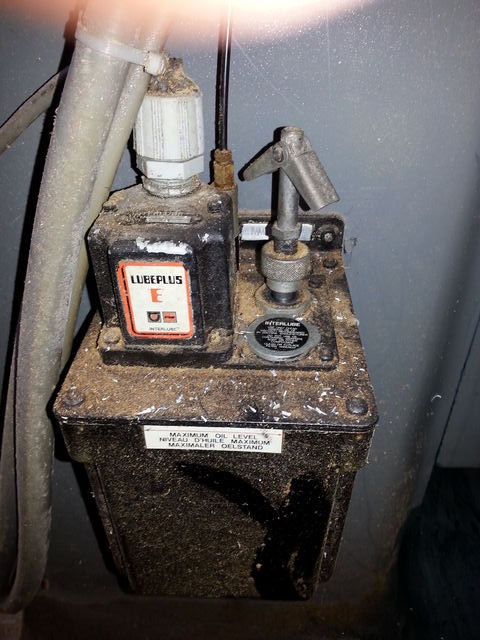

J1900 should be a good motherboard.
Any output can be connected to the auto oiler. Depending on the oiler type you might need a little classicladder to cycle the oiler.

I'm glad it powered up! What type of oiler do you have? I put a 110v bijur on mine but it's timer is a bit fast and shoots oil every 20 min. My machine is dripping in way oil. Not so bad when things are moving but wasteful when idling. I have it set on the wrong pin. Been to lazy to fix it. I need to link it to motion of sorts instead of having it come on when the machine is enabled.

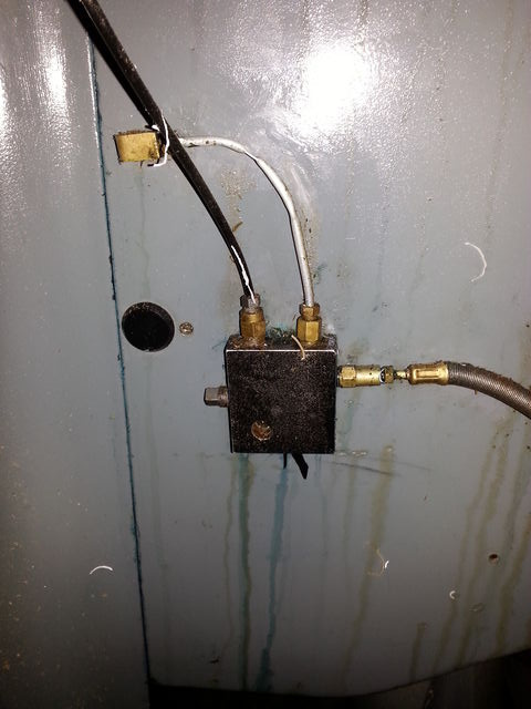

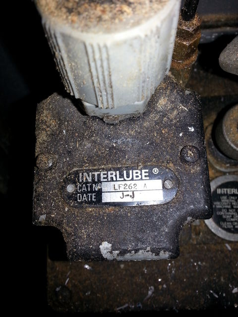

Well I got back to the garage today and got some shots of the oiler. Its a Interlube that came with the machine and after some initial problems its been working well. I had to clean the lines and replace some of the tubing, Was a tough time finding the right size of tubing anywhere around here. I used some epoxy to glue a home made patch into the line in one place and have had to squeeze the tubing down to slow all the oil coming out at the column.
Is there a way to include the pictures but as thumbnails?
Jim
model number
the rod with the butterfly on it is a manual squirt
the distribution block
Jim
model number

24 May 2018 15:26 #111087
Replied by andypugh on topic 2nd stage of Crusader II retrofit
Stylish bodge, that wall anchor

I have no problem with you copying my hal and ini or using it as a template. I just want you to get this thing up and running:)
I assume your pump uses resistance/metering fittings like the bijur. It should not just pour out of one area. I see the crimp took care of that. Possibly clogged metering units elsewhere?
