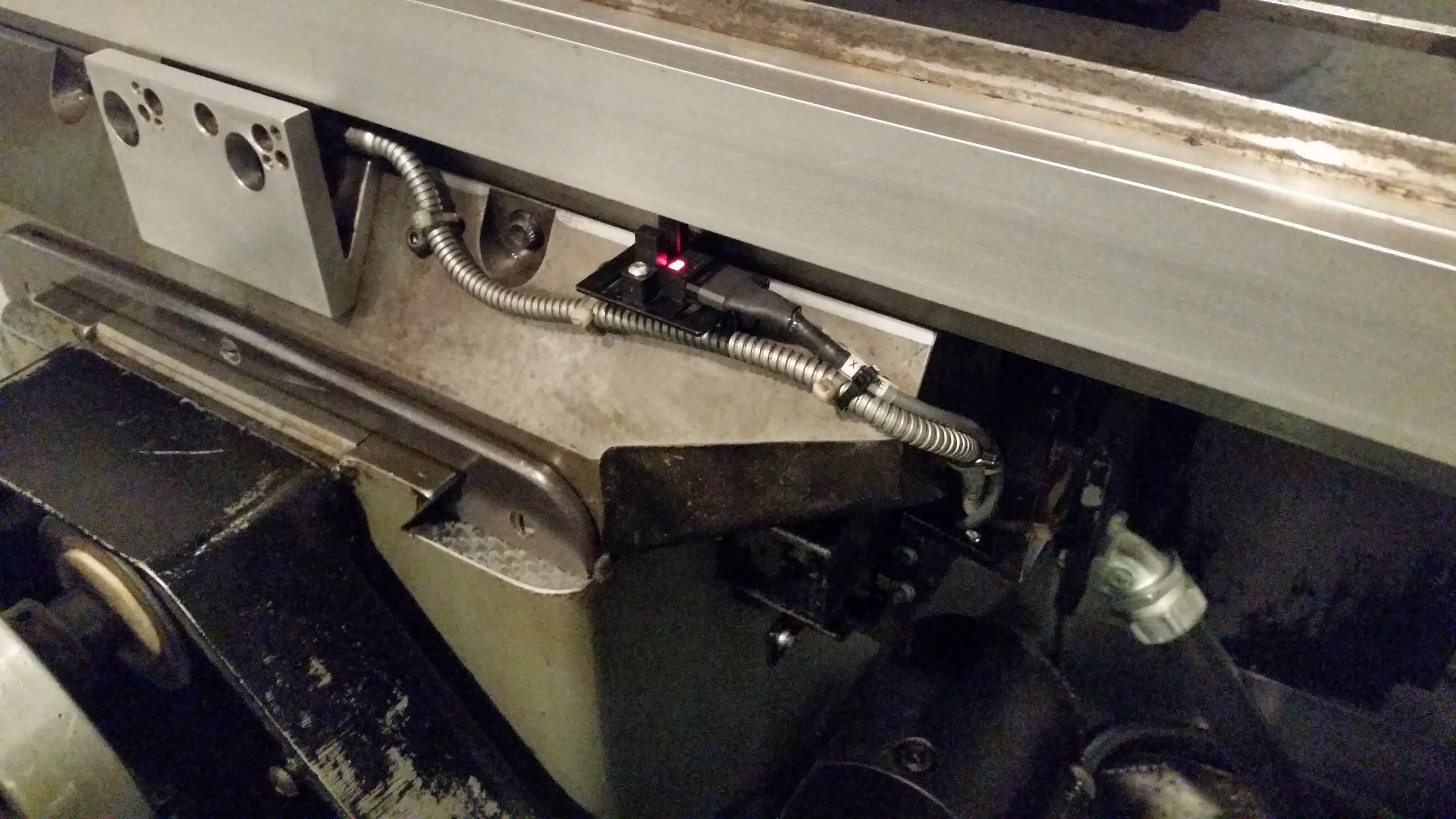

Also, I think it's it's careless to run a machine like this without home switches. I highly recommend adding some optical switches and configuring the ini so that you have the software travel limits set inside the limit switches.
I found some notes on the optical units I bought. EE-SX670 P PNP type I believe is needed to work directly with the 7i77. You may want to confirm with PCW.
