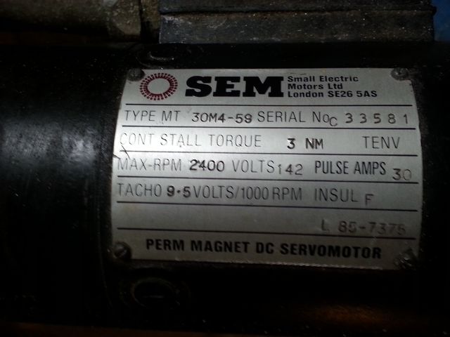

I swapped out the X for the Y westamp boards and the problem remained with Y axis. "servo power is not enabled" the servo power is turned on for all axis at once when the enable (start) button on linuxcnc is pressed (F2 button). So I assume that the problem is the SEM servo motor or the wiring to it.
I have removed the Y axis hand wheel and belt cover and the toothed belt is still in place.
thanks
Jim
Below is a picture of the SEM drive motor
thanks
Jim
Last edit: 10 Jul 2018 19:22 by jamby. Reason: added picture

Okay good, so the axis drive card is still working. I would check the wiring inside the conduit. From the box on the motor back through the connector under the power box. Also inspect the connector/fitting as that can get pulled when the knee travels up. If it's not the wiring, inspect the brushes? The inner ones are the motor brushes and the outer are the tacho brushes. Tackle one thing at a time so not to open a can of worms...

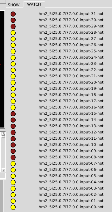

I was able to sneak out to the shop and run a flying lead check of the input pins. I set a watch on all the input-not pins and used a 24 vdc lead to touch each of the screws on top of the pins. All lights on the watch list changed between red? and yellow or vice-versa except the 8-15 pins they didn't change I also set a watch on the other choice "input" and there was no change to them either.
The screen shot below shows the state of the watch before testing.
Jim
Jim
- Posts: 18111
- Thank you received: 5330
13 Jul 2018 02:57 #114102
Replied by PCW on topic 2nd stage of Crusader II retrofit
I would test by removing the connectors and touch the pins
The screw may not connect to the input unless the screw is tightened and
its also possible that a connector is bad (not common but does happen)
