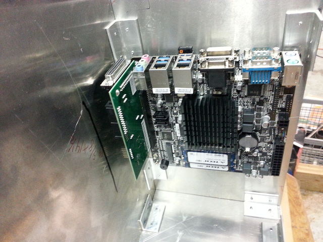

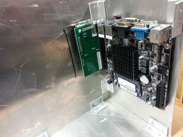

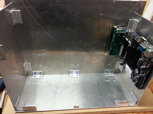

23 Jun 2018 21:08 #112804 by jamby
Replied by jamby on topic 2nd stage of Crusader II retrofit
Hey
I am still working on this. Grandkids graduation and a few other things got in the way and now I am agonizing over whether to mount the mother board as you see it in the pictures, or mount it to the back of the box. It has 3/8 of an inch clearance now but I would never be able to connect to the second connection on the 5i25 in this position (as in possible 4th axis) but mounting to the back squeezes the 7i77 and connections. Ummmm.
Jim
