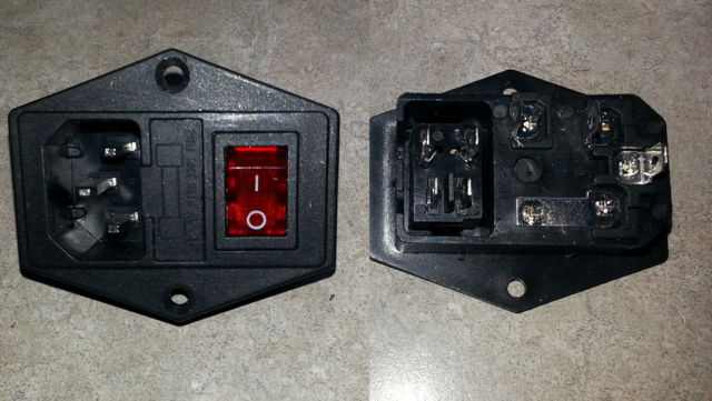

Hey
I am looking ahead at how to bring in the A/C power. I have the plug in the picture below and it has three blades on the back (kind of hard to see in the picture), one for ground, one for base, and the load passing thru the fuse. Then there are four more blades attached to the rocker switch, two on each end.
Guessing that:
Ground == stick a bolt in the aluminium case and connect all the ground lines to it.
Base & Load == connect to all the power supplies and the out going plug (leads to the monitor)
Planning on running everything thru the fuse and only turn the rocker off when I want everything off. There's a momentary switch on the panel to start the PC, another power switch, latching, for the 7i77 D/C power supplies which will be shut down any time its going into hibernation (when its not being used for weeks at a time). I don't know what to do with the mother board power supply as all the desktops in the house have power to there power supplies 24/7.
As always, hope this makes some sense.
Jim

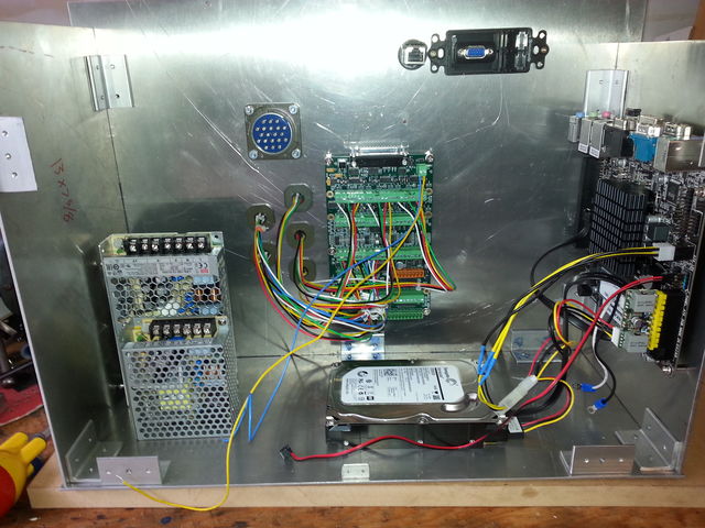

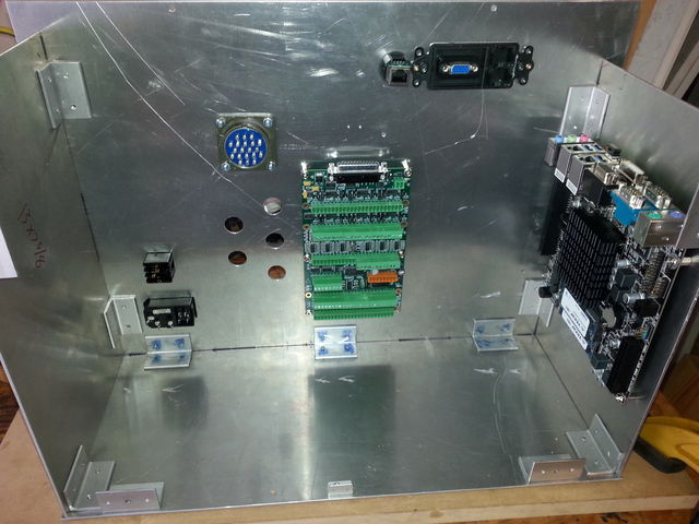

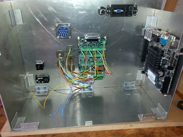

Well I am getting closer. Most of the machining is done except for some drilling and tapping of brackets so its time to do a test fit and try controlling the machine. If everything goes well then its wire up the power supplies and try to figure out how to wire in all the switches.
Some pictures of the progress.
