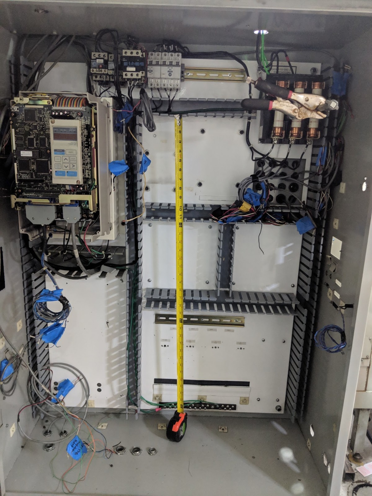

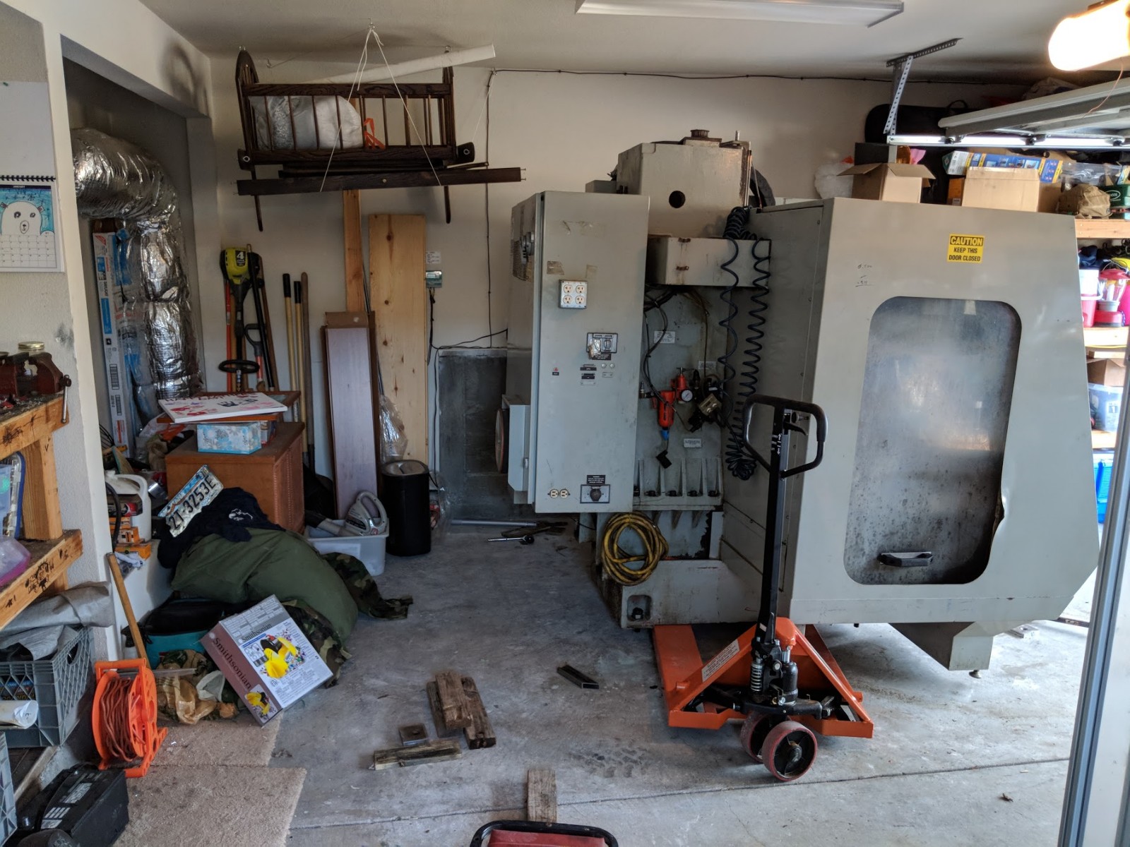

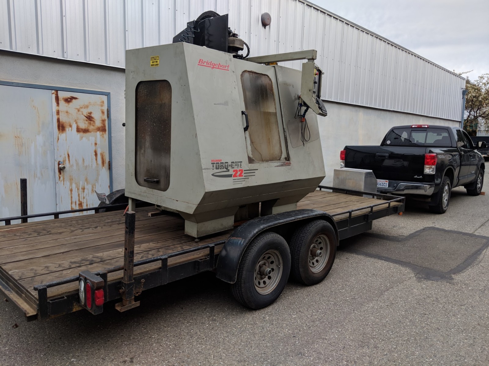

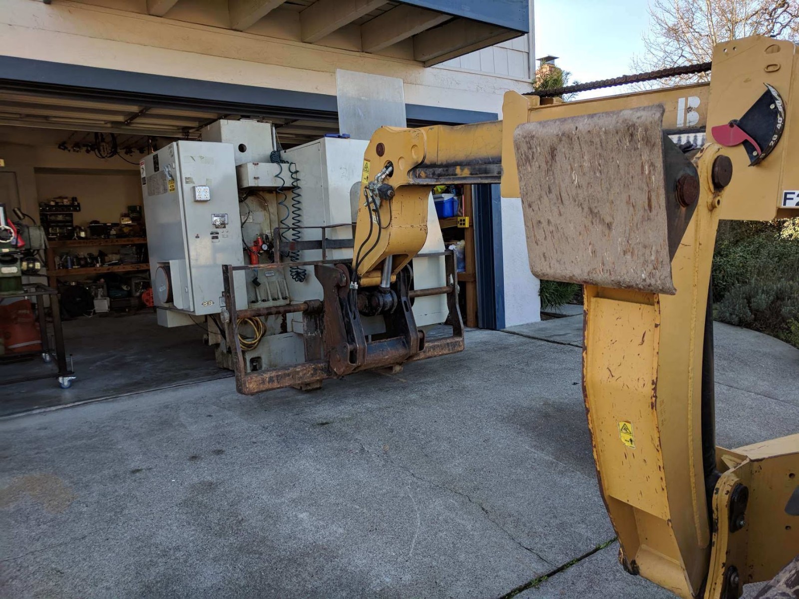

11 Nov 2019 23:40 #150171
by Michael
Sure do. Here it is in various stages of tear down and rebuild.
Replied by Michael on topic Bridgeport Torq Cut 22 Retrofit
Any pictures of the beast?
