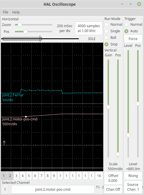

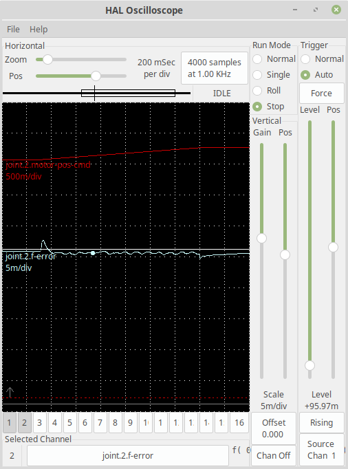

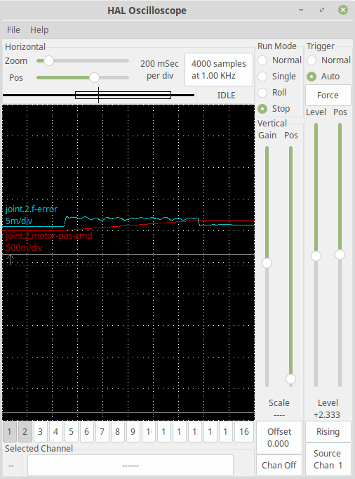

13 Dec 2020 19:16 - 13 Dec 2020 19:24 #191890
by Michael
Replied by Michael on topic Bridgeport Torq Cut 22 Retrofit
Here are some scopes after tuning the servo drive. DMM was very helpful and agreed that the autotune for my setup was way off. I was able to get ride of the visible noticeable oscillation when jogging. Here are the effects FF1 had at 9 IPM. As I increase jog rate the graphs move more from baseline.
P25 FF1=.9
P25 FF1=1
P25 FF1=1.1
P25 FF1=1.96
P25 FF1=.9
P25 FF1=1
P25 FF1=1.1
P25 FF1=1.96
Last edit: 13 Dec 2020 19:24 by Michael.
- Posts: 18109
- Thank you received: 5329
13 Dec 2020 19:21 #191891
Replied by PCW on topic Bridgeport Torq Cut 22 Retrofit
FF1 should be adjusted so the the ferror is close to 0 when moving at a constant speed.
too much FF1 will cause the actual motion to lead the command, too little will cause the
actual motion to lag the command.
- Michael
- Posts: 335
- Thank you received: 59
13 Dec 2020 19:36 #191895
by Michael
So of my posted pictures which one seems to be closest to where I should be? I honestly don't see much change until something dramatic is entered as in my last picture. But at that setting and higher jog rates it is way off.
- Posts: 18109
13 Dec 2020 19:43 - 13 Dec 2020 19:44 #191897
1.96 is the best
I would set FF1 at say 1/2 of full speed
It should scale(should be independent of velocity)
The error from an incorrect FF1 setting will be
proportional to velocity so its best to tune FF1 at
a fairly high speed
a fairly high speed
Last edit: 13 Dec 2020 19:44 by PCW.

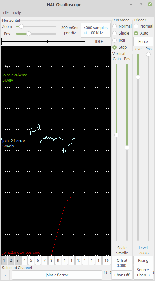

- Michael
- Posts: 335

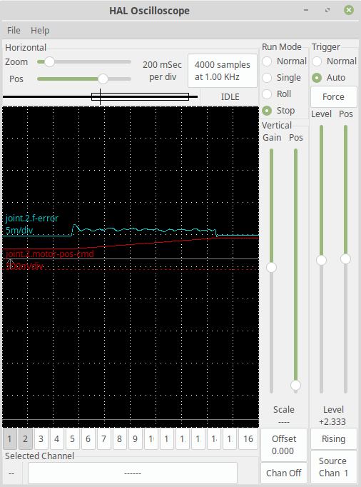

14 Dec 2020 19:54 #191974
by Michael
- Posts: 18109
14 Dec 2020 20:07 #191975
You should be able to tune some of that error out with a bit of FF2
But it may also reflect non-optimal tuning in the drive itself
