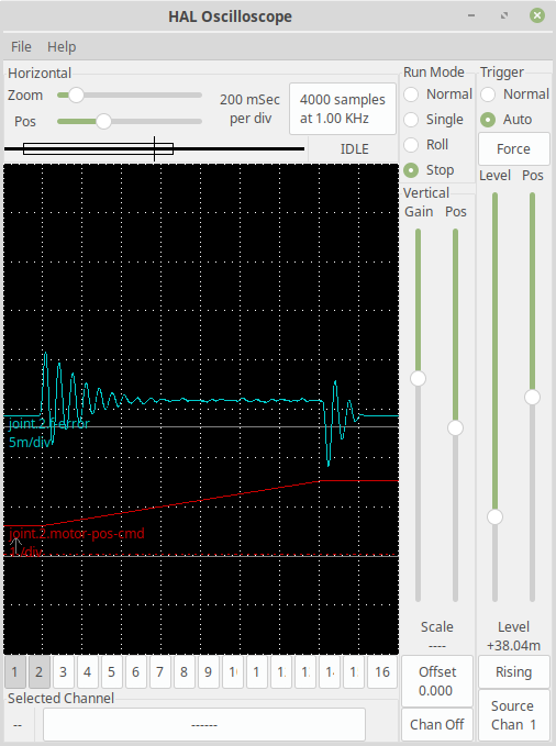

I messed around all day with different settings in the drive and finally found that if I moved the drive acceleration way up they worked fine and smooth, responding to the controllers PID. I had not messed with the accel setting because the manual said it resets to 12 at power off. Fortunately the setting would save higher than 12 and I was able to start tuning.

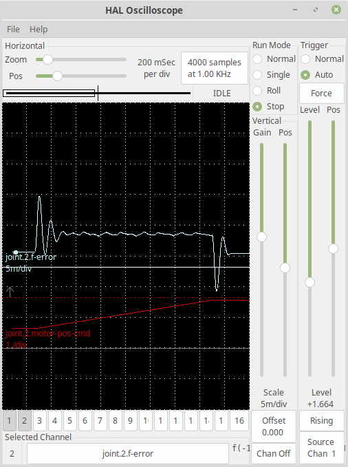

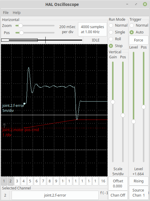

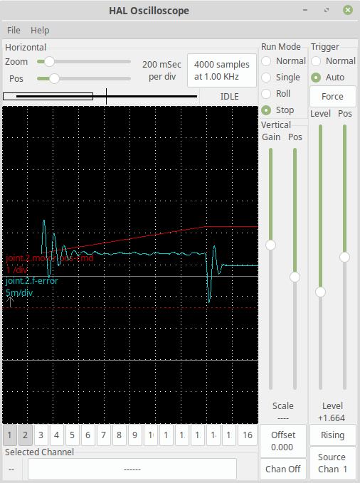

I put everything to zero and moved the P up. In earlier testing (pre finding out the accel issue) I was able to move P up until I got a visible bounce and then back it off. Now I have been able to get P well past that original setting and I believe what I am seeing is a very small oscillation before the axis comes to a stop. Here are some pictures of the HAL scope at P100, 200, 300, 400 I think around P170 I get the single over shoot when I stop. Trying to make sense of it all.

Your tuning looks like you have not set FF1 correctly (constant error at cruise)
and perhaps have faster acceleration than your drives can handle.

FF1 is set at 1 per what I read if the output scale is set to IPS
My output scale on this axis is 9.84 (-output, -min, max). My acceleration was set to whatever came up in pncconf. I believe it is 30in/sec2.
I was having a lot of issues with the axis drive after auto tune and messing with the parameters to try and get smooth motion. I was able to get a decent tune that stayed within f error=1 up to 300 ipm but not higher than that. Settings were around P450 FF1=1 FF2=.045
This being my first machine with rapids this high, after seeing that much mass move that fast I am rethinking the wisdom of it all.
Also I originally was adjusting P by jogging at 4ipm and moved up to 40ipm for the hal scope pictured. Any suggestions on speeds to sue for tuning?
09 Dec 2020 22:15 #191553 by PCW
Replied by PCW on topic Bridgeport Torq Cut 22 Retrofit
Its clear the FF1 is not correct so that should be tuned first
(FF1 = 1.0 only works if the output scale is exactly right)
You should be able to null the error at a constant velocity
by adjusting FF1

Should I be adjusting P with FF1=0 and then work on FF1 once I get P in range? No amount of P or FF1 adjustment seems to make that cruise wobble go away. I honestly think the servo drive tuning is amiss.
