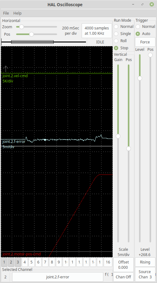

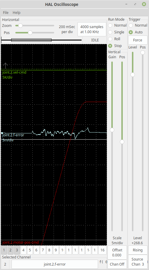

I can basically get rid of the spikes with a bit of FF2= .003 but that makes the cruise a bit more unstable. When looking at halscope and the gain scale is set to 5m/div what is that value representative of?
Pretty close to throwing in the towel on these servos. I could not find any posts where someone successfully set them in velocity mode. Almost all of the info out there for them is when used in position mode.

Here is where I am at now. I would love to know what the graduations on the ferror gain are? Currently been reading at 5m/div, no idea if this is good, just copied off the pictures I saw. I have a decent looking line with a bit of over/under at both ends. If I go up too much with FF2 then I actually move it to an undershoot at the beginning and over at the end. I am guessing there is a happy medium in there somewhere. The FF2 testing is being done at 135IPM to avoid the over voltage issue. Any thoughts?
P65 FF1= 1.0215 FF2= .0047 at 135IPM
P65 FF1= 1.0215 FF2= .0047 at 292IPM

The error in the plots is in machine units so with imperial units, the scale is .005"
per division.
per division.
A division being the dots or each box on the scope?
per division.
A division is one square on the grid , (a dot is 1/10 of a division)

That's good to hear then. With 5m/div and half rapid speed my following is less than .005" and gets better at more practical cutting speeds.
Any reason why when I try and jog in .0001" increments that a change of direction takes around 20 button pushes before the axis moves in the opposite direction. It's not backlash, movement of the encoder doesn't happen. Product of the axis not being dialed in all the way?
What speeds should FF2 be dialed in at?
Last edit: 14 Dec 2020 20:45 by Michael.

Replied by PCW on topic Bridgeport Torq Cut 22 Retrofit
I get the impression that the servos velocity loop gain is not very high
Have you set it as high as possible?
Also make sure you dont have any filtering enabled in the drive
as that will prevent setting linuxCNCs P term as high as possible
so as to minimize following error.
The larger the velocity, the longer the accel/decell times so I
would use the highest velocity for tuning FF2 as the
pedestal will be more clearly separated from other
errors.
