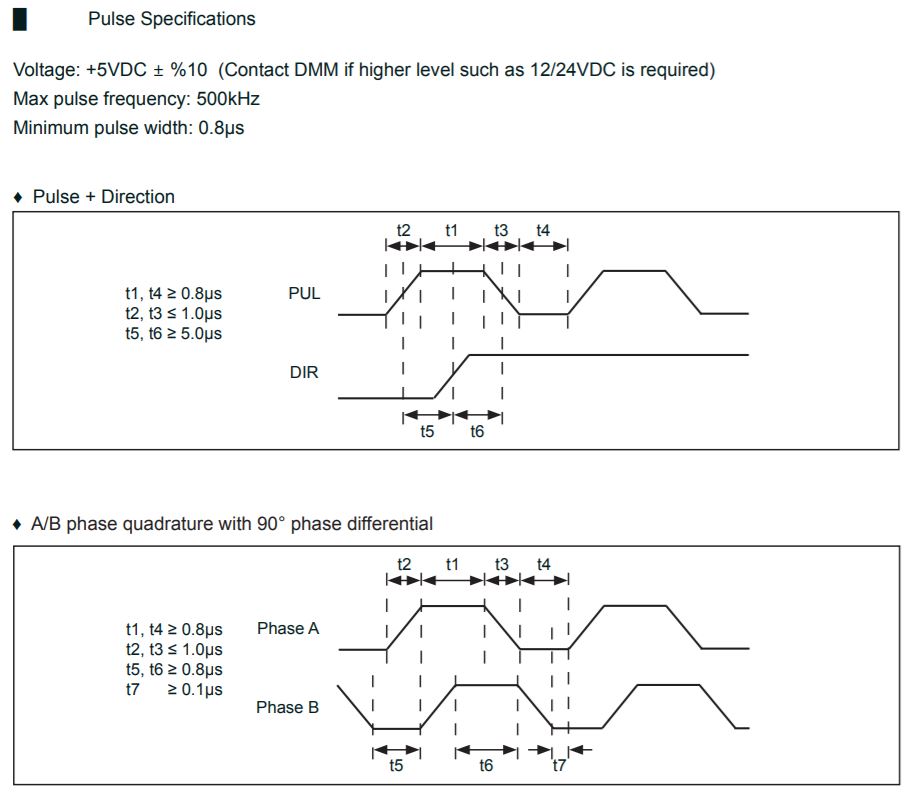

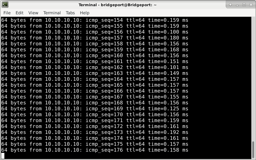

After dealing with the DMM servo issues of overcurrent at speed and delayed response in encoder feedback while in analog speed mode I have decided to take the project a different direction. I ordered a 7i78 to go along with the 7i92, 7i77 and 7i84. I have also installed the standard ISO Debian 10 Buster with 2.8. I will be reflashing the 7i92 with a different bit file later today to match configuration change. This is probably not the most ideal combo but it was affordable and I need to get the machine moving along. Once I clear the back log of work I will probably source some Yaskawa Sigma 5's and go back to analog control.
I would like to go over the math of the pulse settings to make sure I am in the right ball park.
Going over step/direction signal timing in the manual I have this page:
Max motor speed is 3000 rpm which makes it 50rps
Max pulse cycles read to be 500kHz which gives me 10000 us per revolution for pulses.
minimum pulse width is .8 us so it looks like to get max motor speed I would need 12500 pulses per revolution to achieve that.
The drive gearing can produce anywhere from 2000 to 65536 pulses per revolution.
Resolution wise this provides me with .000015ish" per pulse X/Y and .000009ish" in Z (geared 40 to 24 and 8mm and 5mm screws respectively)
Any thoughts on the math and the adequacy of the resolution? I probably wont be trying for full speed but closer to 90%.
