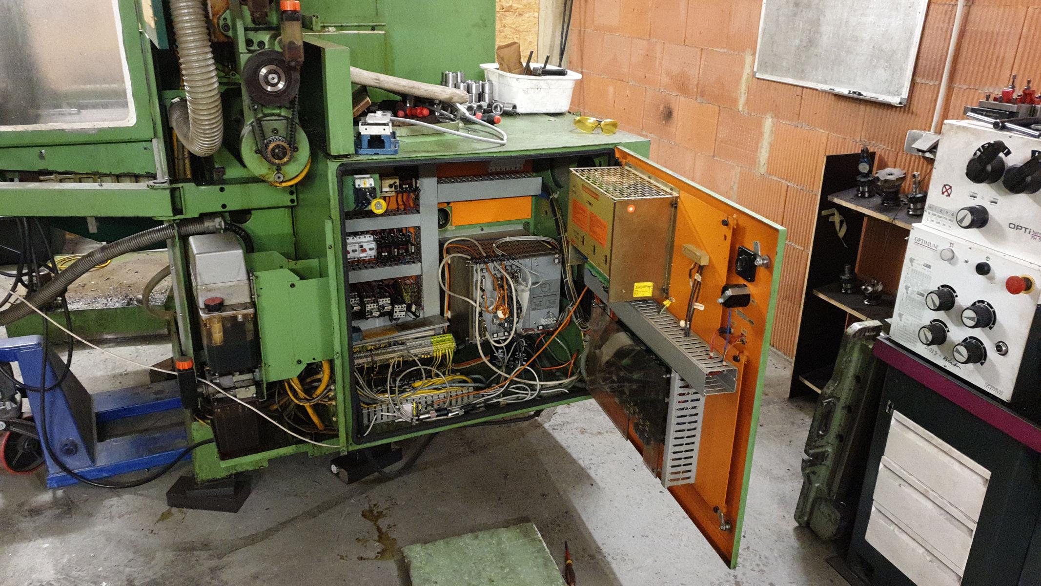

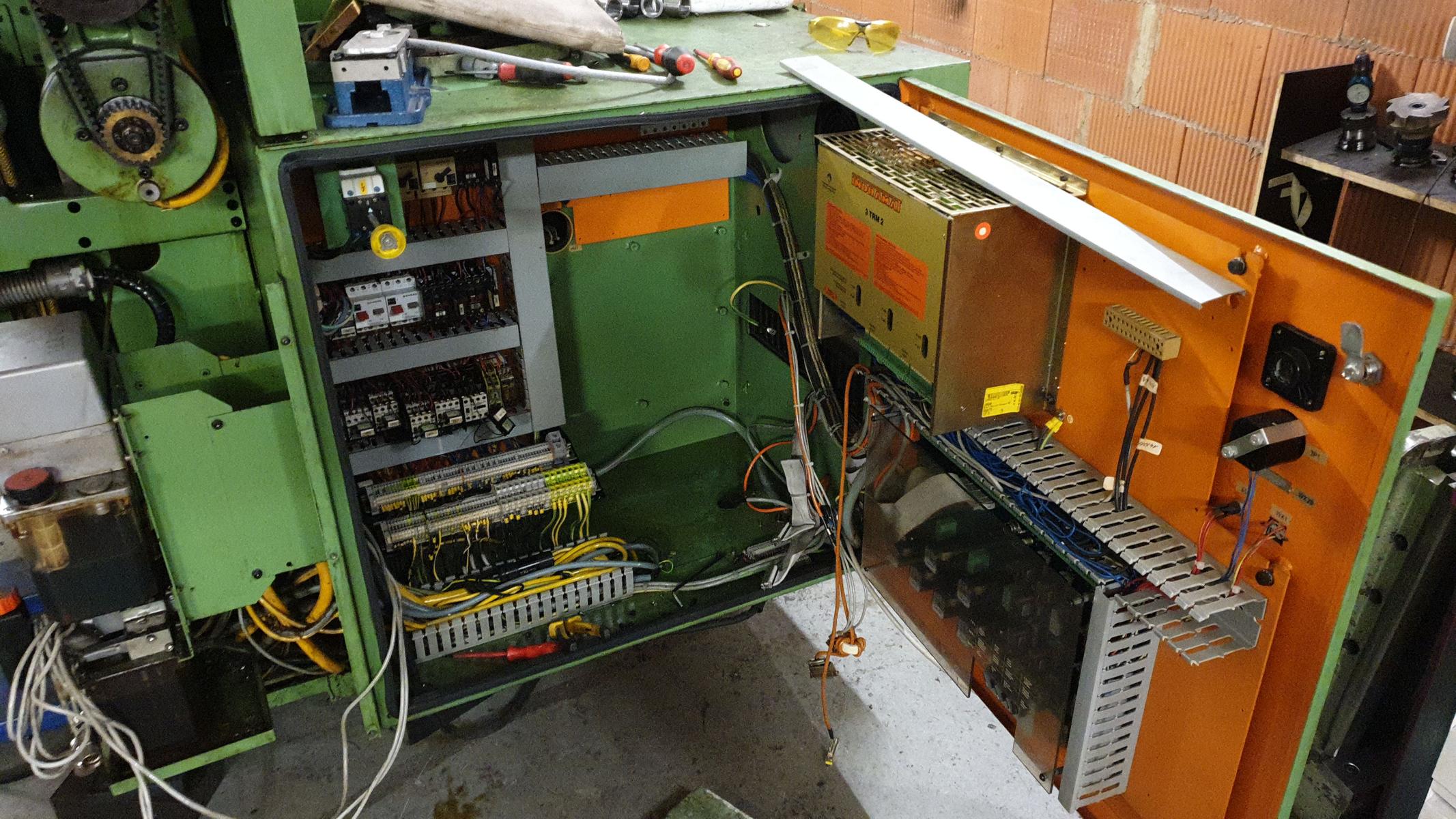

Now that i´ve finally got the 7i77 running to a point where i can sense inputs and set outputs I´ve went on to the cabinet on the Maho.
The first task was to pull the heavy thing out of it´s corner in my shop. I mean it´s not that heavy, but very uncomfortable to move.
With the blue pallet jack you can lift the machine quite good when you attack it from the controlmonitor side.
So i´ve pulled the machine away from the walls so i can open the cabinet door all the way.
I´ve started with unplugging all cables from the "PC" and I´ve tried to see to what part they are connected.

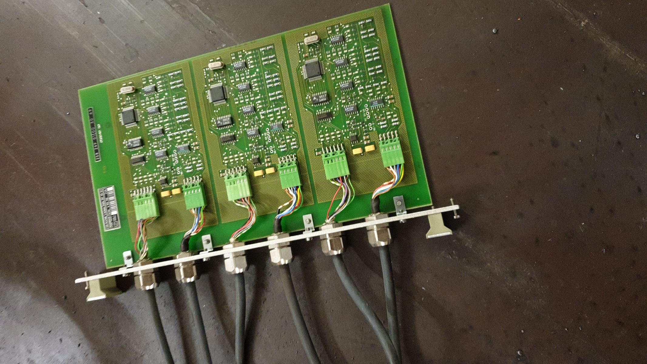

The 3 Glasscales are easy to find and I´ve tucked the three cables to the side for later inspection. From the rotary Thread i´ve read that you can use the old EXE board for TTL signals, so this board got safed at first.
I´ve unplugged the ribbon cables that are connected to the relais board and will check how RotarySMP salvaged this.
On the very botto right corner of the cabinet is some weird terminal block, that connect the Maho MPG, the "PC" and the relais board. I´ve left that untouched because i´m not sure if i could reuse that thingy.
So far the main PC is out of the machine and my next tasks are to check alle the relais and their function according to the e-plan and check how to interface the relais board and the TRM 2
I found these chips recently, but I have not had a change to try them yet...
sine/cosine converters with selectable interpolation.
de-shop.ichaus.com/encoder-circuits/inte...ion-sine-to-digital/

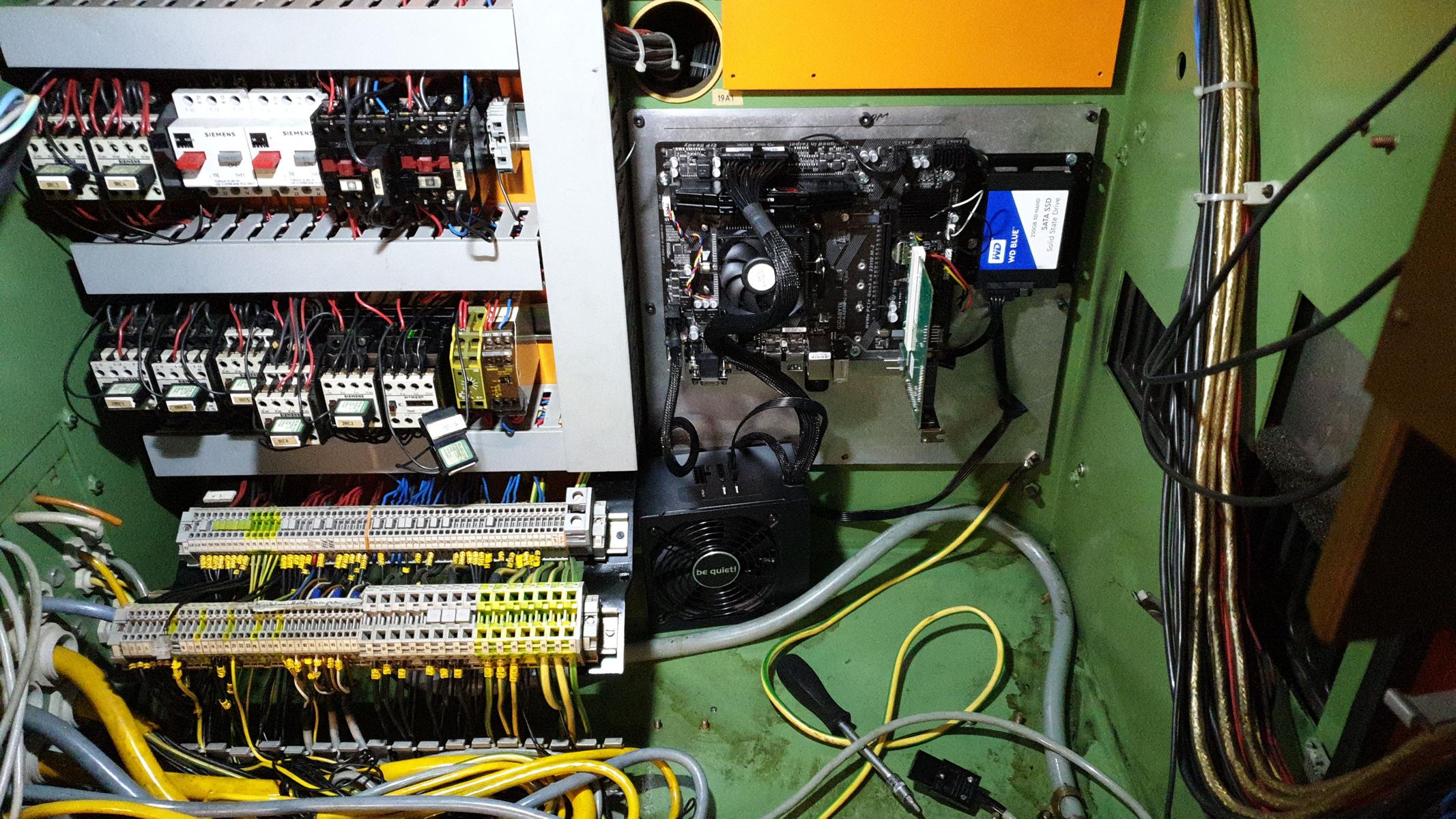

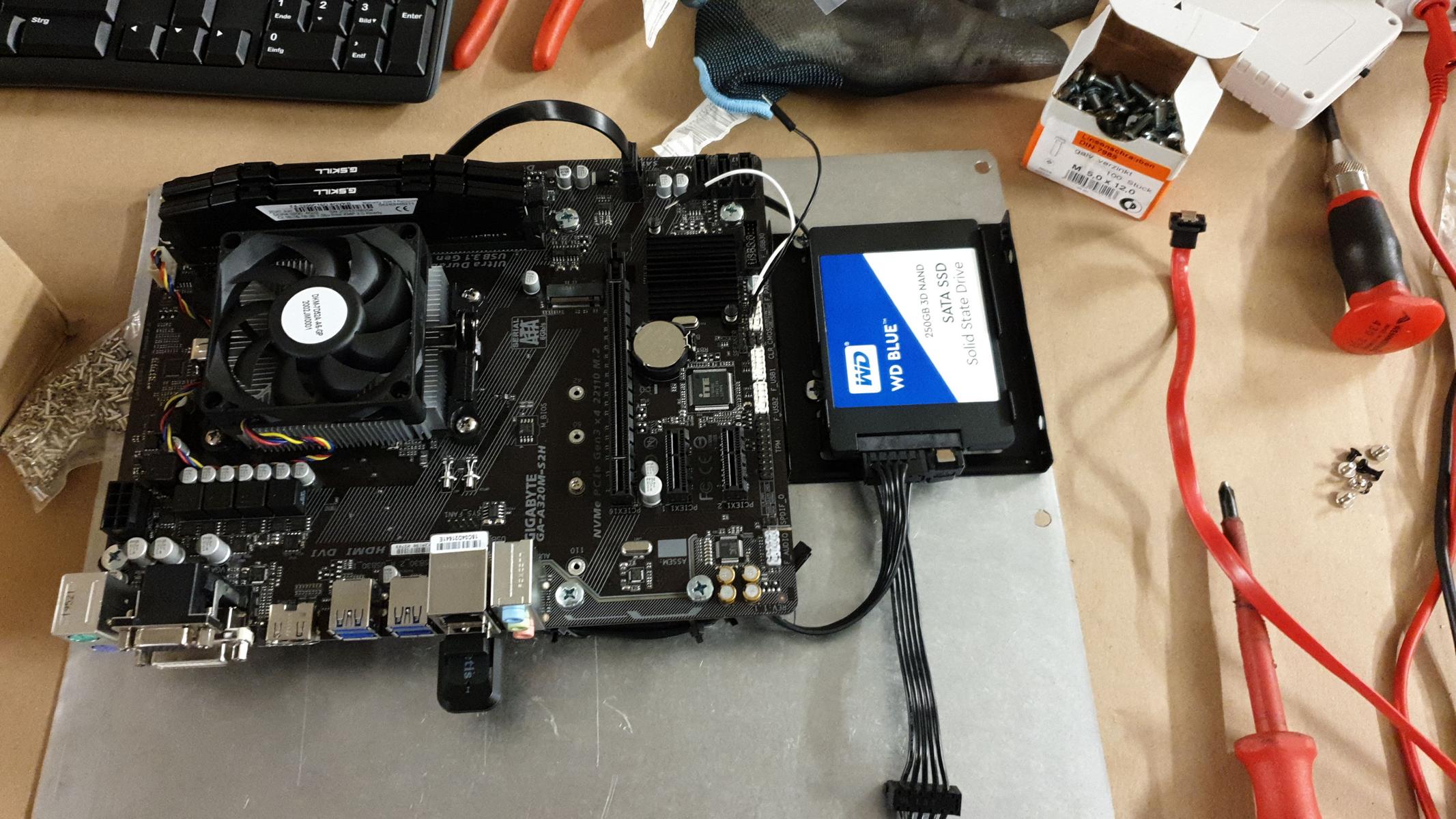

So i´ve mounted the PC inside the cabinet and removed the old control.
Next i´ve started to analyze the relais board but unfortunaly the shematic i wanted to use are not even close to the board i have.
So yesterday and today i´ve measured across the board to check wich pin drives wich relai but thats no fun at all.
Soooo long way. My expansion card 7i84 came today with dhl express. Gonna use it for the gearing.

@opw nah, rather use the already built stuff
