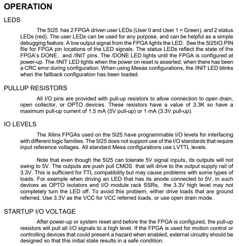

A flashing red light on the 5I25 card means that the PCs 3.3V power is marginal
(dropping below 3.1V so resetting the 5I25)

Is there a way to power the 5i25 from an external source but the PCI slot ?
EDIT2:
"startup I/O Voltage"
does that happen when you start the computer or LinuxCNC ?
Could explain the restarts when starting linuxcnc ?

Not really, the 5I25 is only reset by a low 3.3V rail from the PC power supply
