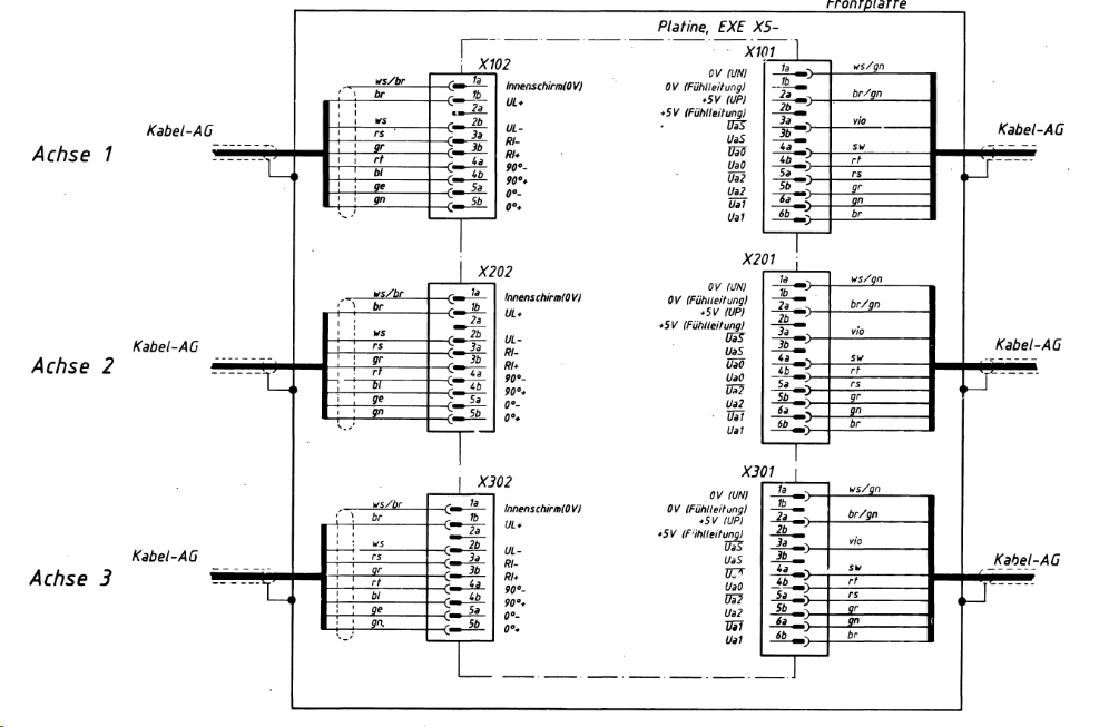

Oh, and the EXE wiring was the only original diagram in my set which was wrong from MAHO.
I now have two like this...

Okay,
there is no way to use the old Exe board ?
I´ve made new cables with fitting crimp connectors that go inside the old green pin connectors. But there are like 8 cables each.
I have no lcue what Ua1 and Ua0 means. And do i need to power them up ? with how much Voltage ? 5v ? 12v ?

Today´s update:
Got the Heidenhain linear scales/encoders working.
The pinout was quite easy with the shematics from HH. The guy on the phone just needed the serial number which is printed on the board.
The 7i77 manual even tells you how to wire the encoders.
The 7i77 asks for QA0 AN QB0
I´ve wired up like this
I couldn´t get the EXE Index signal to work. i´m not even sure how to wire it. I´ve got 3 cables left. UaS looks to me like it should be the index thing, but when i handwheel the Y-Axis over the index position the signal won´t trigger. I´not sure if i can even see it in HAL view.
Next i´ve noticed a strange behavior when i connected all three scales to the 7i77, that the computer randomly restarts, sometimes only when i move one axis. I then added my lab power supply to power the 7i77 5v into TB1. Jumpers are set to seperate vin and vfield.
Same behavior. The pc won´t restart when i power everything up first, and then start the pc at the very end. Not sure if this is a solution or not. I´m not sure if i´m missing something there.

So it´s ok, but not the solution LinuxCNC intented to. Maybe i´ll change this later.
I´ve got that far that i wired all glasscales today and got them working. If anyone is interested, I´ve talked to Haidenhein again because we couldn´t find a way to use the "index/home" signal from the scales,. After wiring everything up i had 3 cables left.
UaS, Ua0 and /Ua0.
I tought that Ua0 and /Ua0 are the index signal, but it never triggered in Hal view.
I´ve turned the Y axis (z axis on old maho) per hand very very slow. It took 5 Minutes for like 5mm.
No Signal.
Then i´ve phoned Heidenhain and they confirmed Ua0 and /Ua0 as Index line.
So as i knew the location where the index should be (+-10mm) we hooked an oscilloscope from ebay to Ua0 and /Ua0. The Heidenhain guy said that the trigger should produce a spike somewhere between 0,7V and 1,3V.
So I´ve monitored the rawcounts of the encoder and turned the axis very very very very slow. Like 1-3 increments/second.
So i´ve moved the axis like 6 times forth and back until my buddy screamed the signal just died and came back.
So the index signal is 0,001mm "wide". The oscilloscope was set to like 5 seconds to even see the voltage spike when overrunning it.
After that I tried again to PID tune the axis but it was quite strange behavior. Jumping and jiggling and all crazy behavior and instand estop because of following errors.
So I´ve checked the encoderscaling again, that was off but did not help that much. The problem was "outputscale". I´ve been to lazy to check what that means. But on the Maho drives it should be set to 100 and not 1.
So after that i could drive the axis quite good. I almost cried because they sounded smoother than the when the Maho controller drove it.
For sure after some distance the following error came up and i think i´ll study some halscope tutorials
But when i drive slower than 500mm/min it´s "okay".
