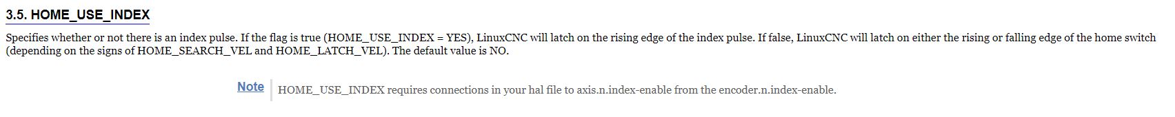

The Linux cnc homing setup is very strange but i got it working with the index. The connection in the Hal file was missing.
